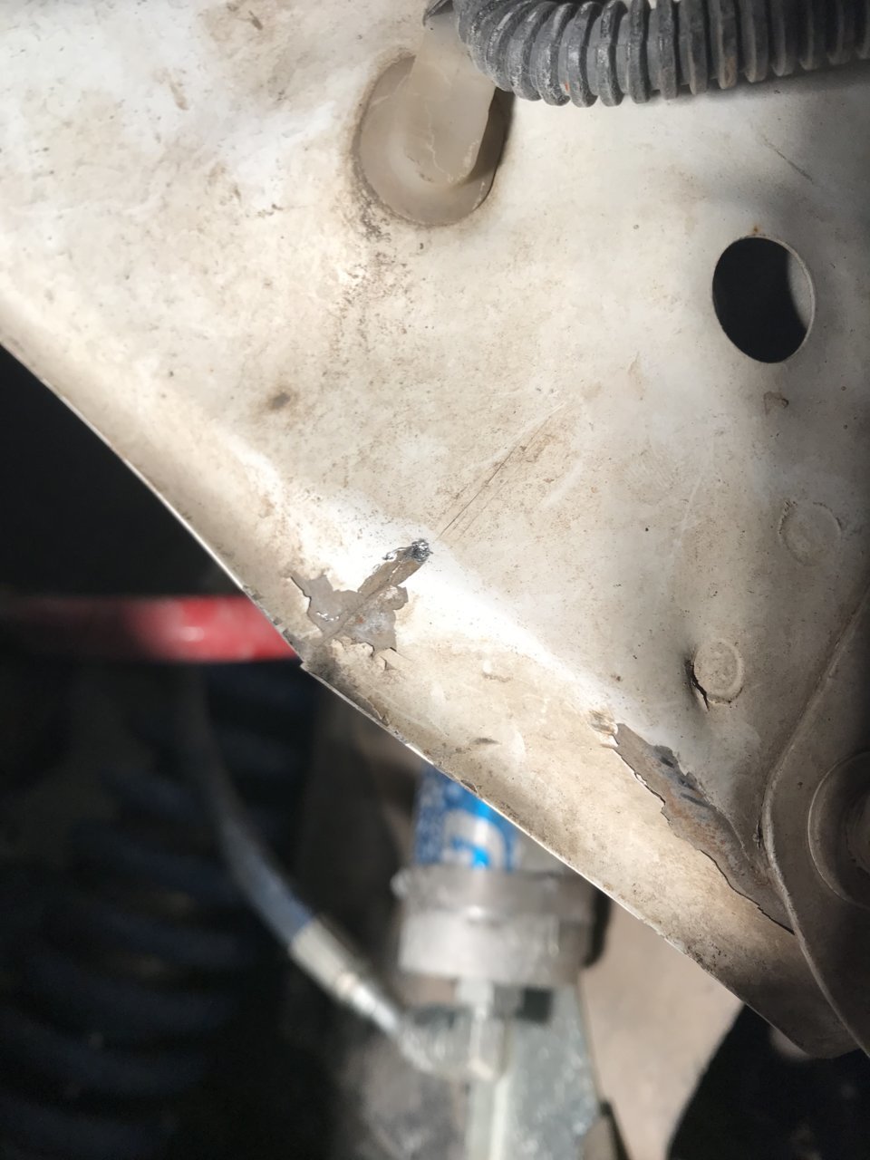

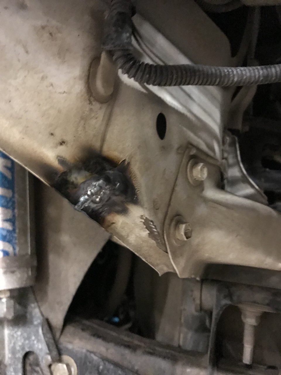

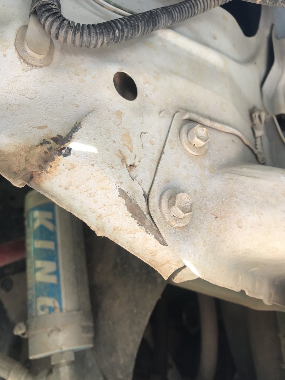

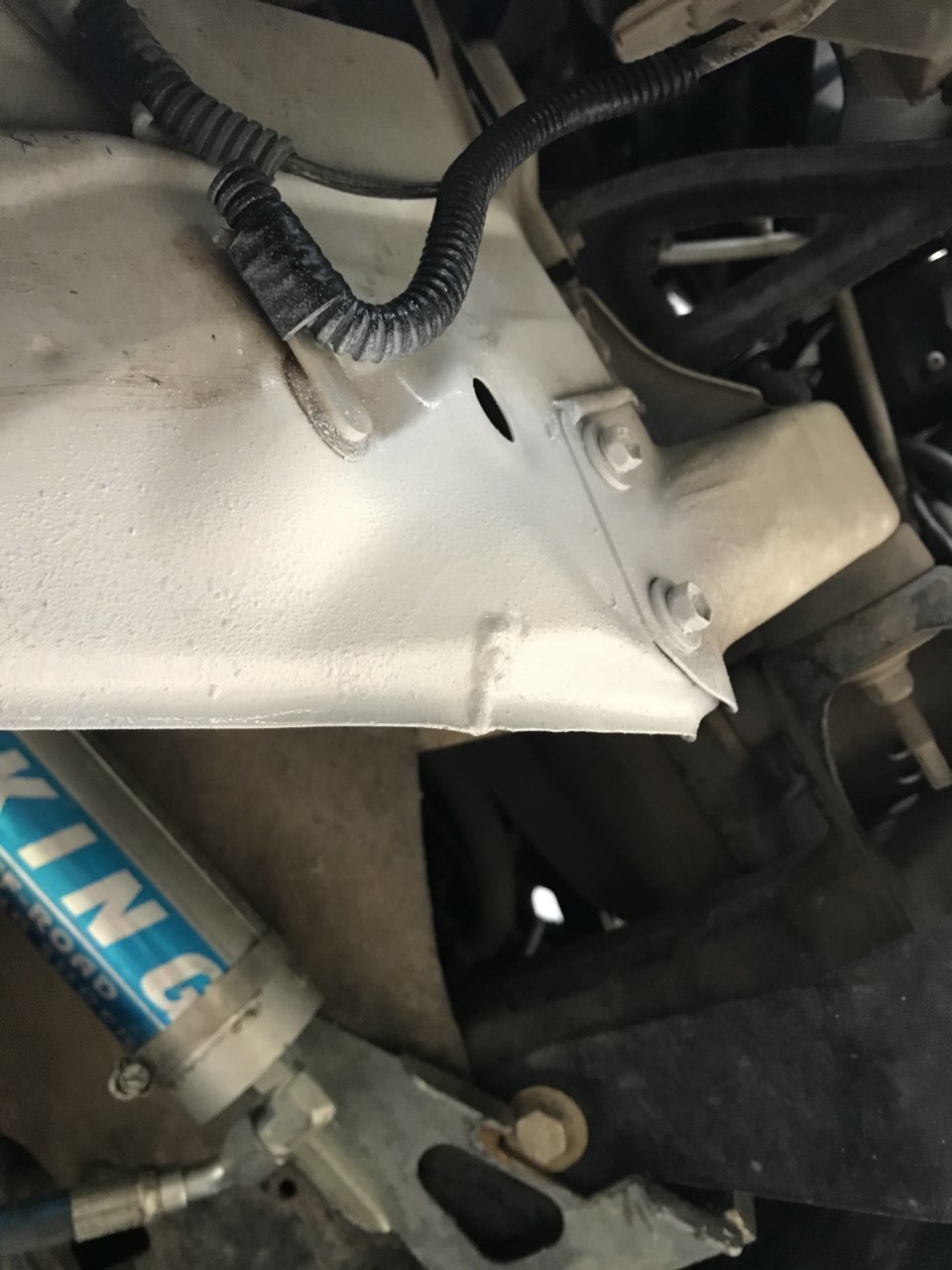

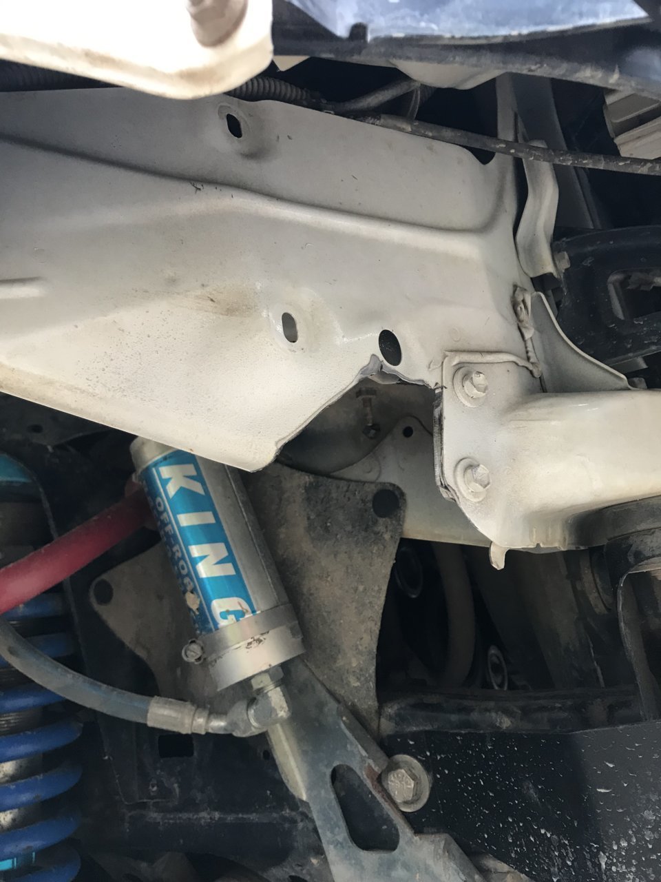

    Stole these from @EatSleepTacos but I was wondering if anyone else has photos of a cracked radiator support before and after pics:
    9A44D25A-FC4D-4336-AFA4-1737F105DEDE.jpg 8723F0C9-2B8C-4D8E-B244-C26A3DCB1BA3.jpg E97776AB-A7F8-4570-AB1F-449DAE7EB715.jpg B68E057D-D484-4AC3-874B-98C7D422A361.jpg 68275A27-28B1-4634-9425-7C5D0D70CF41.jpg
    Hopefully have @GARSHA91 take a look this weekend and come up with a game plan.
    Any suggestions are welcomed.

    Just welding the crack shut didn't work, it tore next trip out. I cut out the section (second picture) and then welded new metal there. That held for awhile and finally tore again. Here are some other threads on it.
    https://www.tacomaworld.com/threads/shes-ripping-apart-click-bait-i-knew-it-was-coming.685302/
    https://www.tacomaworld.com/threads/cracked-sheet-metal-above-radiator-body-bushings.636828/
    https://www.tacomaworld.com/threads/core-support-is-tearing-itself-apart.564190/
    geekhouse23[QUOTED][OP] and uurx like this.

    no pictures, but i tack weld it every 6 months or so, give or take depending on what/where I was driving
    street driving it lasts around 6 months for me, but one good outing in the woods/rocks can make it a weekly thing
    i only have issues on my drivers side though, my passenger side has held up so far :fingerscrossed:

    my biggest mistake was avoiding it for many months and letting the crack slowly grow, what started as a small hair line crack grew into roughly a 4 inch long crack/tear
    after fixing/welding it the first time, and now tack welding it every few months as soon as the first small hairline crack starts, its been much better

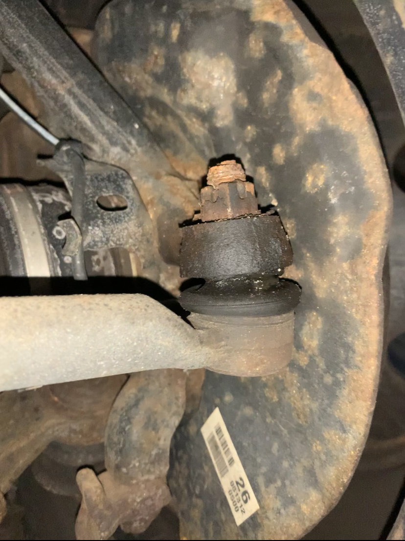

    Well, looks like I'll be adding tie rod ends to the list for the overhaul list..I was leaving the gym and noticed a slight clunking noise at full lock and did a quick check of the front end when I got home to see if anything was broke, loose etc. Noticed the driver's side outer tie rod end boot/bushing was torn:
    Bad angle.
    Everything else seems fine. Although, I think this weekend I will put her up in the air and do a more thorough check and see what else could be needed and place an order Saturday.
    Brand suggestions welcomed.

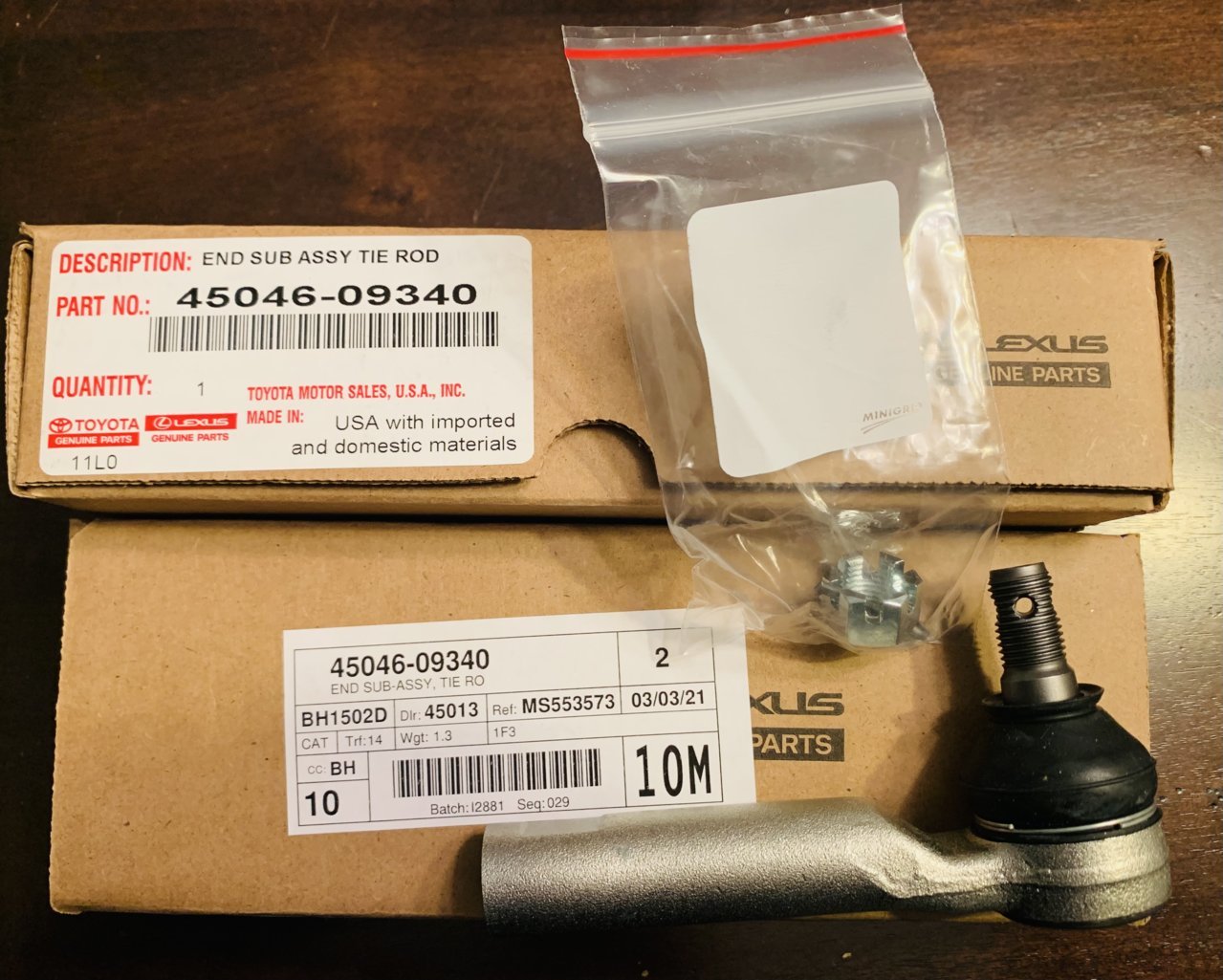

    - Purchased the tie rod ends this morning..$14 for shipping is kinda ass. I went with OEM after hearing horror stories about the Moogs.

    TREs came in yesterday too:
