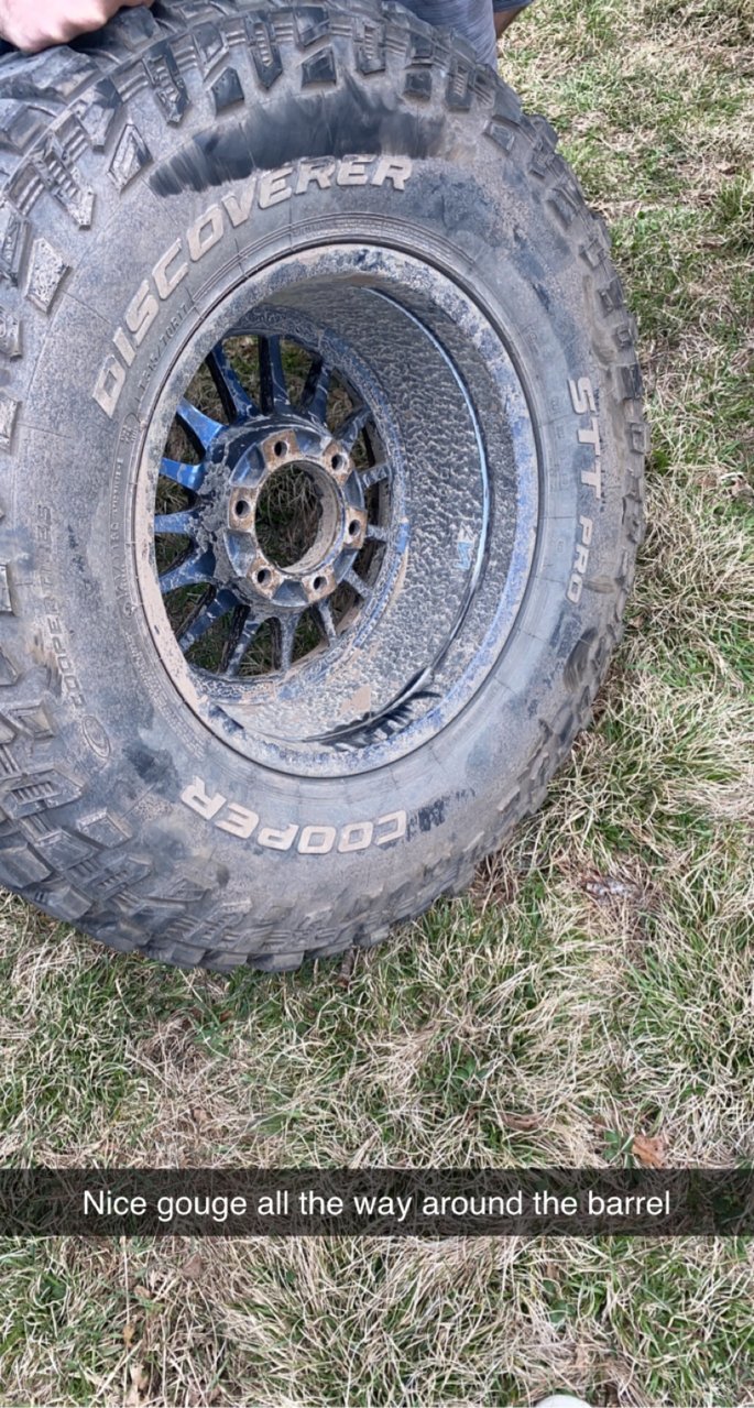

    That happened to my buddy on the trail a month or two ago. Top bolt was missing and the caliper had rotated back into the wheel, leaving a huge gouge. We stole one of his rear bumper bolts, shortened it up a little and got it all working again. The crazy thing was he hadn’t touched those bolts in like 6 months. He inspired me to use blue loctite on mine.
