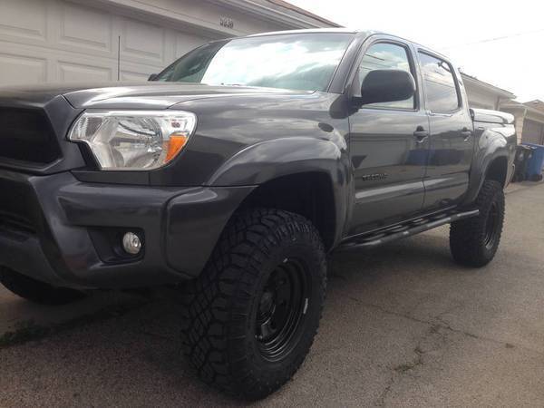

    285/75/16 LT Duratracs Load E :yay:
    So pleased with the new stance of the truck! I do rub a little bit at full lock in either direction, but I haven't trimmed yet. The Hypertech calibrator made it a breeze to adjust the speedometer, very happy with that investment as well.

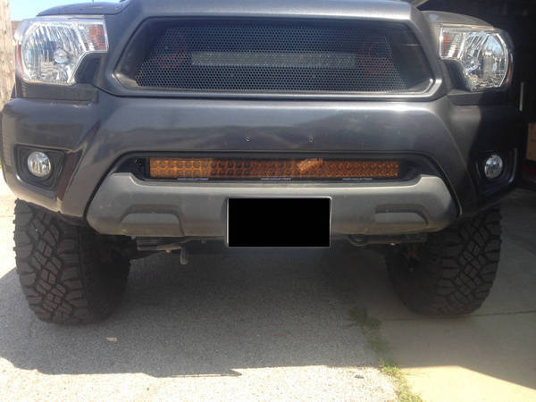

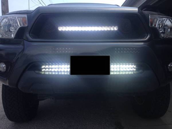

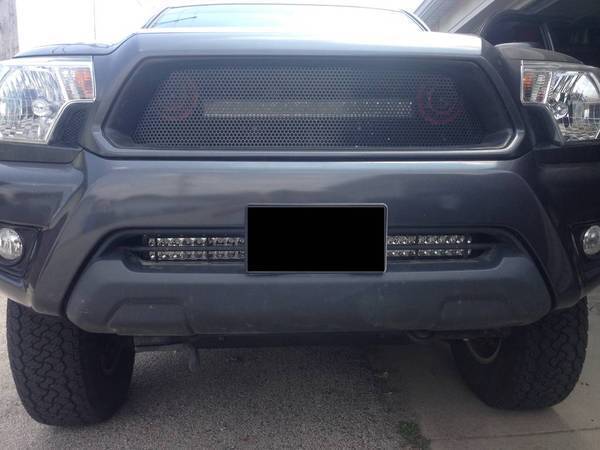

    How did you end up mounting the 30" Light bar in the lower Grill?
    I know you mentioned the Rigid vs. Ghetto Fab, but i never saw your technique. I like how its slightly hidden and isn't sticking out of the front like a set of childhood braces.
  18. Sep 17, 2014 at 7:43 AM
    #158
    geekhouse23
    geekhouse23 [OP] The "Liftman" - @DrFunker
    Jul 14, 2013
    #108251
    15,724
    2GMGMDCSB4WDTRDFTMFW!! TL;DR
    mostly stock, grocery gettin' Prius
    The LED bar spans the opening in the lower grill. Behind it is the aluminum crash bar that provides a perfect mounting surface in regards to height for the light to shine through. Simply drilled pilot holes on each side into the crash bar and used self tapping screws into it. Simple, inexpensive and solid mounting for the LED bar. Didn't even have to remove the bumper.
