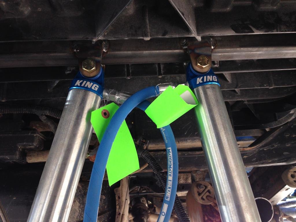

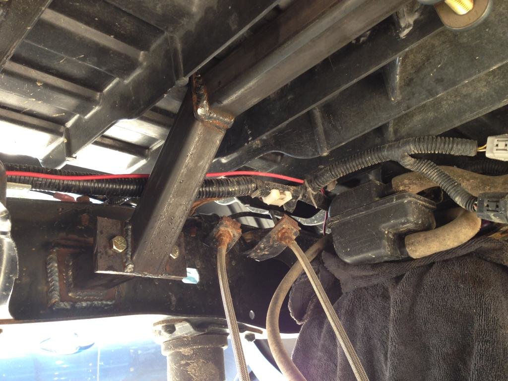

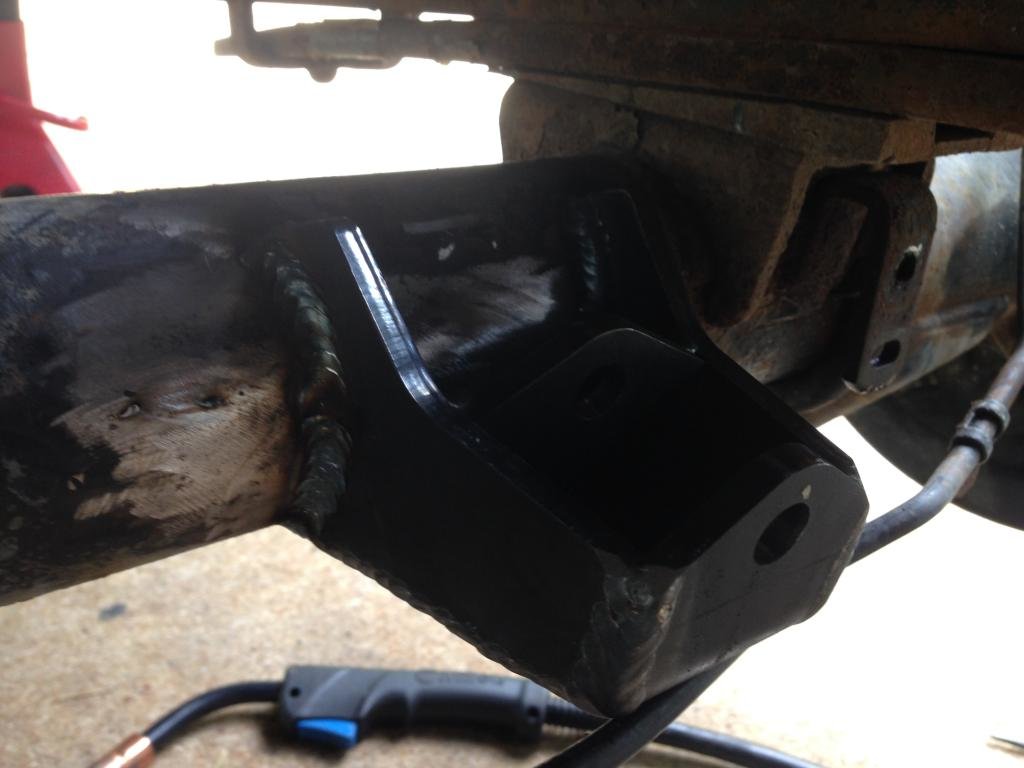

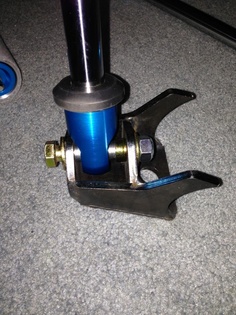

    Yeah I just made a new one out back and used a couple sandwich plates so I could remove it if I needed to change the shock angle. All the material was leftover scrap I had from building bed rack and a few other projects I had done.
    C9159C60-7DFB-4664-BBED-D9446C4A1EDA_zps_3e1f9417d30585a24b9515e16b448ff640ffe81c.jpg
    The axle mounts are 1/4" and are mounted "sideways" to minimize any bind from side to side motion as the axle articulates. I see alot of people mount the shocks with the heims/bushings mounted the other way (forward to back on the axle) and often wonder why, but maybe the binding is not an issue.
    116CB1A9-FF53-44F6-985D-EFFDFCE49CE1_zps_a194a8f6f9224d6b6413189820bae034ecd22df4.jpg
    4252D7A6-BD10-4FB0-AF86-75D12CB1F91E_zps_c322913bca29df3fcbf1696dd4989097313a60f2.jpg
    I also mounted the top in double sheer, didn't want a bolt or tab to break and send a shock flying into my bed or under a tire LOL. I've seen others just use a bolt welded to the crossmember in single sheer but to add the extra tab added minimal work for a better setup
    ACE67B3C-B891-4C54-BCA8-0D04C98CEEA8_zps_0db5f2ae9b8214437cb8423481c08a8660bc6b8a.jpg
    There are arguments back and forth about angling the shocks inward and not having as good response but I had mine valved from DSM stiffer to compensate for the angle, my truck drive fine up to 80 mph and I've towed my 4runner a good distance without issue with this setup as well.
