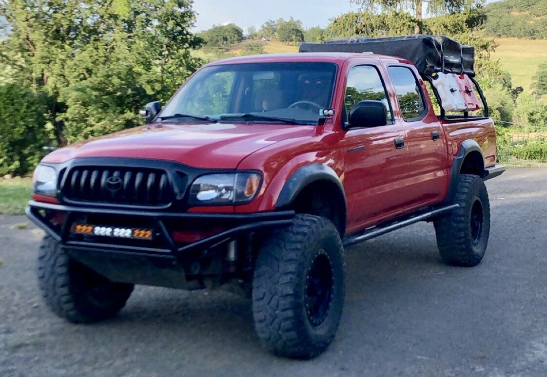

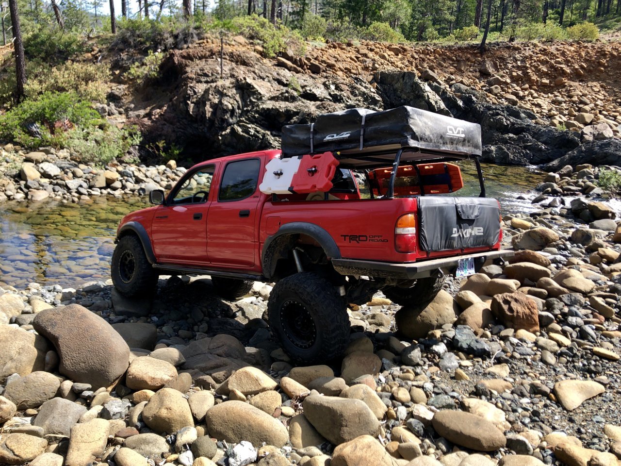

    I use a 2nd gen Tacoma bed rack on my truck and it works just fine. My first gen bed is actually about a 1/4” wider than my dads second gen. I just used some padding that’s made to go between a canopy and the top rails of a bed to space out that 1/4” of play, and some canopy C clamps to hold it down on the bed rails.

    do you have a picture of this?

  9. Oct 21, 2019 at 4:19 PM

    Think it’ll work on an xtra cab?

    Bed width on an extra cab is the same as a double cab so you shouldn't have any issues. I would go with a bed rack that's meant for the longer bed of an extra cab rather than a shorter one for a double cab bed like mine.
