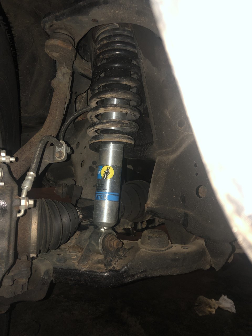

    Hey everyone,
    This is my first post, I’m not sure if this is how I ask questions on here. I recently moved my belstein 5100s with the stock coils from my 2001 prerunner 2.7 liter onto my new “to me” 2004 4wd trd off road 3.4. It lifted the truck a lot less than my previous one, I’m guessing it’s due to the increased weight of the front diff and the bigger engine. What should I replace the coils with to get about an inch of lift. I’m worried about going too big on the springs, I don’t want my truck squatting.

    Hey Jose. So you moved Prerunner springs to the 4x4? First I'd recommend using the original OEM (I assume ) 4x4 coils with your Bilsteins, and seeing how that does. The OEM coils form the Prerunner and the 4x4 will have different ratings.
    Actually, also wondering how many miles all these coils have on them. From the factory, they are progressive, which means the top part of the coil is a bit softer and does tend to collapse over time before the lower coils. I'd look at both trucks first to see if the coils look collapsed (minimal gap between each coil). Posting pics for us would help too. With high mileage and that amount of labor, it may be time to replace them on either set of coilovers.

    Do you already have the clip on the 5100s set at the highest position? Looks like it in the picture. Check the Wheelers website for coils. You should be able to get coils that will give you small lift even with the 5100s set at the lowest position.

    I’d honestly recommend getting new coils, stock or otherwise. For starters, you’ve taken coils from a prerunner and put them on a 4x4, and those springs will have a lower spring rate that the 4x4 springs. Second, you took springs from a 2.7 truck and put them on a 3.4 truck. A v6 is heavier than a 4 cylinder, so the factory springs off the 4 cylinder truck will have a lower spring rate, and won’t support the weight as well. If you’re looking for an affordable option try and find a set of stock v6 coils from a junkyard, or maybe check out moog replacement coils. I put a set of moog coils in the rear of my wife’s 4Runner and they’ve been great. Here’s the link for moog OEM replacement fronts, v6 with off road package
    Moog 81104 Coil Spring Set https://www.amazon.com/dp/B0035R13EM/ref=cm_sw_r_cp_api_i_NO3cEbCYEMY1X
