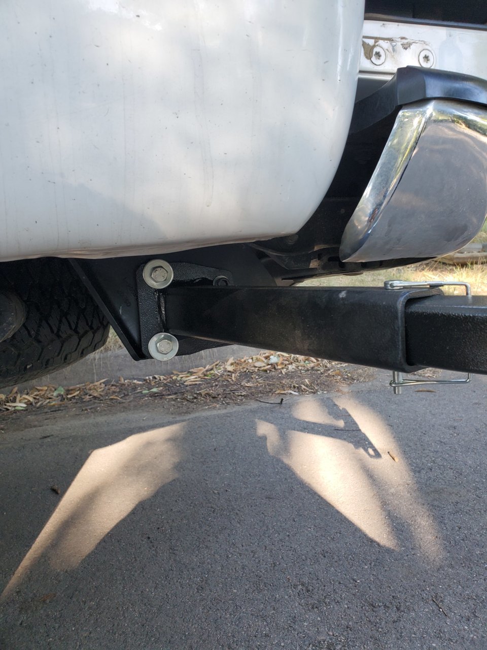

    OK so the front tie downs were super easy to install... 8 bolts in all. Took a little finagling to get things right, but I expected that! Decided to take the truck in to a few shops to get a quote for the rear tie downs.

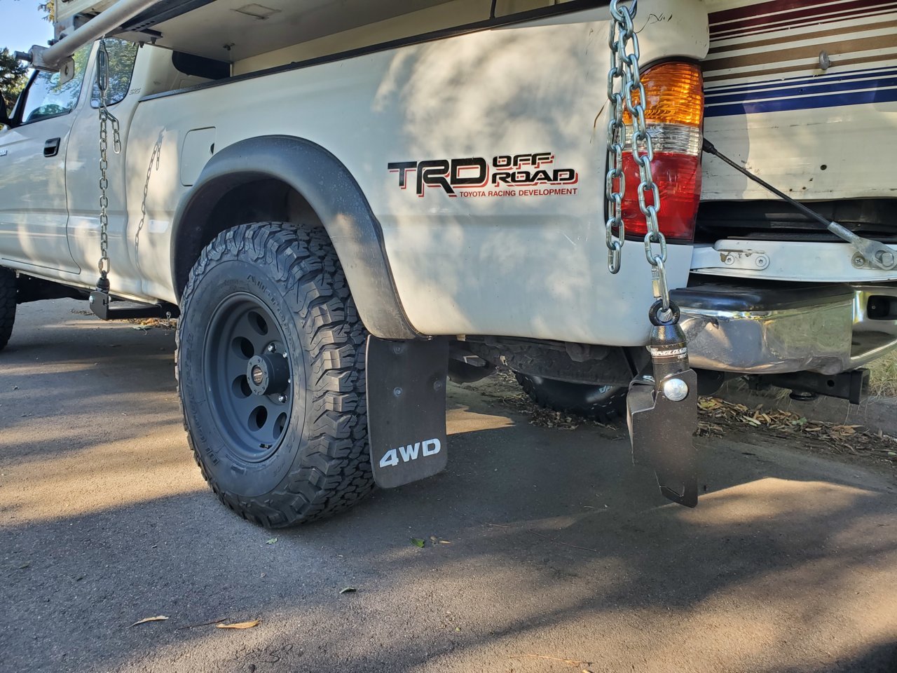

    Alright so got the tie downs installed successfully.. according to the shop it wasn't the easiest (burned through some drill bits), but it's done! Took the rig out this weekend and felt pretty good.

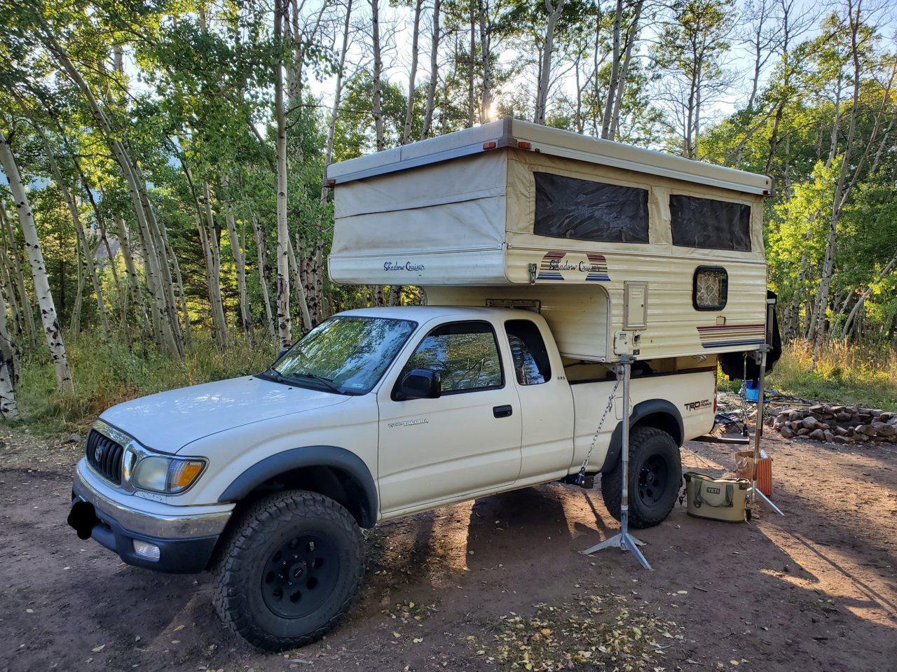

    some more pics

    Are you running airbags? Sits pretty level.

    Nope, no airbags. Just OME nitrocharger kit and add a leaf(s). Thinking of adding a timbren enhancement system in the rear just to pop it up a bit (it does sag a tiny bit). I also plan on having the camper in most of the time.
