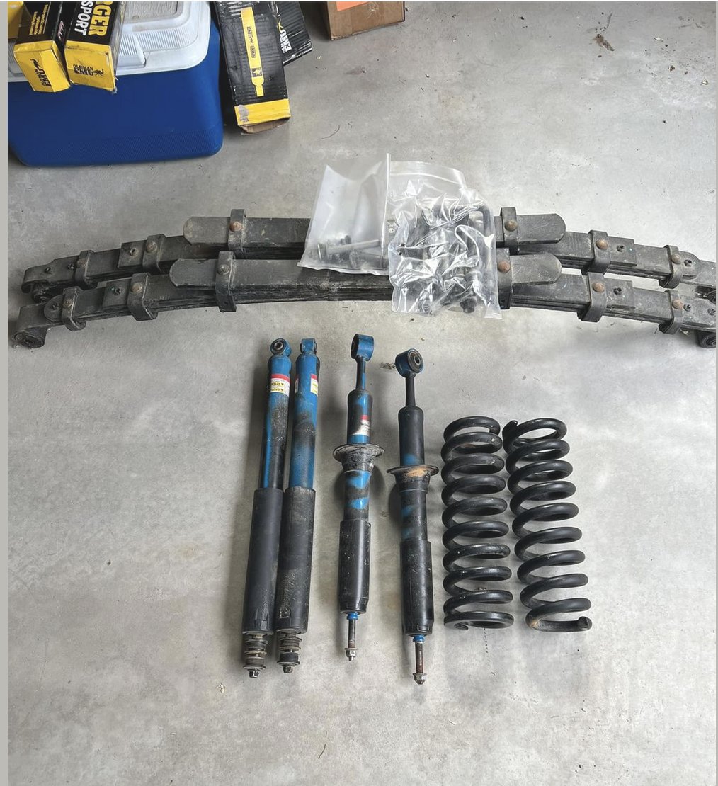

    Looking to replace my stock 2012 DCSB TRD OR with leaf springs from a 2022 TRD Sport. Is this going to work? Every thread I've seen says 2005+ are all the same size.

    Yup, they'll work just fine. Part numbers are different but fitment is the same.

    Progressive vs linear is only the front coils.
    OP might not want to lift his truck at all hence the new take offs. There is no open recall for leafs on the 2012+ trucks.
    Yes OP they will fit.

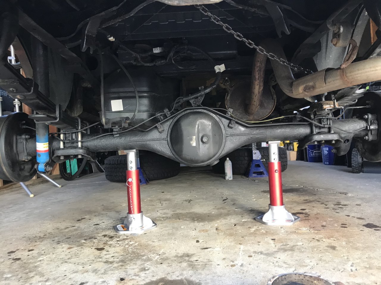

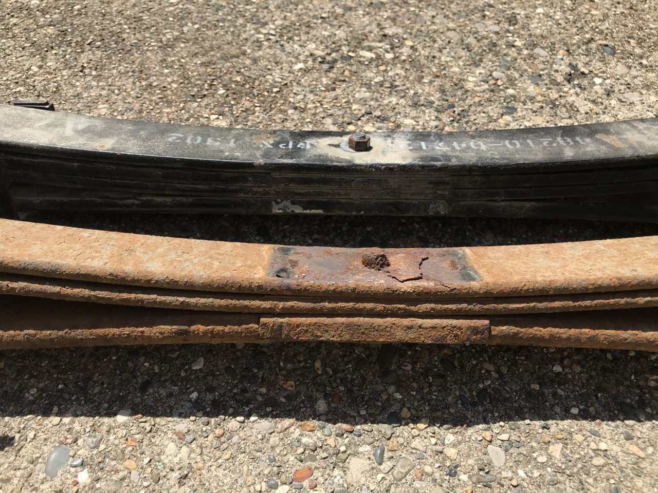

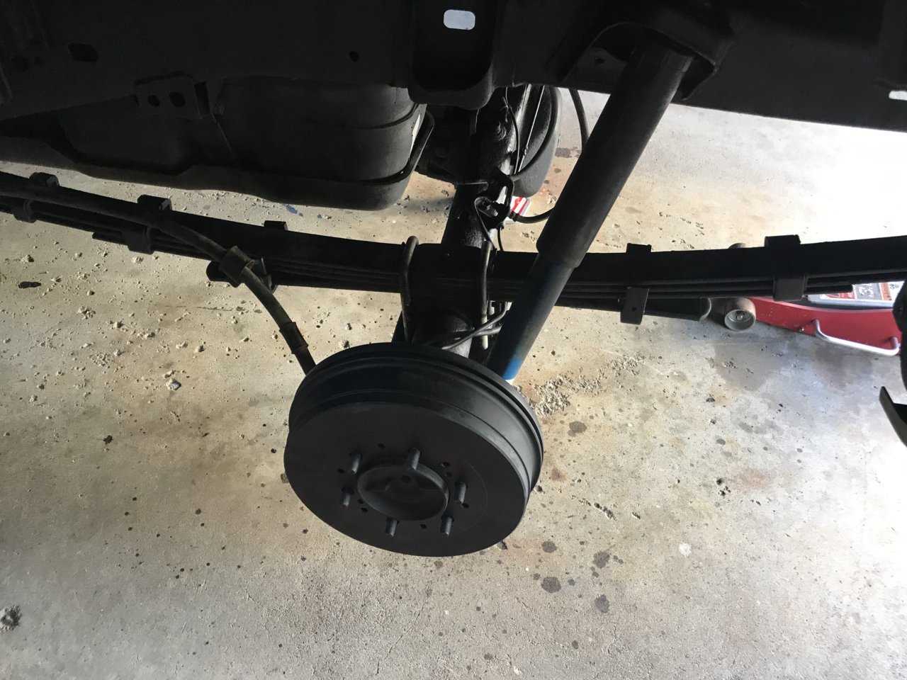

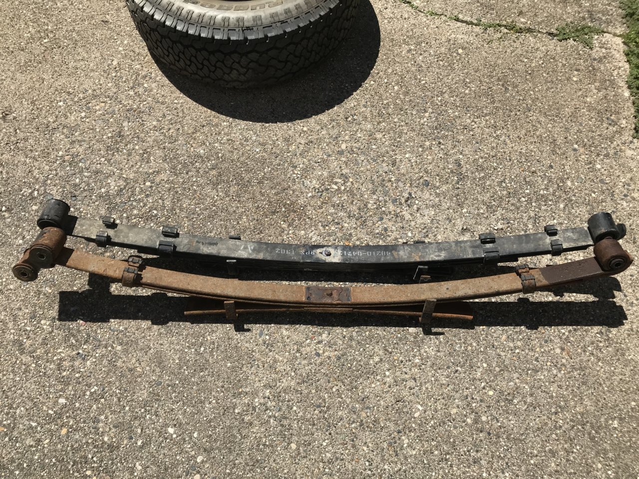

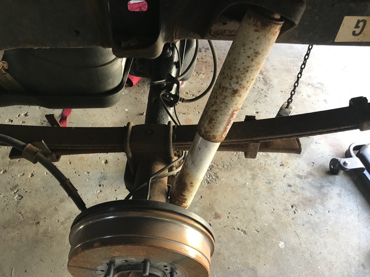

    Got everything put on yesterday (including the shocks, still better than my 170k shocks). Gained 2 1/4" height in the rear! It overall feels way nicer, like I have a new truck. Took the opportunity while the spare was off and the axle was down to do some rust cleanup and prevention. Very pleased with how everything turned out! Thanks again everyone for the quick replies which made me feel confident to go with the used parts. $250 for the whole haul!
