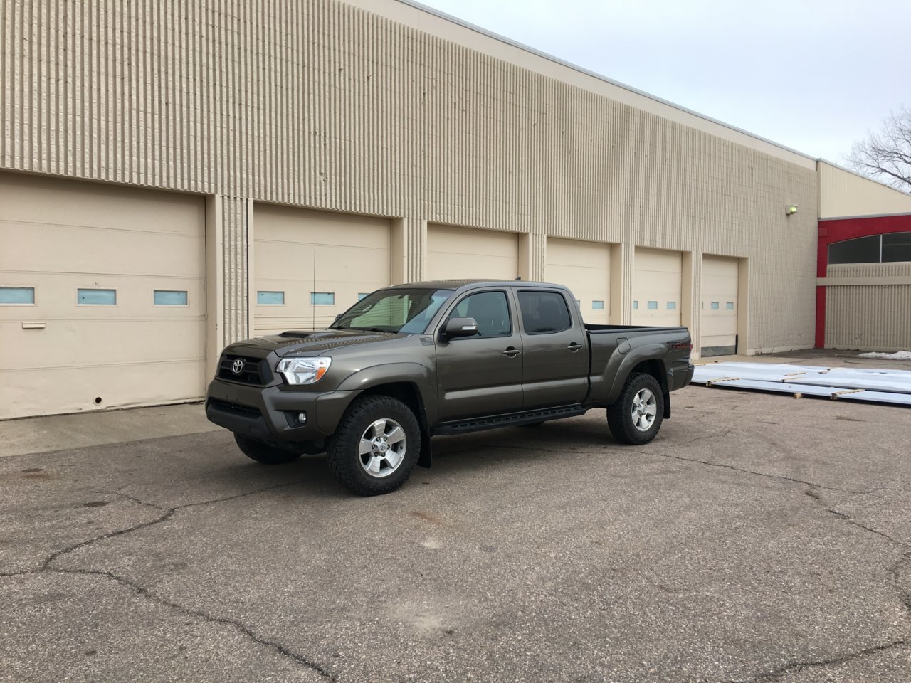

    Hey guys, I'm normally just a creeper on the forums. But I recently purchased and installed a 2017 TRD Off Road suspension (100 miles) on my 2015 DCLB TRD Sport with 36k miles. My stock suspension is far from worn out. But I read that some have put the 3rd gen suspension on their 2nd gen and that most have noticed a gain in ride height and have improved ride quality. However thats about as far as most peoples reviews go. It's a bit frustrating when you're looking at a thread and someone does a write up and doesn't give more of a review than "it lifted the front about an inch and it rides better". What does that even mean!?
    EDIT: Long overdue install tips and other info update is in BOLD!!! Don't get caught up on the COLOR of the DOTS. What is important is that the DOTS and lower spring mount coil cut-off section are facing the REAR. You can see the coil cut-off circled in RED barely peaking out behind the sway bar link. While the springs with certain color dots are factory installed on a certain side, I have not see any evidence that the spring rate or length is different between the part numbers/dot colors. In fact, Toyota has 5 different part numbers for the spring specifically for the TRD Off Road (also happens to be for the TRD Pro as well) depending 2wd vs 4wd and even wheel base (127" and 140"). One would assume that the left front from a DCLB could have a slightly higher spring rate or slightly longer, but I can't find that info. I'd be curious if we have any Toyota Parts or Service employees that may be able to help to break this down a little.

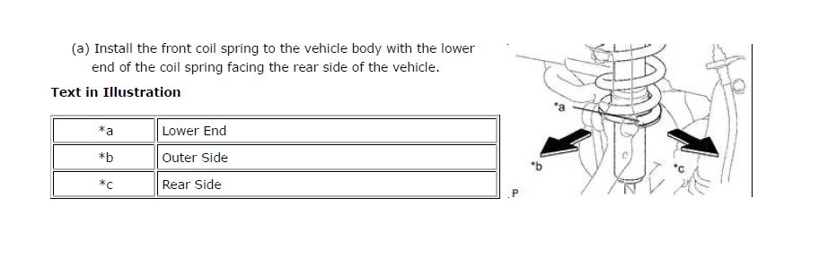

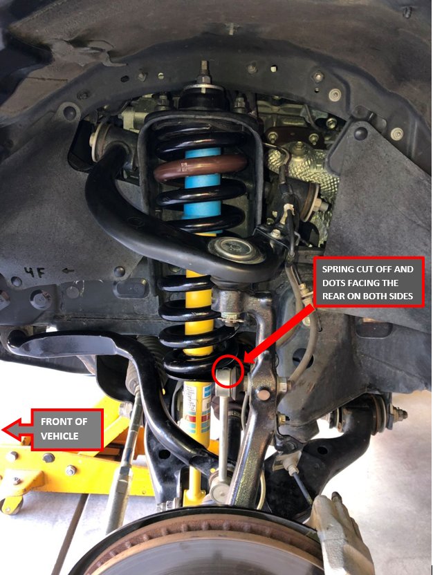

    Here is some pictures to help with the front shock orientation. Thanks to @splitbolt, @ChrisK7UND (modified your image a little bit) and others from the thread linked below, sorry for stealing your pictures...but thank you :thumbsup:
    https://www.tacomaworld.com/threads...n-trd-off-road-shock-strut-assemblies.618845/
    For the rear the shocks are the same on both sides so there is nothing to worry about there. BUT the leaf springs...there are 14 part numbers!! The differences are left vs right, standard vs Off Road/TRD Pro vs "firm ride" (these are 3 leaf +1 helper), Access cab vs Double cab and even Auto vs Manual. I assume the majority will be the "firm ride" since I have never seen a TRD OR without a tow package. I won't get into detail too much on that. The best way to find out which side they need to go on is to look up the part number on Toyota Parts website that is on the leaf spring if it's still there.

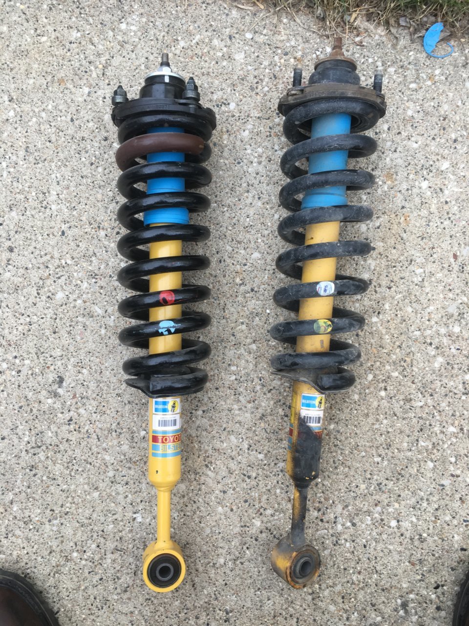

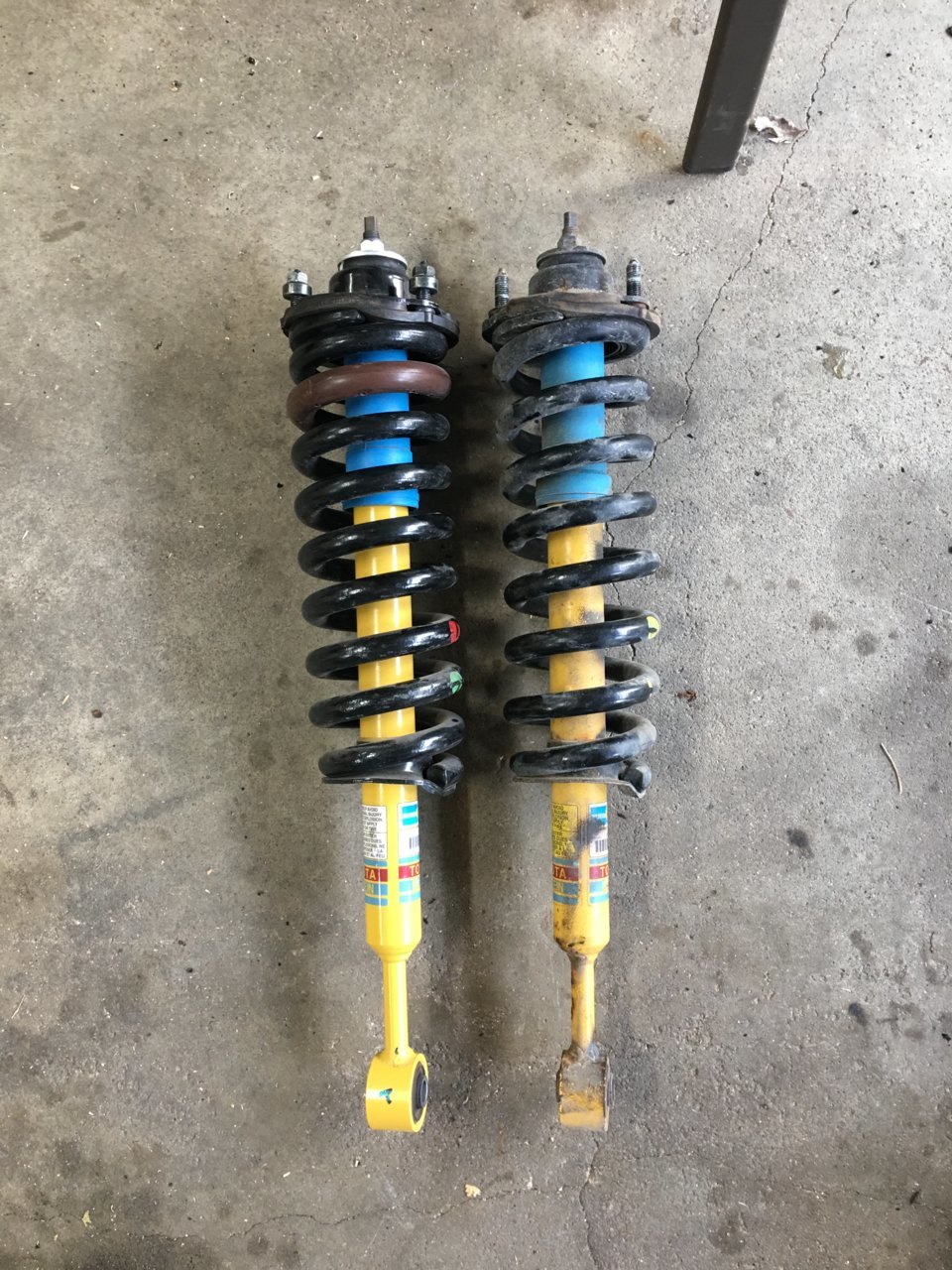

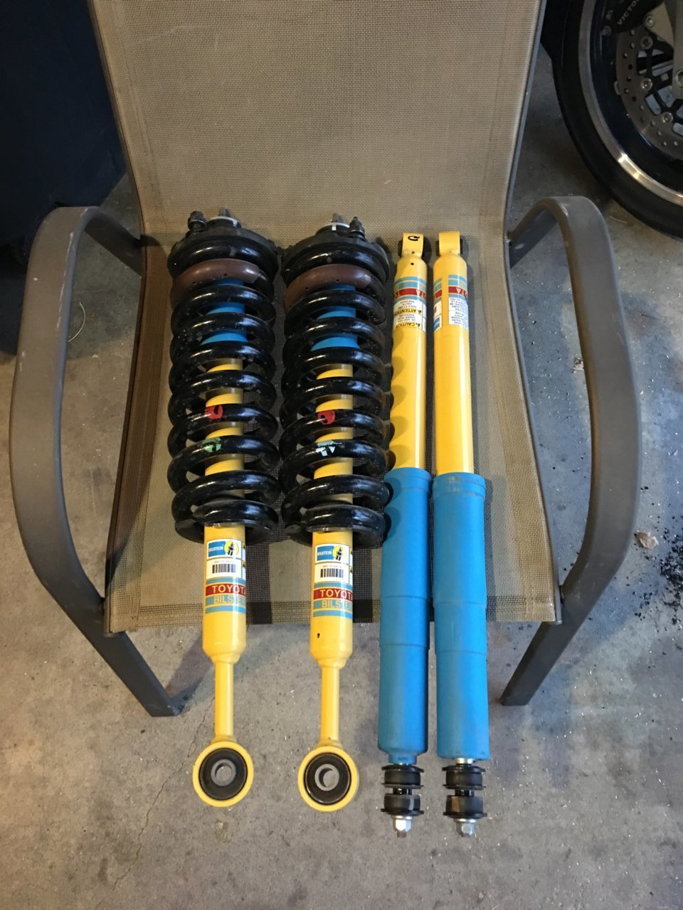

    Here is old and new.... New on left and old on the right. From previous research it seems like the spring with the RED and GREEN dots go on the drivers side (see EDIT above). Thats the way I did it and it seems to work fine for me. You can tell the thickness of the coil and the amount of winds that are in the coil.

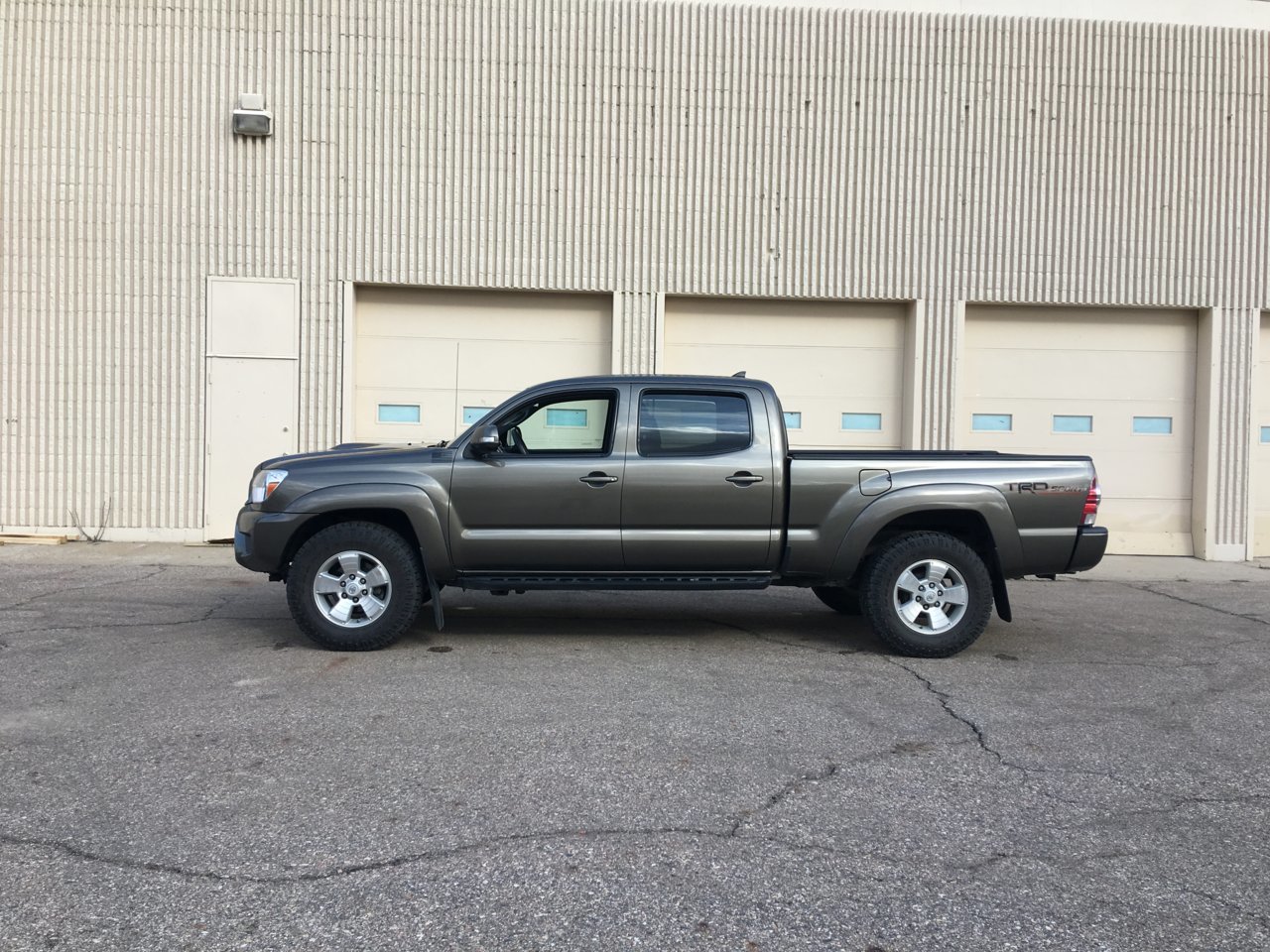

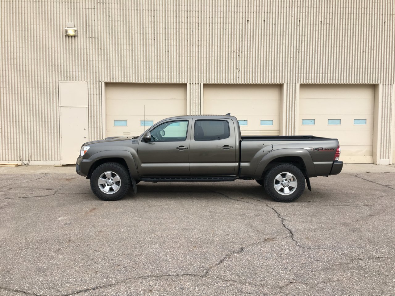

    Well, I took measurements and I'll give my best opinion on my suspension swap.
    So for the measurements...
    Before -
    LF 34 1/2"
    RF 35 1/4"
    RR 37 1/4"
    LR 36 3/4"
    After -
    LF 35 1/4"
    RF 35 3/4"
    RR 37 1/14"
    LR 37"
    As you can see it gave me about 1" lift in the front and took away a little bit of the lean. My suspension only has 36K on it so it's not like it's sagging a lot worn out. So some of you that have more miles may even see more of a lift over your current stock suspension. I tried to park it as close to the same spot as possible and measured from a rivet (aft of center) on each of the fender flares to the ground.
    The ride is in-fact MUCH better! These are my impressions after about a week of driving. It feels more planted/settled in every situation from cruising down the interstate to going over rough train tracks, gravel roads and mild off roading. Before I felt the rear end seemed unsettled/nervous and wanted to bounce around a bit over really bumpy roads and bad train tracks. It seemed like it just was not dampened well, like a really really stiff set of cheap Honda coil overs almost(not quite that extreme of course). There is a certain on-ramp in my town that has really bad potholes and shady repairs as you turn from the street on to the on-ramp. With the Sport suspension as I noticed it wanted to bounce around a bit and it would loose traction on the inside tire pretty easily even in the dry. Now it soaks up those bumps really well, stays planted and never really looses traction under medium-heavy acceleration in that same situation. The front you can tell is more stiff, but not in a bad way. The stiffer springs don't make it ride more stiff in my opinion, which I was worried about. From the research I have done I have found that the 3rd gen front spring rate is 717lbs and the 2nd gen is 500lbs. Even though you can tell the spring rate is heavier but the damping is night and day difference! It leans less when entering corners due to the spring rate, feels more stable in bumpy corners because it is able to dampen better and gives you that little bit extra lift. It also dives less when heavy braking or when hitting a dip in the road because of the stiffer springs. It seems like it has more suspension travel as well or at least smoother travel of the suspension. If you have ever test drove the 2016+ TRD Off Road and compared to the 2016+ TRD Sport you will be able to tell the difference. I think it makes my 2015 ride almost identical to the 2016+ TRD Off Road for reference. Heck even my wife noticed an improvement in ride quality and thats odd for her to notice anything about a vehicle. Link to spring info below VVV
    https://www.tacomaworld.com/threads...2016-tacoma-presented-by-toytec-lifts.395798/
    Overall for $200 or less you can't beat it! Especially if you are replacing a 100k+ old suspension or if you were like me and just wanted a smoother ride. It only took about 2 1/2 hours to replace everything as my front struts were still assembled. Everything bolts right up, no modifications needed at all! I haven't aligned it yet, I have an appointment in a couple days.
    I hope this helps someone else out. Let me know if you have any questions!!
