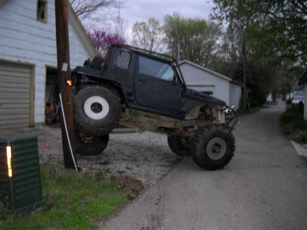

    I have built MANY off-road rigs in the past, this truck will not be used for off-road until the truck is past the 15 year frame rot warranty.. Then at that point it will get 4 linked in the rear with Dana 60's.
    I am trying to get this done on the cheap, since I have been unemployed for the past 2 years, and had to sell my 2005 Daily Driver, and down grade to this truck.. I just now got back to work, and don't have the $1200 that the truck needs to replace all of the suspension so that I can drive it to work.
    NO the truck WILL NOT be driven on the road until I am 100% happy with how everything works.
    This is my last 4x4 wheeling rig, Chevy 4.3, Chevy t350 tranny, t-case adaptor, 82 Toyota t-case, 82 Toyota axles, 92 4runner drive shafts that I cut down, 87 Toyota IFS power steering, Toyota Land Cruiser front brakes, Sky-offroad disk brake setup, 80 Pontiac Firebird master cylinder, 36x12.5x15 TSL's on bead locks, 4-link rear w/wishbone upper link on jeep coils, front is YJ leafs that had been redrilled center pins to move the axle forward. The frame was extended 10 inches in the front, and ALL of the stock mounting points for eng, tranny, tcase, and suspension were cut off of the frame and replaced for all of the different parts.. Also cut the top off of a tin top sami, cut 20inches out of the top, welded it back together, and then fitted it on to the convertible Sami.
    I have rolled the Sami several times, it climbs up trees with NO problem... and with all of the wheeling that I did in it the ONLY suspension parts that ever broke on me was: I snapped a spring after stuffing it into a tree at 20 mph, and I ripped one wheel off when the studs that hold the knuckle on sheared off when I rolled it.
    And I built the complete rig for only $3500.. and that's including the cost of the Sami itself.
