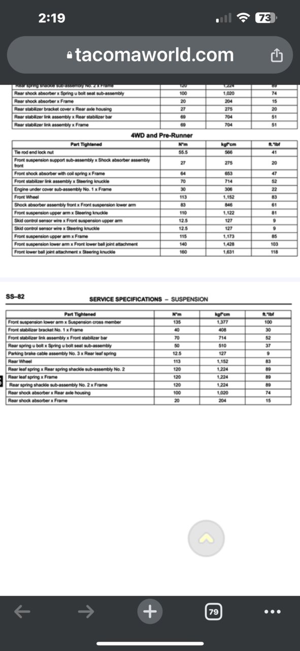

    See pic it was 37

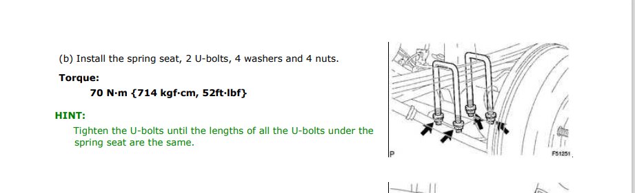

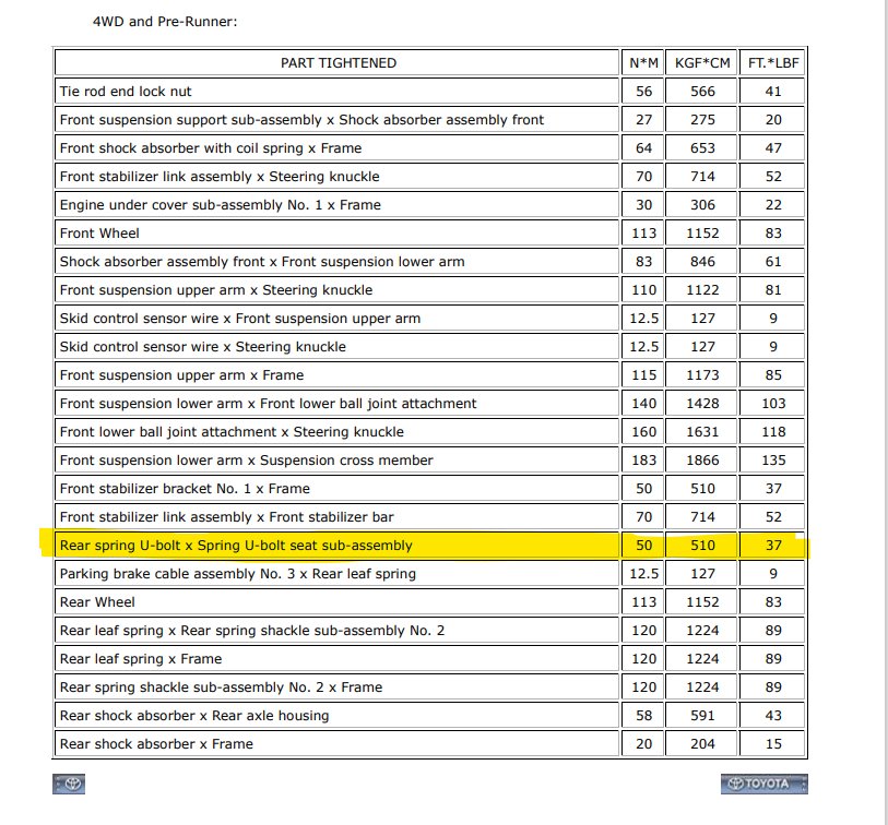

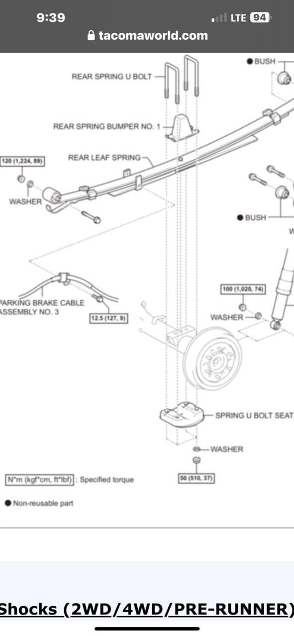

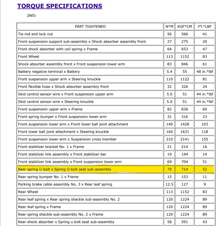

    I ran into the same problem when I put 3rd Gen leafs on a 2nd Gen. I didnt think 37 ft lbs was correct either. I went down the Tacomaworld rabbit hole of conflicting information to try and get the correct info. So I checked the 3rd Gen service manual and it gets confusing. In the master torque list for a 4WD it shows the same 37 ft lbs for the u-bolts, but the 2WD shows 52 ft lbs. However, if you check the section on how to install the u-bolts it says 52 ft lbs, and it doesnt specify 2WD or 4WD. I finally went ahead and torqued the 3rd gen FSM. I attached the torque info from the 3rd gen service manual.

    Few lines up from bottom line
