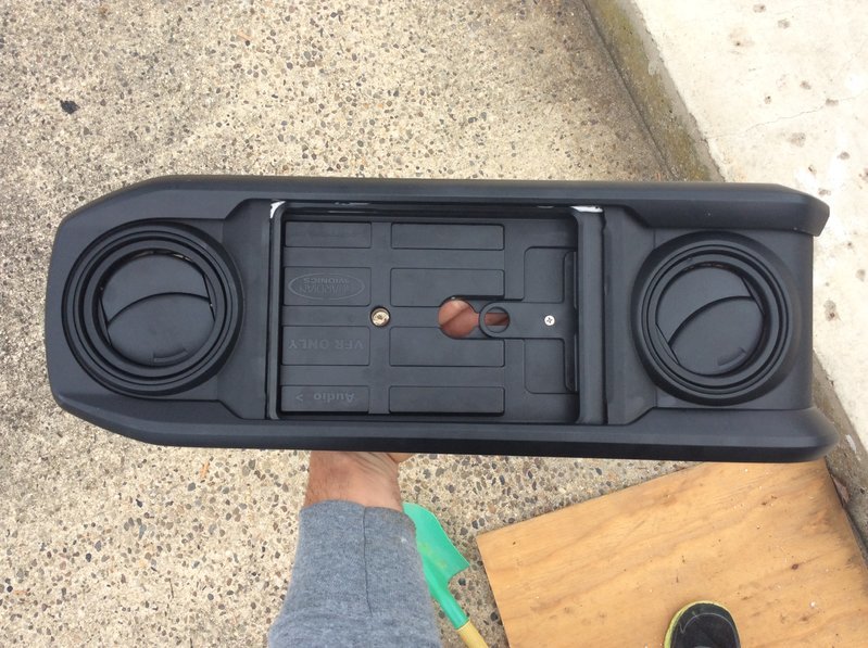

    this is the start of a log on the dash iPad mini install
    I bought one of these
    http://www.ebay.com/itm/iFDR-Aircraft-Panel-Flush-Mount-for-Apple-iPad-Mini-Mini-2-Mini-4/252402240310?_trksid=p2047675.c100005.m1851&_trkparms=aid=222007&algo=SIC.MBE&ao=2&asc=40293&meid=758c3c0d3b8b4b1bb536101e6daf69a9&pid=100005&rk=2&rkt=5&sd=252419637447

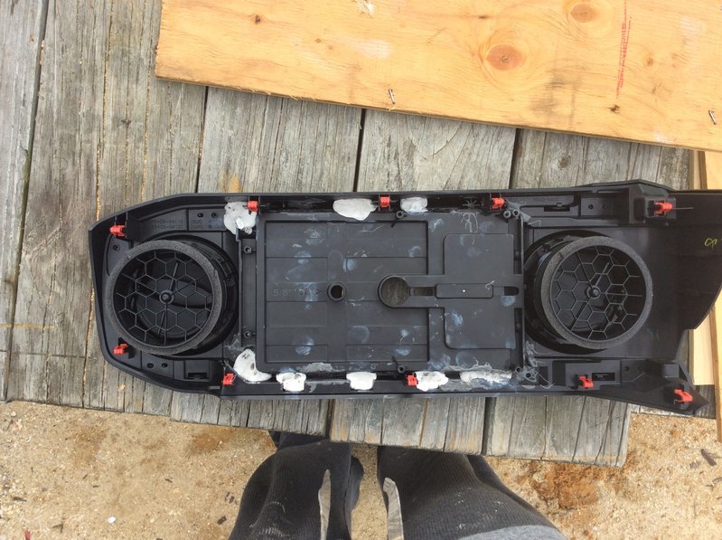

    Trimmed the sides of it.
    Removed the front radio dash piece and trimmed it.
    Used Jbweld to secure it in.
    This is just a project that I started and will be updating.
    As for an amp, I ordered
    https://www.amazon.com/gp/product/B00BF6HXA8/ref=oh_aui_detailpage_o02_s00?ie=UTF8&psc=1
    And for iPad interface
    https://www.amazon.com/gp/product/B00GP3PB4G/ref=oh_aui_detailpage_o01_s00?ie=UTF8&psc=1
    Could go with wifi or Bluetooth backup cam. Don't think that I can do anything to get the steering wheel controls to interfaceIMG_2961.jpgIMG_2959.jpg IMG_2952.jpg

    The factory radio in the SR is basic to say the least. I never listen to radio and use my iPad for music anyway.
    The dash piece is an easily replaceable piece of plastic. No cutting is being done to the truck. I want it reversible, just in case this has a humble end.

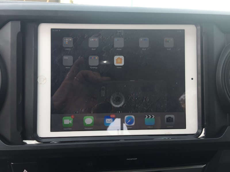

    Great skills. Don't take this as a criticism, but it would like
    great with a black bezel on the iPad.

    Gotta get the black iPad! Looks good though

    I already had it. Black would have been nicer, agreed

    I contemplated it, but a few things holding me back;
    1) No Vid input to retain OEM backup cam
    2) Won't integrate with OEM steering wheel controls
    3) Can't retain on-screen info in instrument cluster.
    Other then that, an Ipad is awesome idea

    there might be, but the iPad dock would block the radio controls. unless you mold your own iPad dock.
    the iPad is better than the stock radio by a long shot. The amp setup and wiring was not worth it. The stock radio with the iPad works well.
