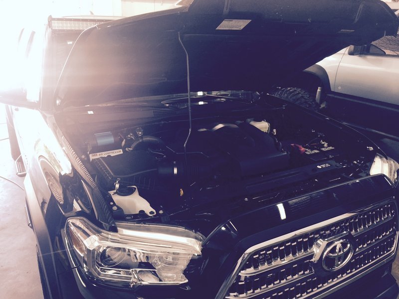

    101
    My air compressor location.

    Details on mounting please

    I had it done at Motobilt in Dothan AL, hose is routed to the cubby hole on the left side of the bed. Pm me any specific questions or pictures you'd like
