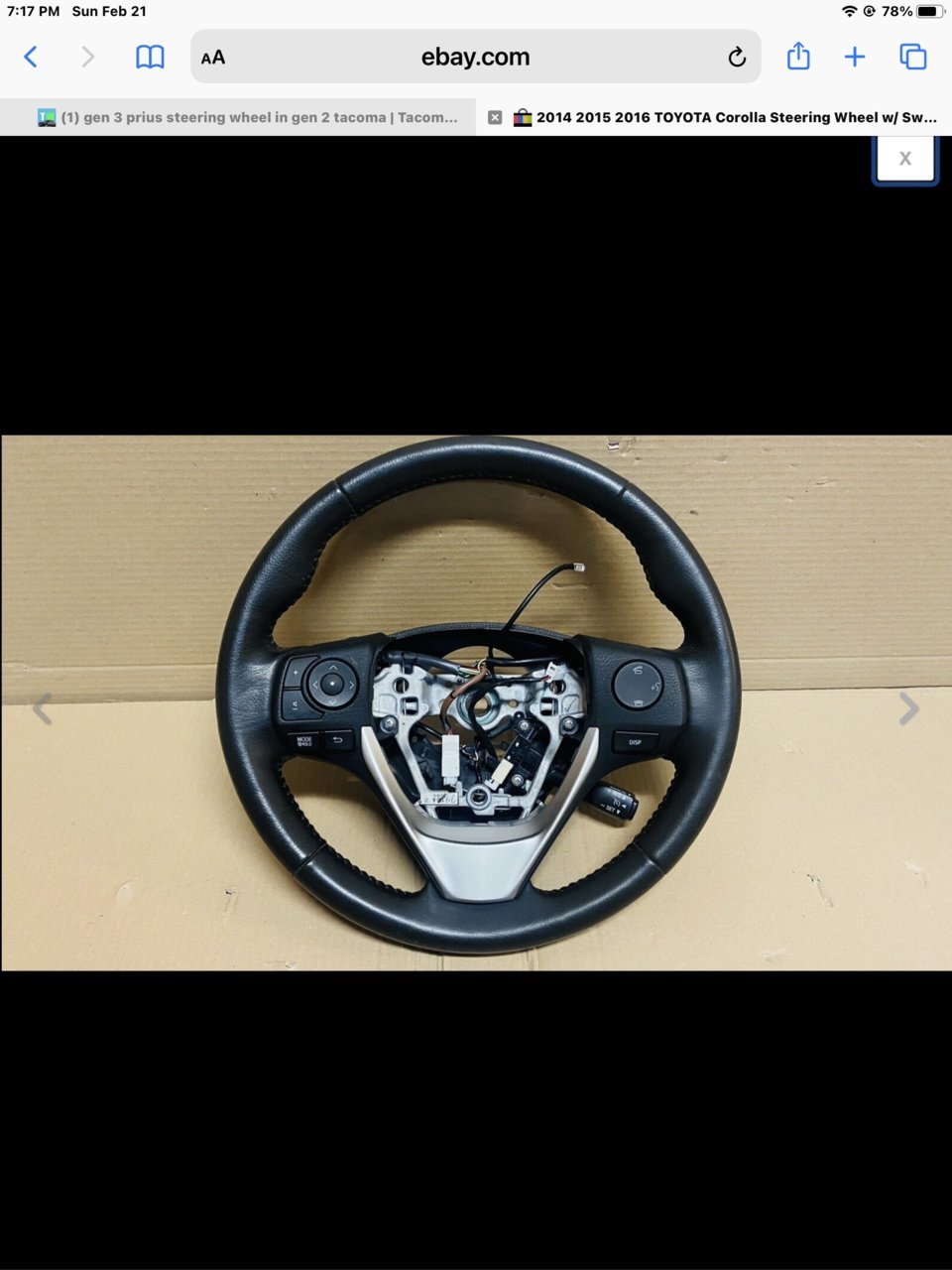

    Hard to tell, without the trims and airbag, I bought a 2014-2019 Toyota Corolla steering wheel with airbag and clock spring, supposed to have by next week,will post pics after installation. I have 2007 without swc,planning to attempt adding swc,I think it’s possible.

    I’ve been looking at Corolla steering wheels for my 14 Tacoma.
    Ends up being ~$400 for a nice leather one and airbag....
    Checking options first.

    Bought mine for around $450.00, along with clock spring

    i installed the corolla wheel on mine

    That looks like an aftermarket steering wheel

    That’s similar to the one i bought

    it is...but the airbag and all the controls are from the corolla

    i didnt even have controls, had to get my clock spring and all

    you just get the aftermarket kit if you have an aftermarket head unit

    no, but i had the 3 wires from the back of the stock head unit...thats why i had to get a new clock spring....if you are using the stock head unit, it should work

    im getting an idatalink maestro cause i have a new head unit and hopefully i'll be able to change the buttons...the only thing that doest work is the return button and the display button...all the others work and mine, oh and doesn't light up either

    Which year clock spring did you use

    i used the 2007 to whichever year it was
