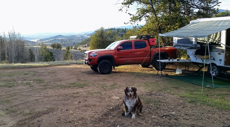

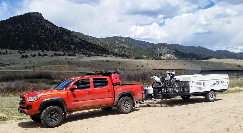

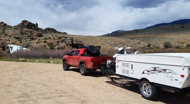

    Took my new pop up out for the first time this weekend. Had a pretty good amount of weight on the tongue, the weight distribution hitch did great on the highway, but I tow on a fair amount of 4wd trails, and the wdh comes off when I go off pavement, so sumo springs or air bags are in my future. The truck towed well, going over Kenosha pass was a bit of a challenge, but ever spot to the west of Denver requires at least one decent mountain pass. P3 brake controller worked great.
