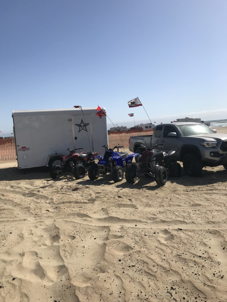

    Ill give my 2c on this. I pulled a 12ft with 3 quads about a 2 hour drive to pismo. Once reaching SLOs uphill I felt I was battling the weight. As I was driving I could feel the truck was heavy as hell. Personally its not built to haul but I dont do it weekly so it does for nowE73545F2-326C-4DEF-A49B-85F0F0CE9324.jpg

    Part of the problem is that trailer. If you had a low profile open trailer, it would pull those toys easier.

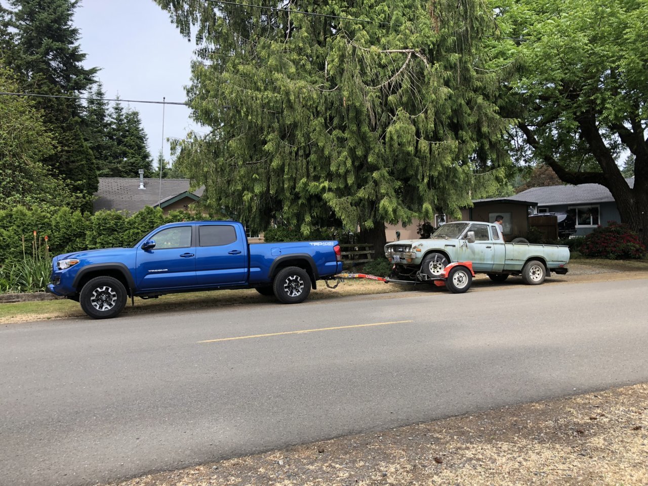

    This is a good spot for my first post. I just got a 2016 TRD OR DCLB and towed a Datsun 620 on a uhaul car dolly and it did great. You could tell the weight was back there when stopping and getting up to speed but still had plenty of power on the freeway. I’m loving this truck so far.

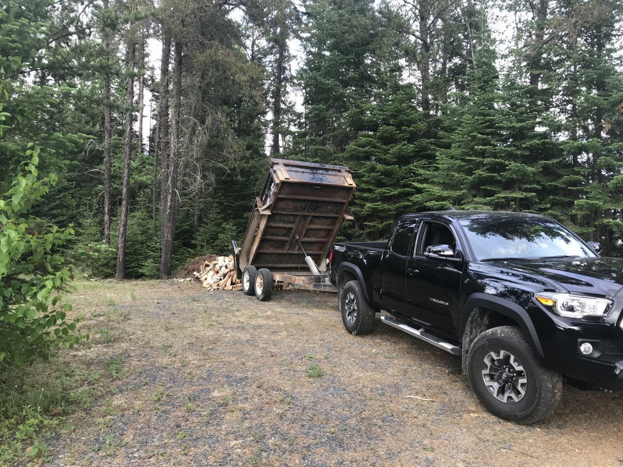

    The Tacoma handles the 6x10 dump trailer full of firewood with ease (only about 1/2 a cord of wood). Better than the Ranger I upgraded from :)
    Now to find a way to engage lo range without 4x4 for backing up in tight spaces.... hard on clutch and wind-up on hard surfaces!

    At least one member has tackled the 2lo mod, good info in here:
    https://www.tacomaworld.com/threads/lock-stock-and-2wheel-low-3rd-gen-diy-mod.536677

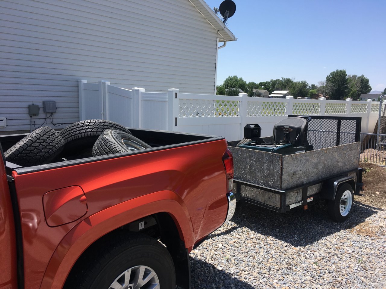

    So first time towing anything. We have had the truck for a month and I picked up a freebie little riding lawn mower and the guy had some tires he was looking to get rid of so I took those of his hand as well.
