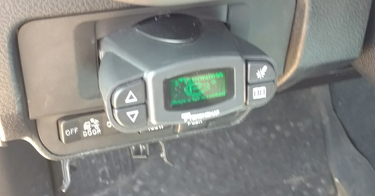

    I have a 2017 TRD off-road 4 by 4 double cab. The P3 is easy to install it's a plug-and-play installation
    Remove the kick panel at your left foot and you will find the factory wiring harness there, then the panel underneath the steering wheel there are two screws down low remove them then pull on the panel and the clips will come undone. The controller fits right in that area so once you have it installed just run your wiring down to the factory harness use a couple of tie straps to button everything up and you're good to go.

    PS: once you have the panel loose underneath the steering wheel there are four screws you will need to remove so the change holder comes right out.

    I have a P3, the plug/play harness and the ESP mounting kit. I was going to install it all, then saw how far it was going to stick out and have decided to hold off.

    I am hoping I can get an insert to swap out the coin tray so I can get it recessed as much as possible.

    Not sure if that would work the controller just fits the opening so it would be hard to recess it any more than what is shown in the picture. Remember you want to get it installed where you can activate the lever on the bottom of the controller quickly in case you get excessive sway back and forth on your trailer. The way I have it mounted works fine plenty of need room to get in and out so I would suggest installing it as shown in the picture.
