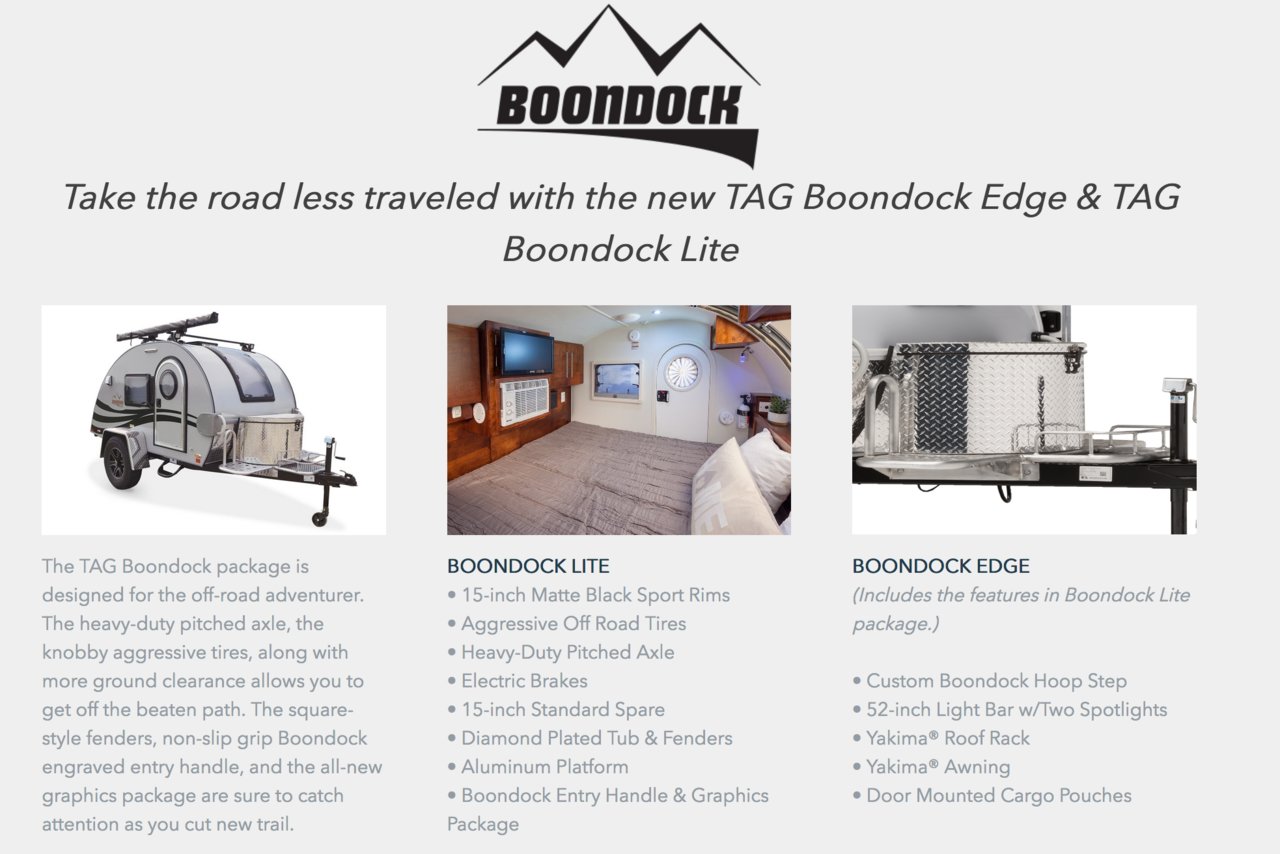

    It looks like those campers do come with brakes:

    I am throwing out a super wild assumption here, but if he plugs a trailer into his pickup and the brakes dont register, then he doesn't have trailer brakes. He's either got a 4-flat plug or a 7 pin with no 7th pin.
    I've been wrong before. But it makes sense to me.
    I have a 6x12 H&H enclosed trailer and weighs 1100lb empty. Brakes are an option but not standard.
    Edit: zooming into the picture he has a 7 round plug.

    The camper I rented did NOT have brakes. Apparently they're optional, which I didn't find out until afterwards New to all this towing nonsense, but the trial by fire didn't leave any (new) blisters.
