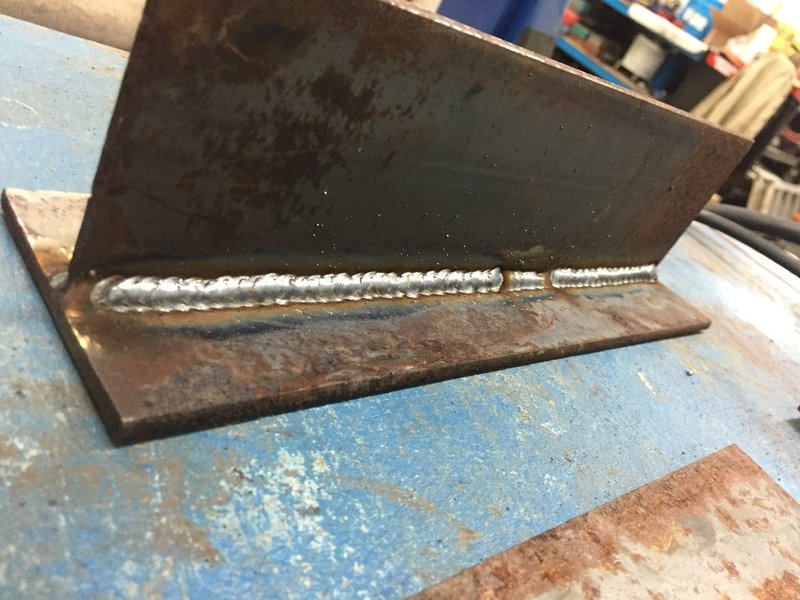

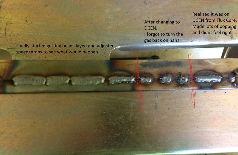

    haha i can imagine. my first project is modding some tube doors, so it will all be horizontal (which is all I can handle right now haha).

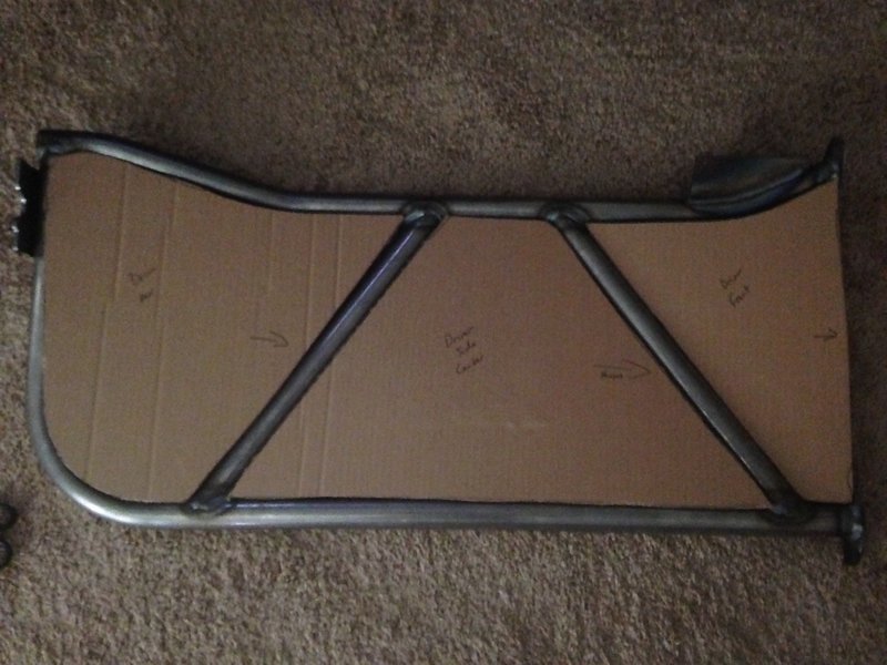

    I got the 4xInnovations tube doors and I plan on using 16ga sheet to fill in the triangle gaps so they are a little more closed in (for my wifes sake and to keep a little of the debris from flying in the cab when O/R). I know its nothing major like you guys are doing, yet, but I think its a good first project. so b/c of that, ive just been practicing lap and T joint and getting my rhythm down to repeat over and over again.

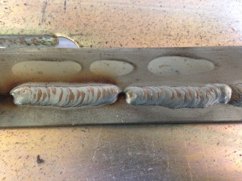

    The biggest thing I noticed was my beads look a little raised, more so than the 100's of welding videos ive been watching on youtube, and im not sure if its speed too fast or amps too low? If I go by sound, its making a nice bacon frying sound, but then again my ear isnt quite as dialed as it will be with more practice.
    The penetration seems good and the beads are somewhat uniform so, I just gotta keep at it, thanks for the input.

    The beads look raised a bit to me as well. Try turning down the wire or raising the heat. One or the other will get a flatter weld.

    Looks like you just need some practice. Good start though!

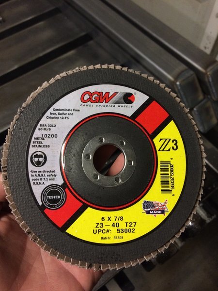

    Those look pretty good but doesn't look like they have 6" flap discs:(
    I've been using Camel's for a while, good price point for a decent amount of abrasive material on the discs. Made in USA too :thumbsup:

    We get walthers flap discs through work at a super cheap price. Flapper sand cut offs. We are experimenting on hard discs to see which last the longest

    doors arrived. Ive cut the templates and just got the 16 ga sheet metal to trace and cut yesterday. we'll see how this first project goes!
    --any advice for MIG welding 1.25" x .120 HREW tube to 16 gauge metal? My concern is burning through the 16g tryin to get penetration for the tube metal???

    Watch this:
    https://youtu.be/TAUOeSIsHf4
    The trick i to concentrate your heat on the tube and push your puddle into the thinner sheet metal quickly. Try a 2:1 count. (2 seconds on the tube and one second on the sheet metal). If you have anything on hand to practice this technique, once you get the timing down, it becomes really easy. Weld in small stitches and move around the panel rather than a straight line so you don't warp the sheet metal. Your template will get all wonky towards the end if you warp anything.
