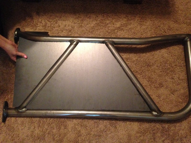

    Thank you. I actually got a lot of the same measurement tube just to practice with the extra sheet metal. I cant afford to "pratice" on the actual doors haha. Thanks for the input!

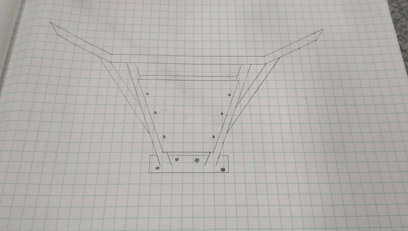

    This is how it looks on paper, gonna get the frame mount measurements and then make a 3D model.

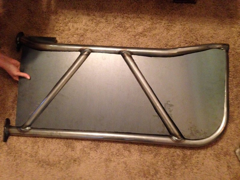

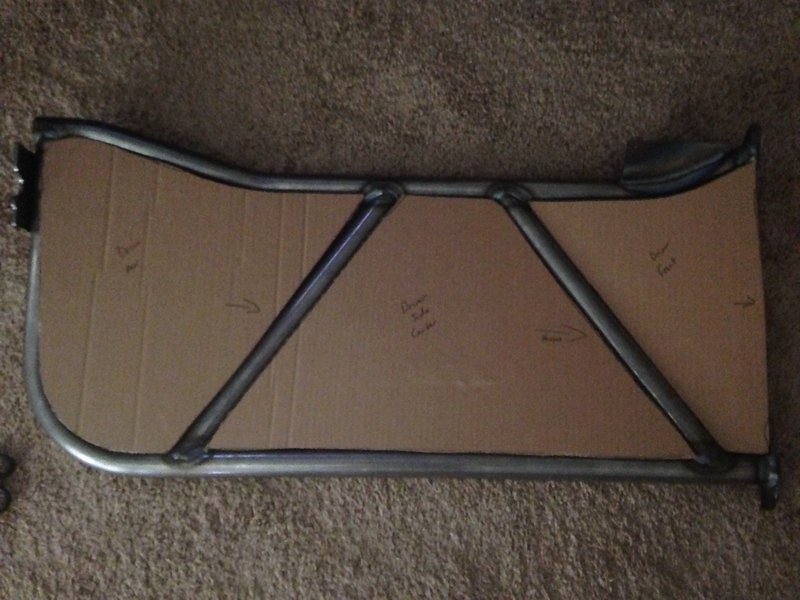

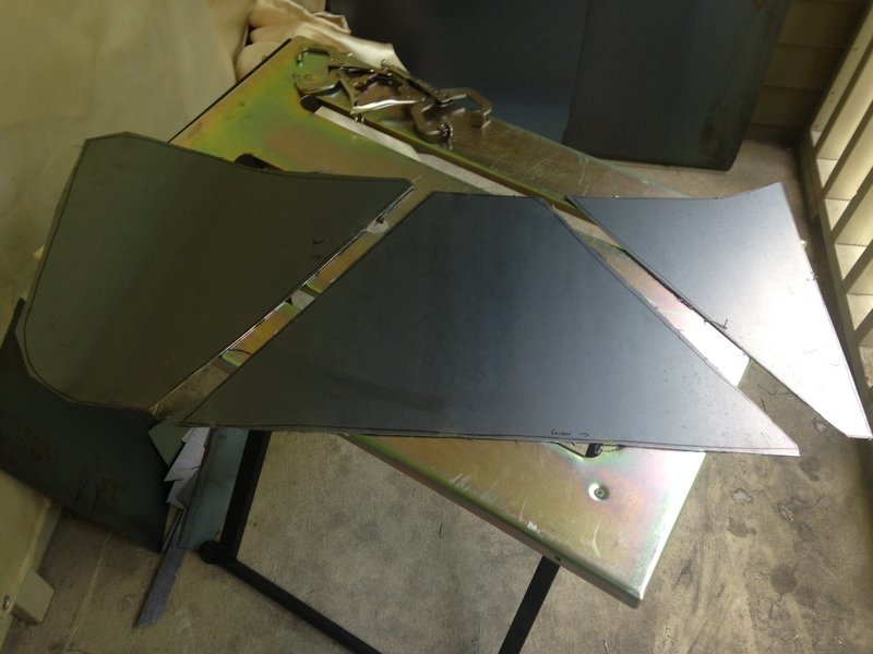

    although thats a great idea that I did not think of, I was committed to the welding since I liked the look regardless, AND its my first welding project for the truck haha
    got the driver side door done. once I mock these up with the passenger side, ill have WAY better templates so ill have to do less back and forth cutting/checking measurement.
    then just to weld

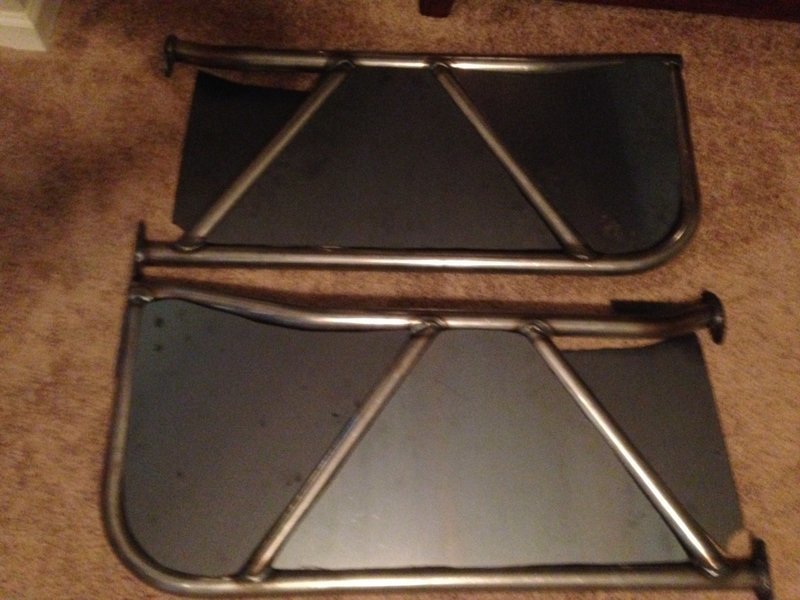

    both doors done. now just prepping/welding.

    So did you think about doing the bolt on tabs or are you still going to weld the sheets in? Tabs would be an easier beginner project, IMO.

    im goin all in with the welding. i actually bought a welder and EVERYTHING that goes with it for this to be my first true "fabrication" project. I did not think about the tab idea until the other member said it and I def like the idea, but the look in my head when the doors are finished is what im going for...may be dumb but im excited for it, and I know itll be a marathon as I avoid the warping problem but thats a problem for tomorrow haha

    just make sure to move around the panel often. weld in one inch sections at a time and move to the opposite side and so on. If you have access to compressed air, it'll help cool your welds and the surrounding sheet metal as you move along.
