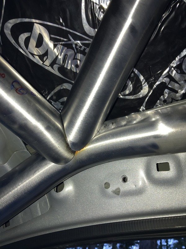

  17. Aug 11, 2016 at 8:36 PM
    #2157
    Basikbiker
    Basikbiker Well-Known Member
    Sep 21, 2013
    #112968
    3,986
    Trav
    09 AccCab 4x4 spaceship
    My doors are the only stock things left besides the headlights
    Gettin the hang of this tube notchin thing
