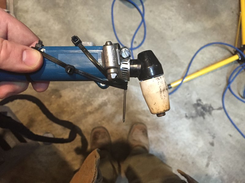

    Redneck plasma cutter tricks.
    I fully intend on building a true circle guide for my plasma cutter, but haven't gotten the time to yet. so when I needed to cut a circle last night, and didn't have the correct size hole saw, the inbred side of me got to work. two hose clamps, a few zip ties, and a small trim nail later, and perfect circles were possible. secure the nail where you need it for the proper radius of your circle. drill a hole in the center of your circle. stick the nail in the hole. pull the trigger. spin the torch. drink beer.

    I definitely pictured someone one handing the plasma cutter while shotgunning a beer
