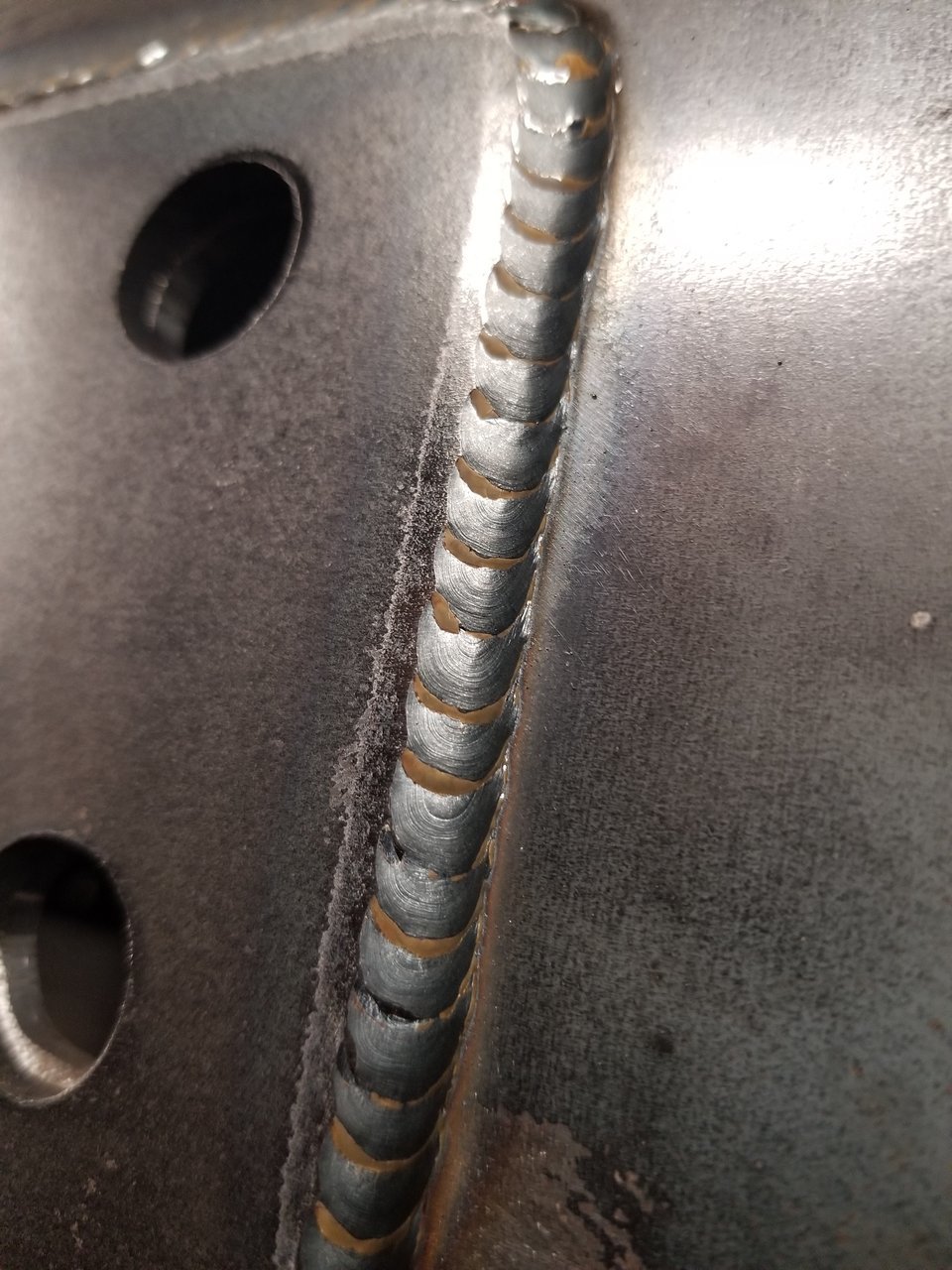

    My brother picked up a Everlast 164si

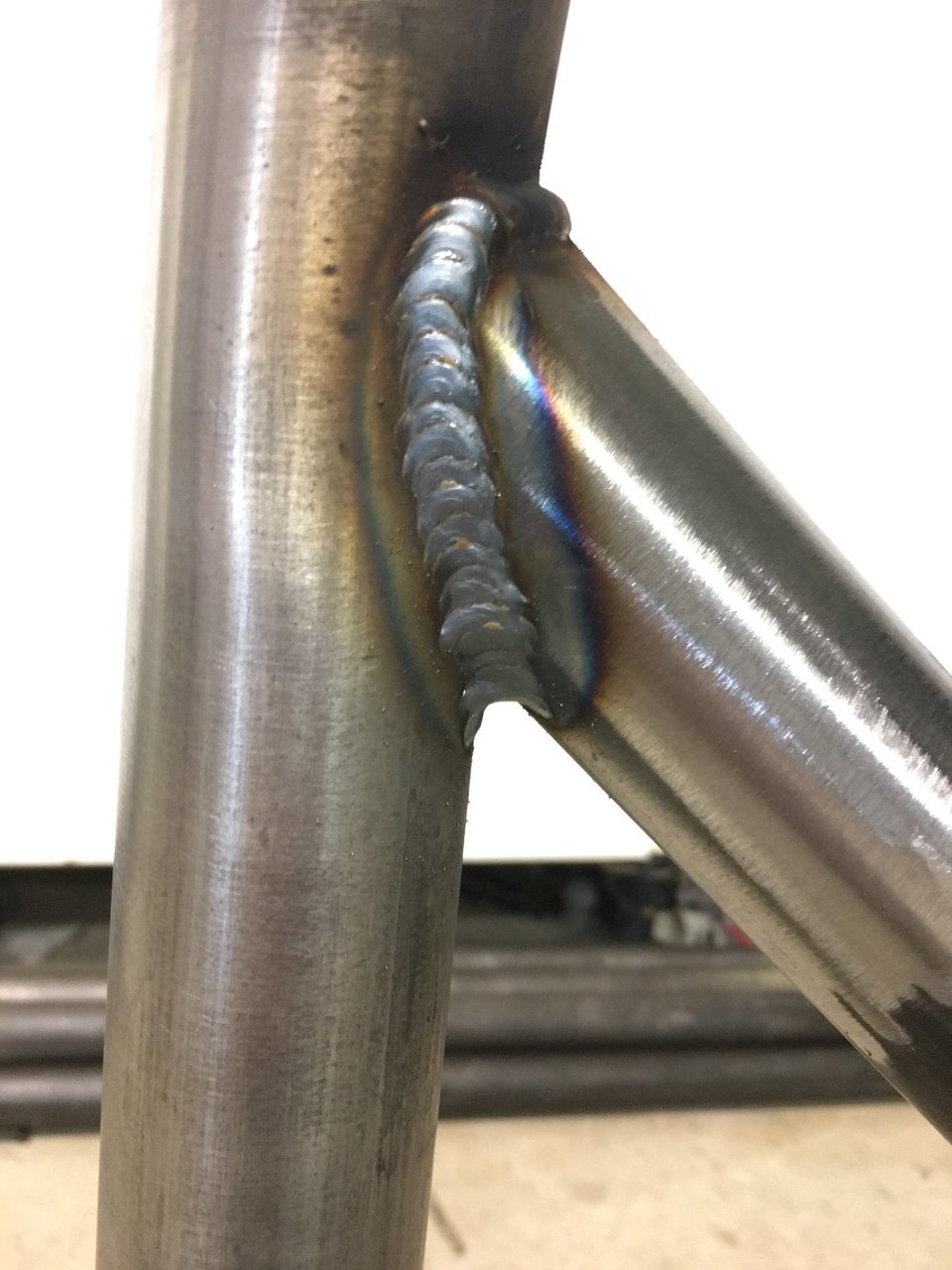

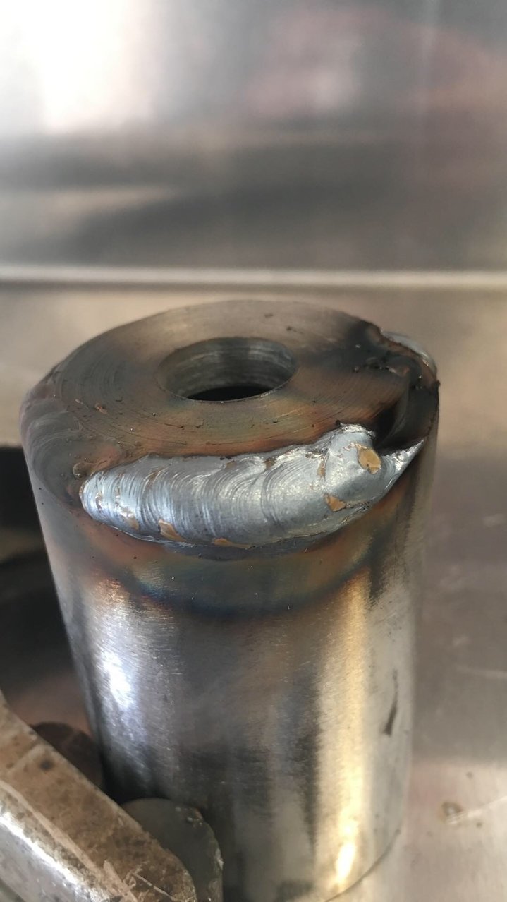

    This is my first time tig welding so go easy
    1-3/4x.120 DOM 1hz
    :anonymous:
    Epic3rdgen and Dalandser like this.

    Run a double pass and it'll be perfect

    We are just ducking around for now. I have a buddy who can actually tig weld and he’s coming over to show some pointers.
    I’m thinking for that I’d also have to dial down the amperage and slow down? I have some bad undercut there.

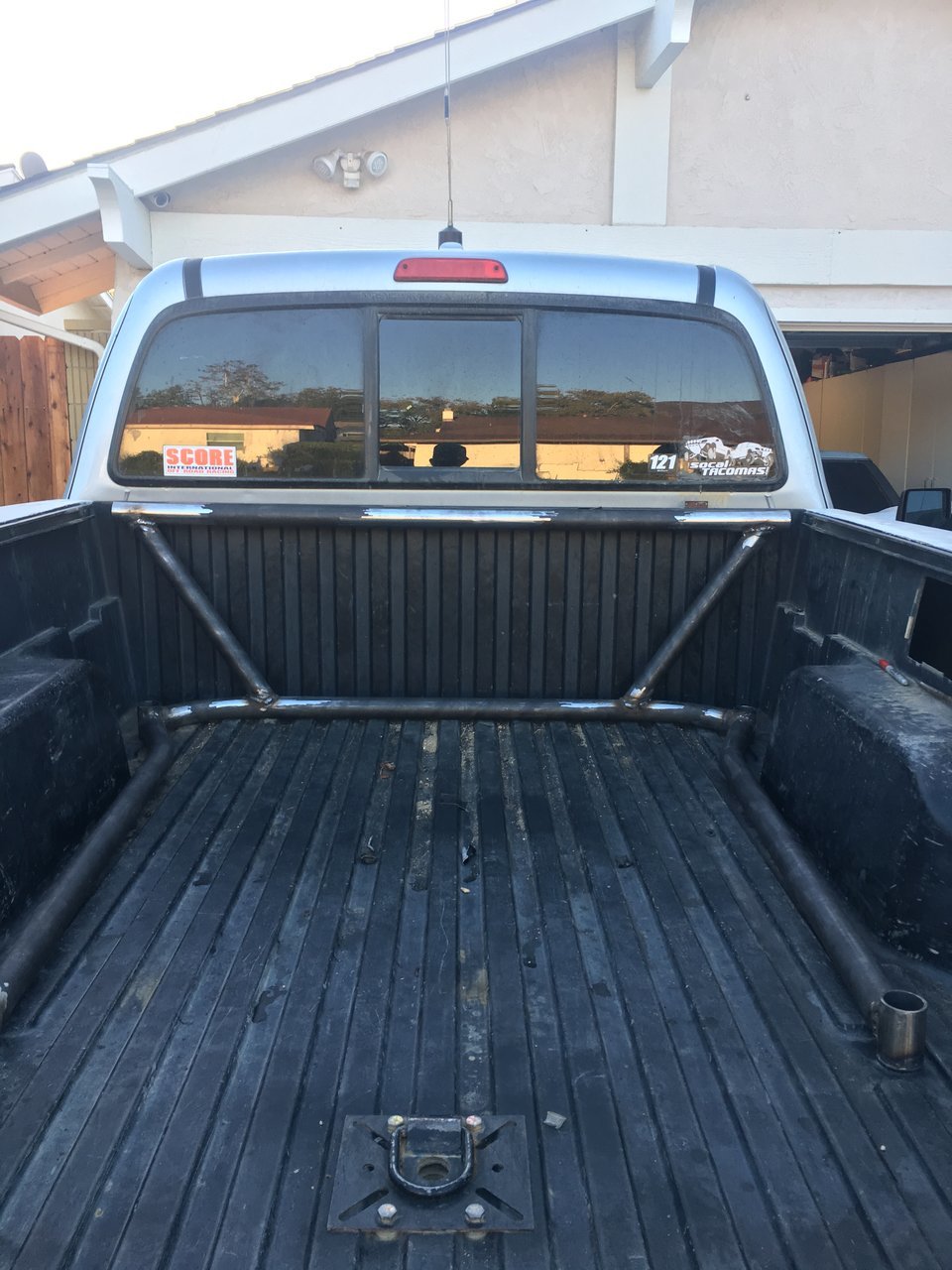

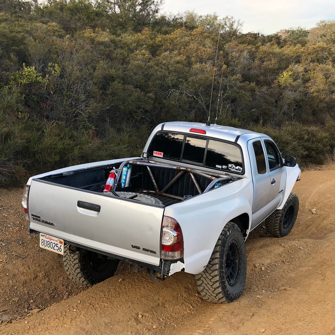

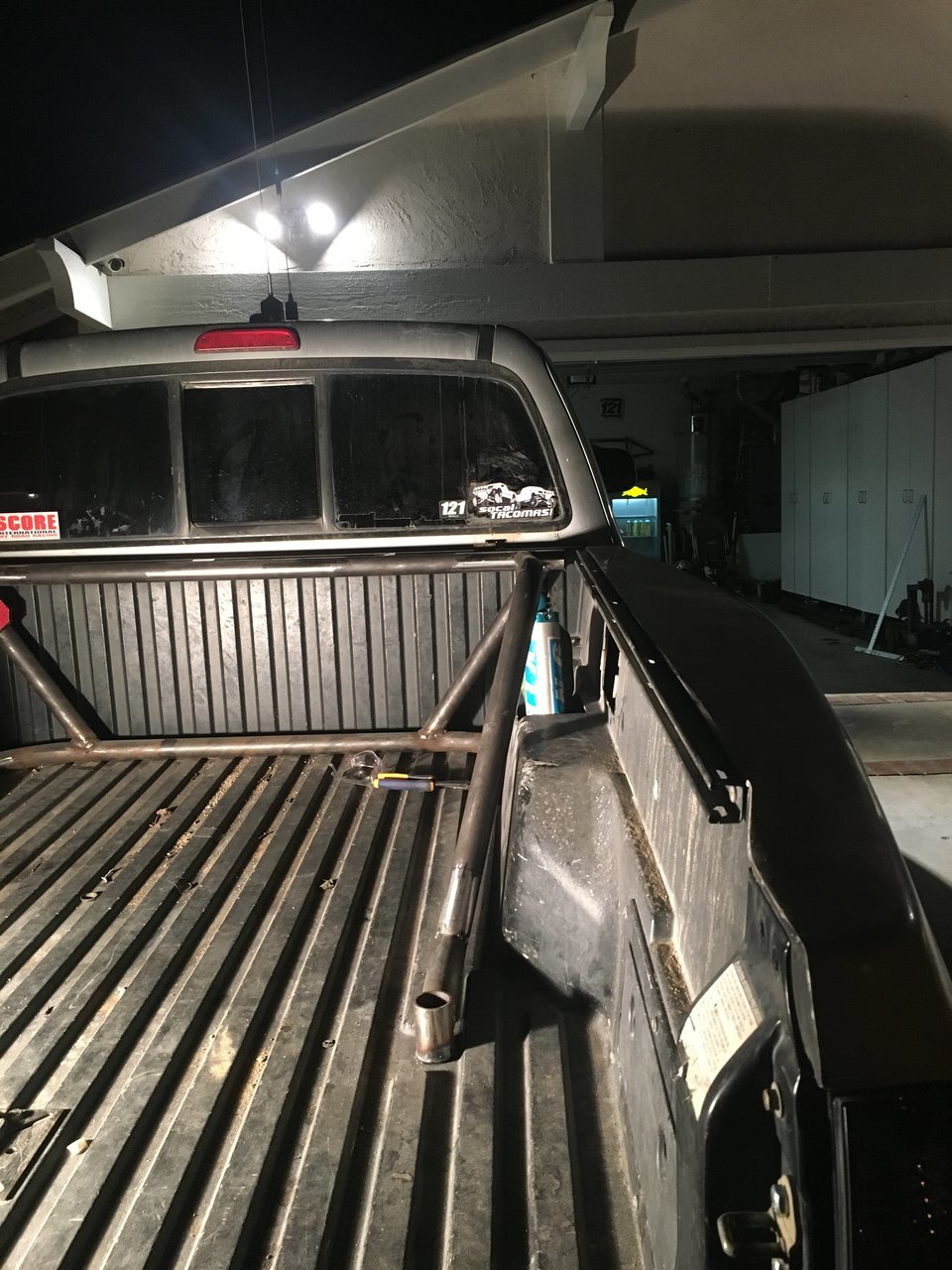

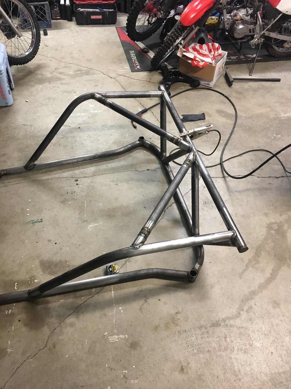

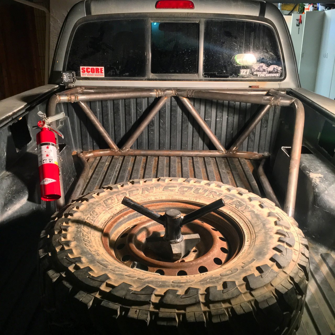

    Haven't been active in a couple months but been busy knocked my bed cage out over the past week just waiting on getting my shocks back and i should be good to go. This is my first time building a bed cage pretty happy with how it turned out.

    Slowing down adds heat when TIging turn the amperage down and add more rod
    Usethe2nd[QUOTED] likes this.

    I would guess so he can fit the dirt bikes in there I saw in on of the pics. removable bars for bed space when needed.

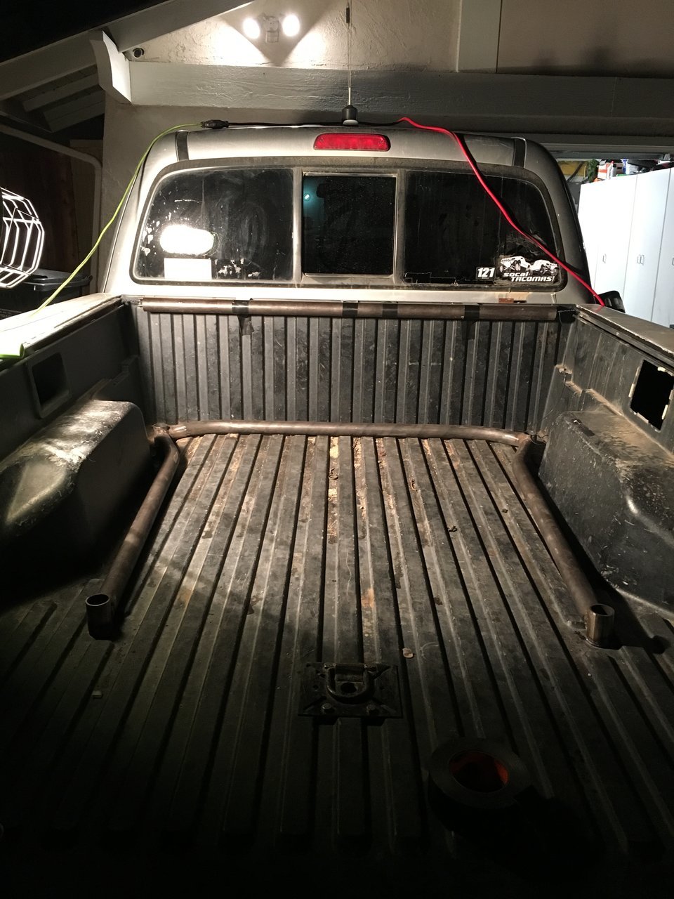

    Running 16s through the bed to a 12 leaf deaver pack for the time being. Just got my shocks back yesterday so still need to finish the shock mounts. After the holidays i plan on installing the Giant 64" kit. Not sure if thats what you were asking

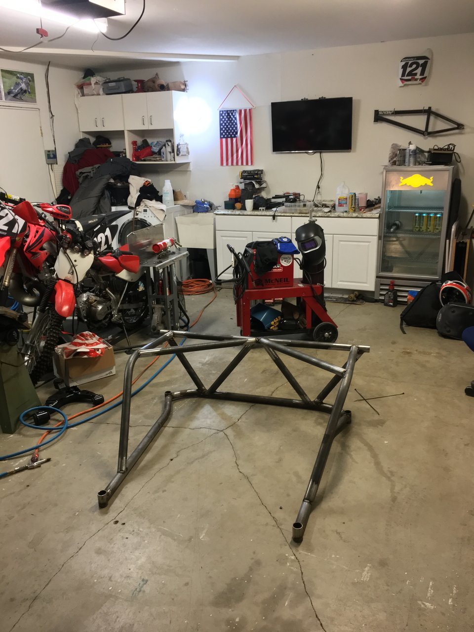

    After looking at how much money I can save by making my own bed cage and maybe welding in some front shock hoops, I figured I'd get a tig welder. I've been watching weldingtipsandtricks.com and it looks like I could get the hang of it. I only have a 110 hookup currently (no pun intended), but it seemed it would be alright to use a 3/32" rod with 80-90 amps with both of these. Any feedback on either of these?

    I know I'll need a bender too - any suggestions? I figure I can use a grinder to cut until a deal on a saw comes my way. I read that people like band saws for cutting steel vs. a chop saw.
