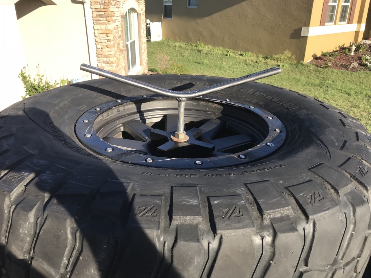

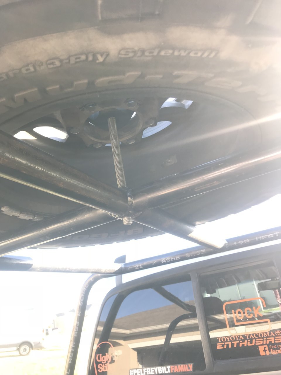

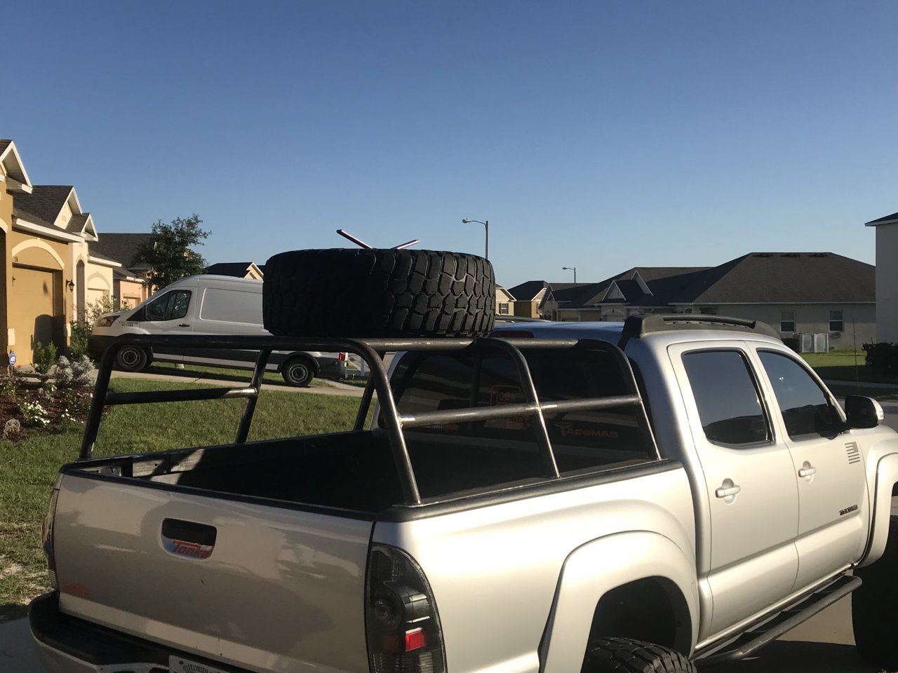

    Rack for a customer and they wanted a spare tire holder on top. So I got some 5/8 rod and a adjuster. Cut a hole in the main tube and welded it in. Ordered the cone and bent up some .5” solid rod for a handle.

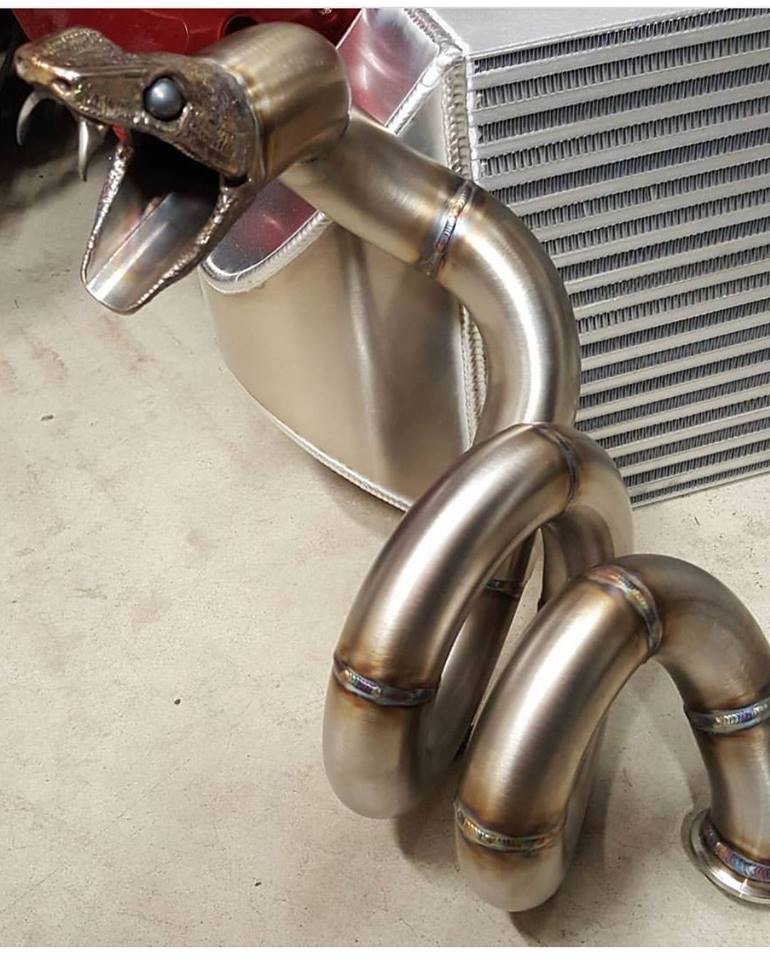

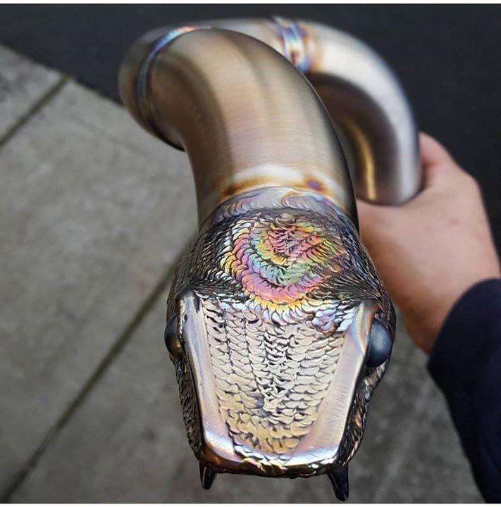

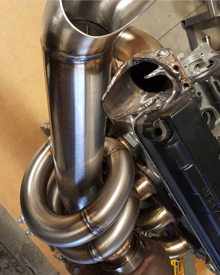

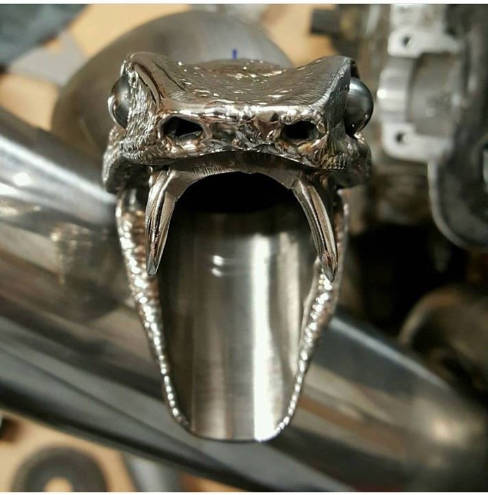

    Saw this on fb if anyone thinks they're good at welding.

    Hat is tipped to that artist!

    That's bad ass

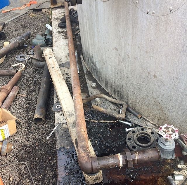

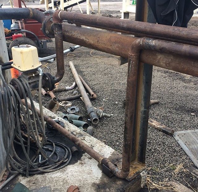

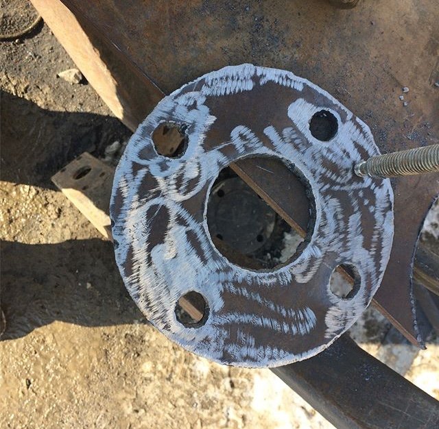

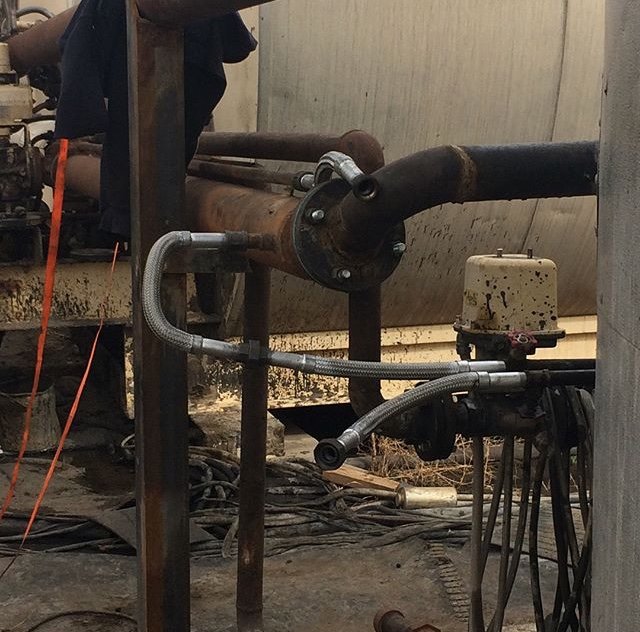

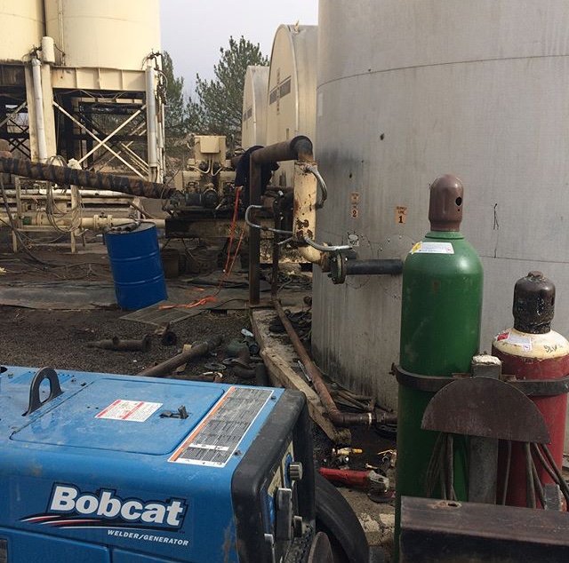

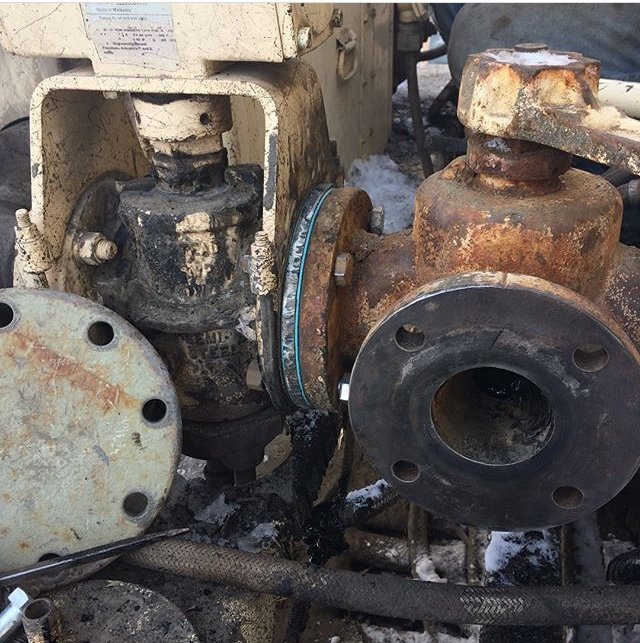

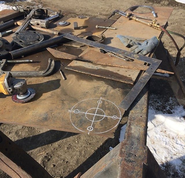

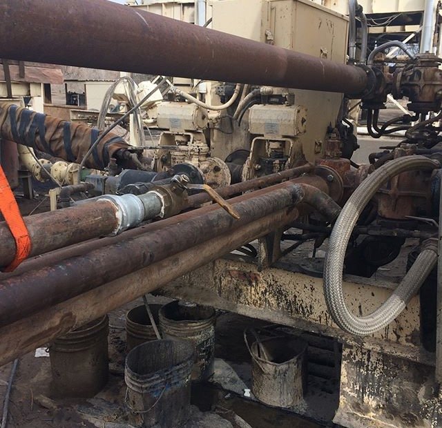

    Some of the things I do at work when I’m not operating my front end loader. I get tasked to make something out of stuff from our bone yard. I had to tie in the third oil tank for the new season. I had to build new flanges, reduced flanges, spacers, tied in all the 2” pipe from scrap pipe. Everything was pressure tested. I’m not a fabricatior by trade.

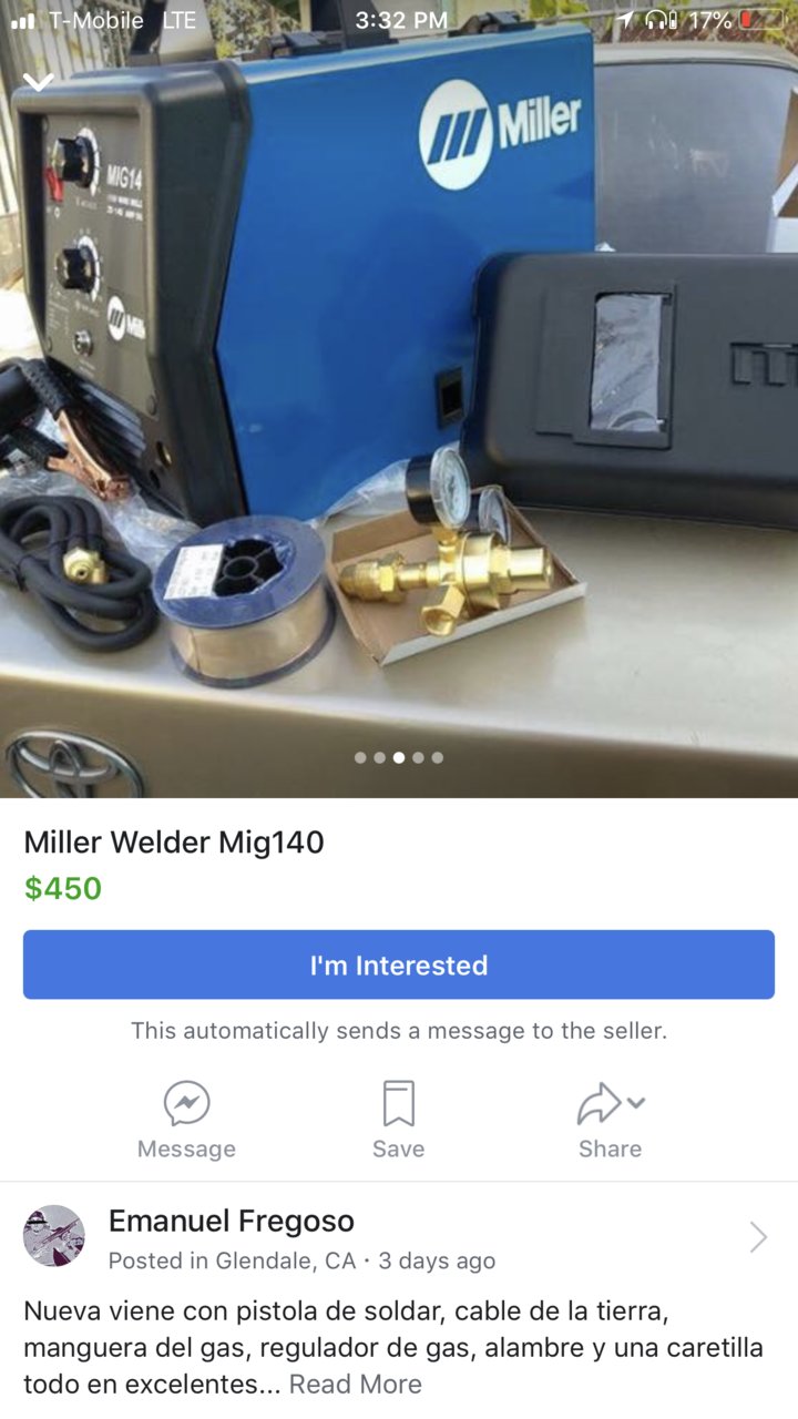

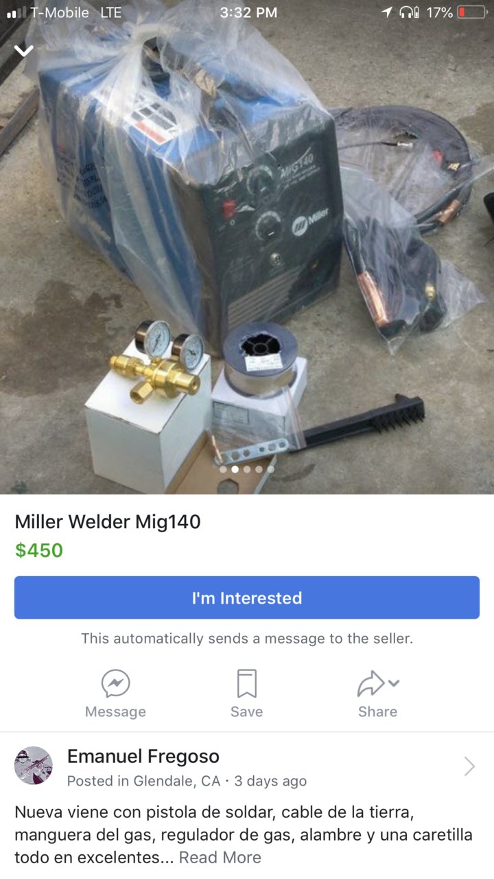

    Their are a bunch of fake 120v Miller machines floating around all the sudden. If you’re familiar with miller they are pretty easy to spot. They look like a harbor freight welder dressed up like a The cheap miller welder is the miller 125 hobby.
    Here’s a fake for sale locally. One of the guys that subleases part of our shop accidentally bought one off Facebook. It was junk. He had to buy another genuine miller.
