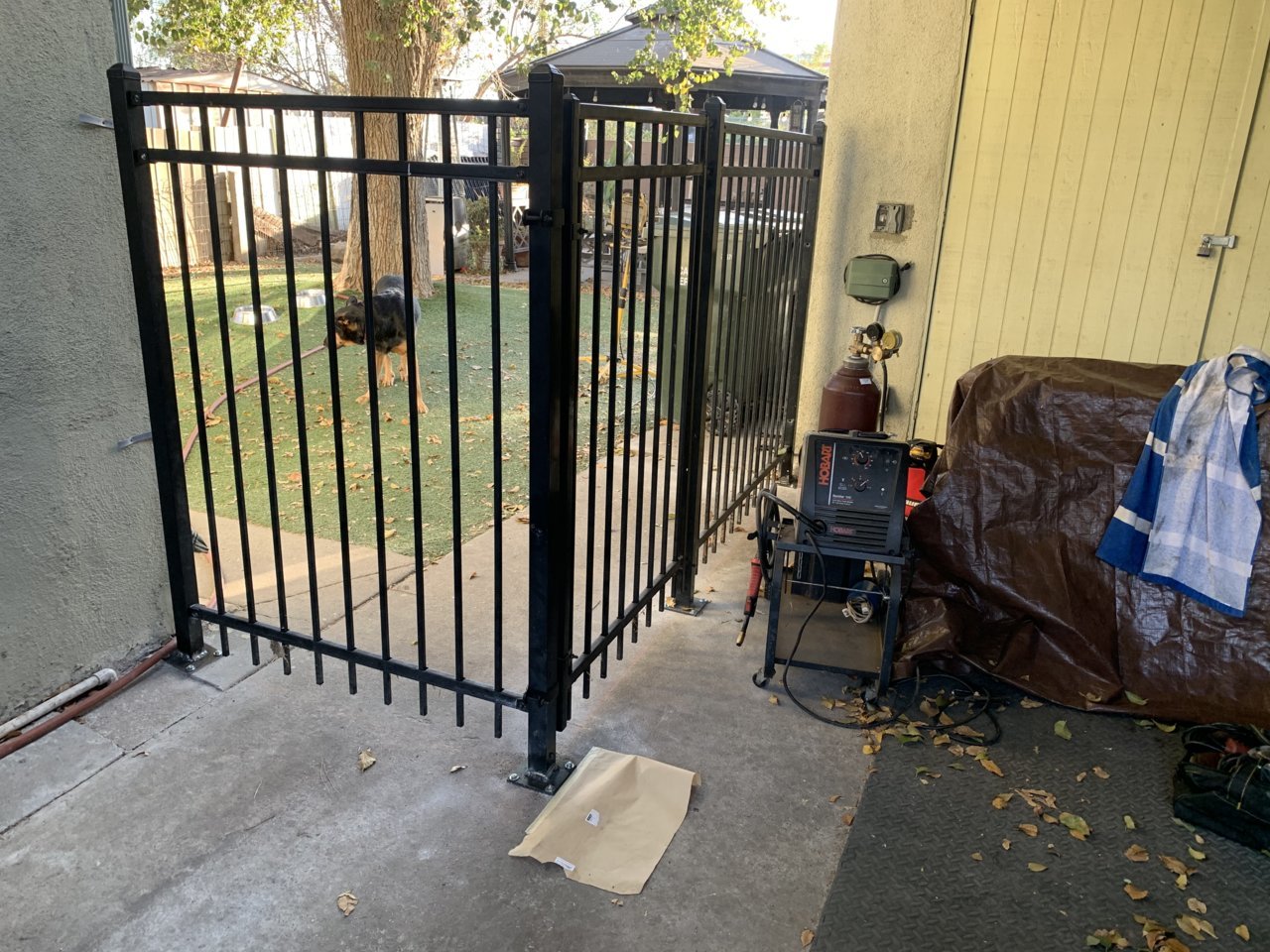

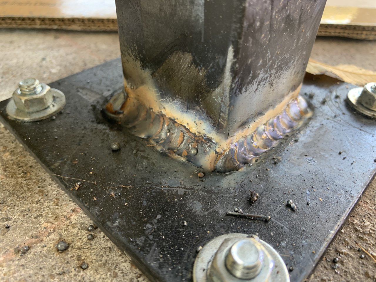

    Like @snowsk8air2 ’s table not as fun as truck stuff. Welded and built a fence out of spare parts for my landlord that lets me keep a bunch of tools and stuff at his place. Dogs needed a fenced off part of the property. Got some porosity in places probably from not enough paint being removed but it’s enough for what it is.

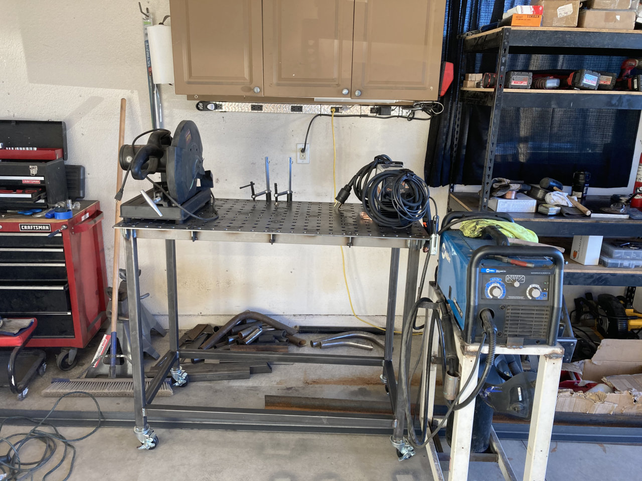

    Certi-flat weld table being added into the garage shop. Gonna be a nice addition. Gonna work on adding an extension for the chop saw to sit level with the table top on one side and then the welder/ plasma on the other as well as a few other misc additions to make this the ultimate little welding/ fab cart

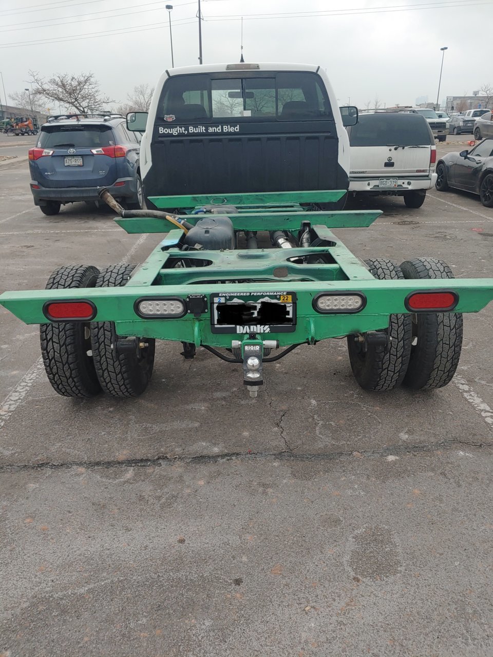

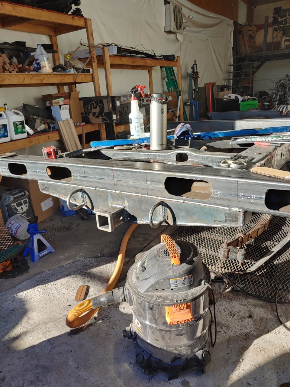

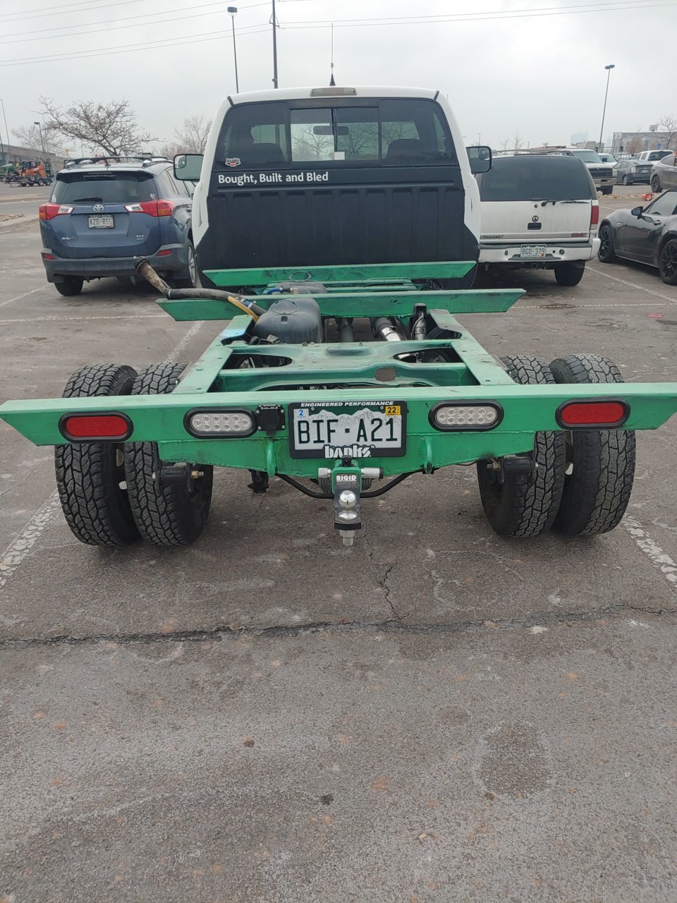

    Made a bumper for my truck, along with mounts for the eventual camper shell I am going to build. All the wiring is hidden in the bumper pretty stoked on it.1208201406a_HDR.jpg 0217211229.jpg

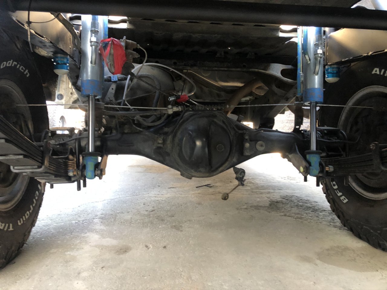

    I’m looking to swap in a tundra axle in the near future and am planning on putting a back brace/truss on it, specifically the ruff stuff 9” truss. I’m happy with the bed cage setup I have so I won’t be trying to mount the shocks outside the frame rail-my question is will I be able to weld shock mounts to the truss itself? Or is that not a structurally sound place? Thanks!

    As long as it’s 3/16 it should be fine. Even if it was 1/8 I’d plate the area for the shock mounts with 1/8 and weld it to that

    The RS truss is 1/8" which is kind of the same thickness as the material in the frame almost as thick as the axle tubes but I'd tie the shock mount into both the tube and the truss if not only the axle tube rather than going off of just the truss if possible. Are you running shocks in or out of the frame though - that might make this an easier question to answer.

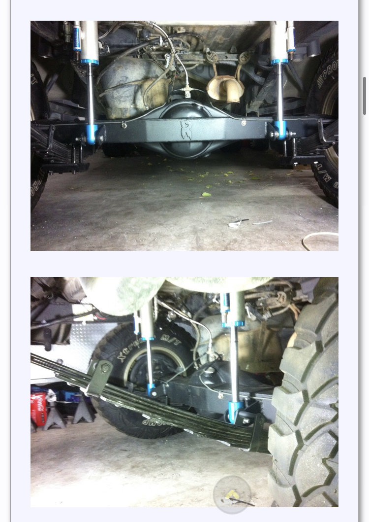

    This is the only pic I could find anywhere that has shocks mounted to truss and just so happens to be a tundra axle and same setup lol...for reference...but I’m guessing this is beefier than any 9” truss available out there

    You could ask @RelentlessFab how thick his truss is - I was thinking your shock mounts were outside the frame. You could weld in some bracing inside the truss or landing pads to spread the load.

    that was cut from 3/16" sheet

    Right on thanks for the replies, I was just trying to visualize it all than came to discover it’s not a common setup, which than had me second guessing it

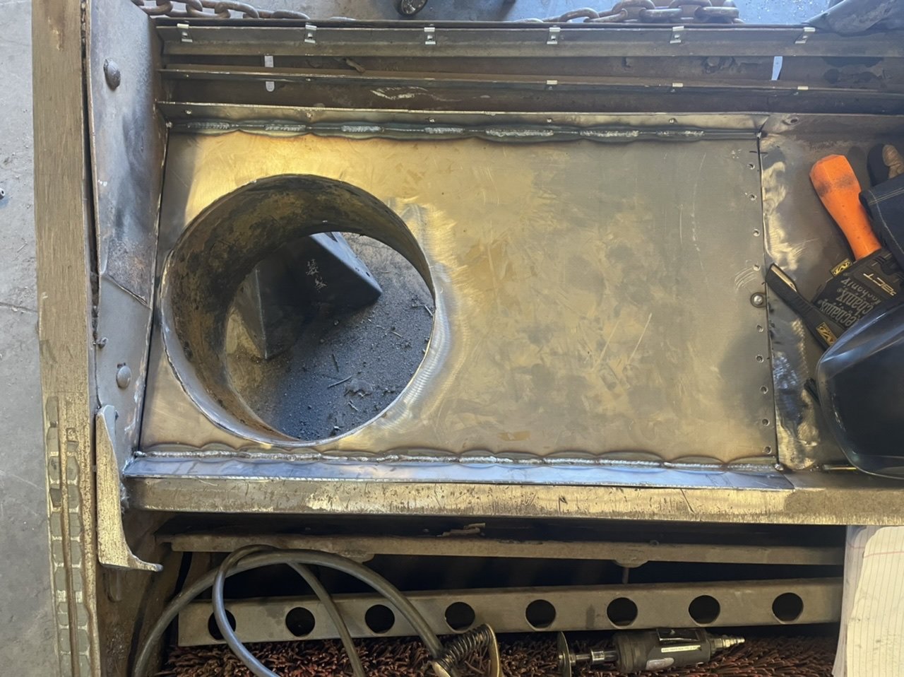

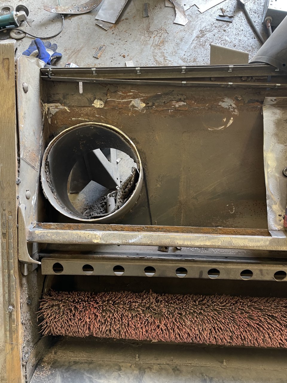

    Rebuilding a sweeper deck at work
    E90DF45D-9350-4A0B-89C4-B4D1DA4A04B9.jpg 995A2B4B-A3DA-499F-8CE8-DBCF5274093E.jpg 546BC970-BF9C-47FD-8536-A704832FB034.jpg
    Yeah, the bottom welds look like shit. This is a general use welder, so about 50 people have access to it. I could not figure out what was wrong with it until I realized that they had the wrong size selected for the feed motors. Feeding .030 wire through a .035 channel without realizing it makes you question your machine and capabilities

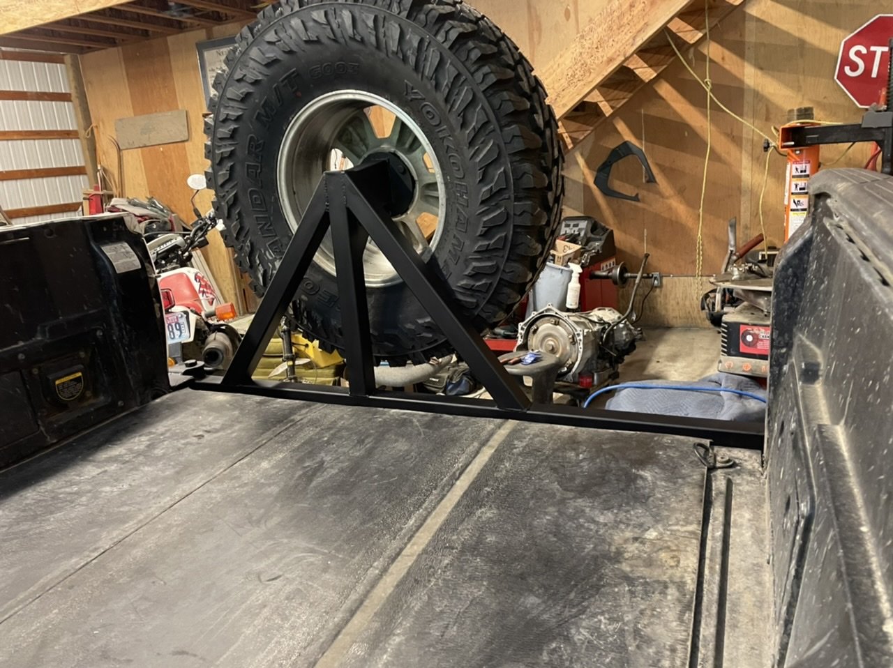

    also finished my rear swing out and completed my 63” swap
