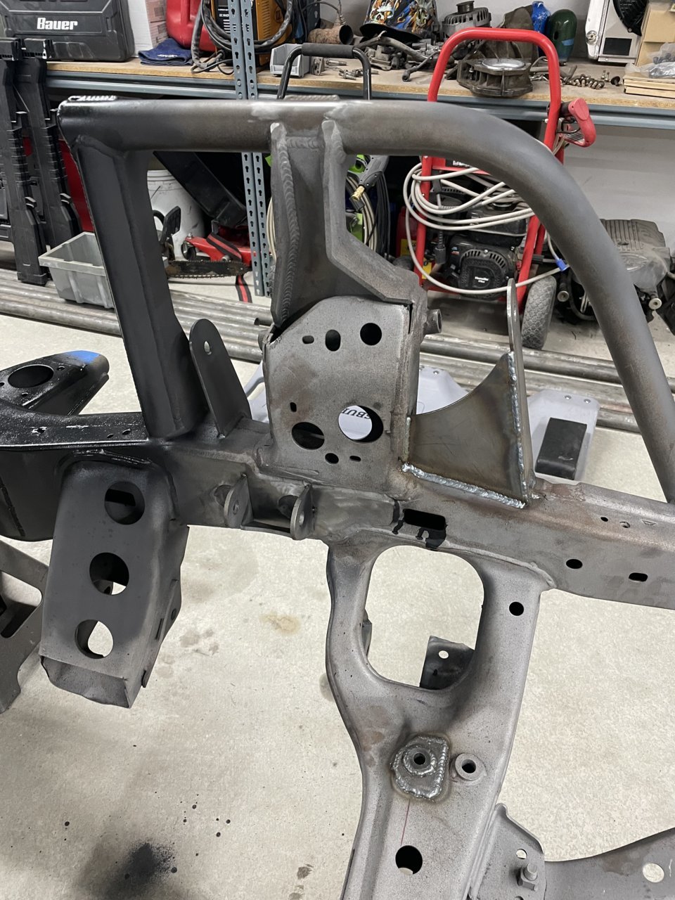

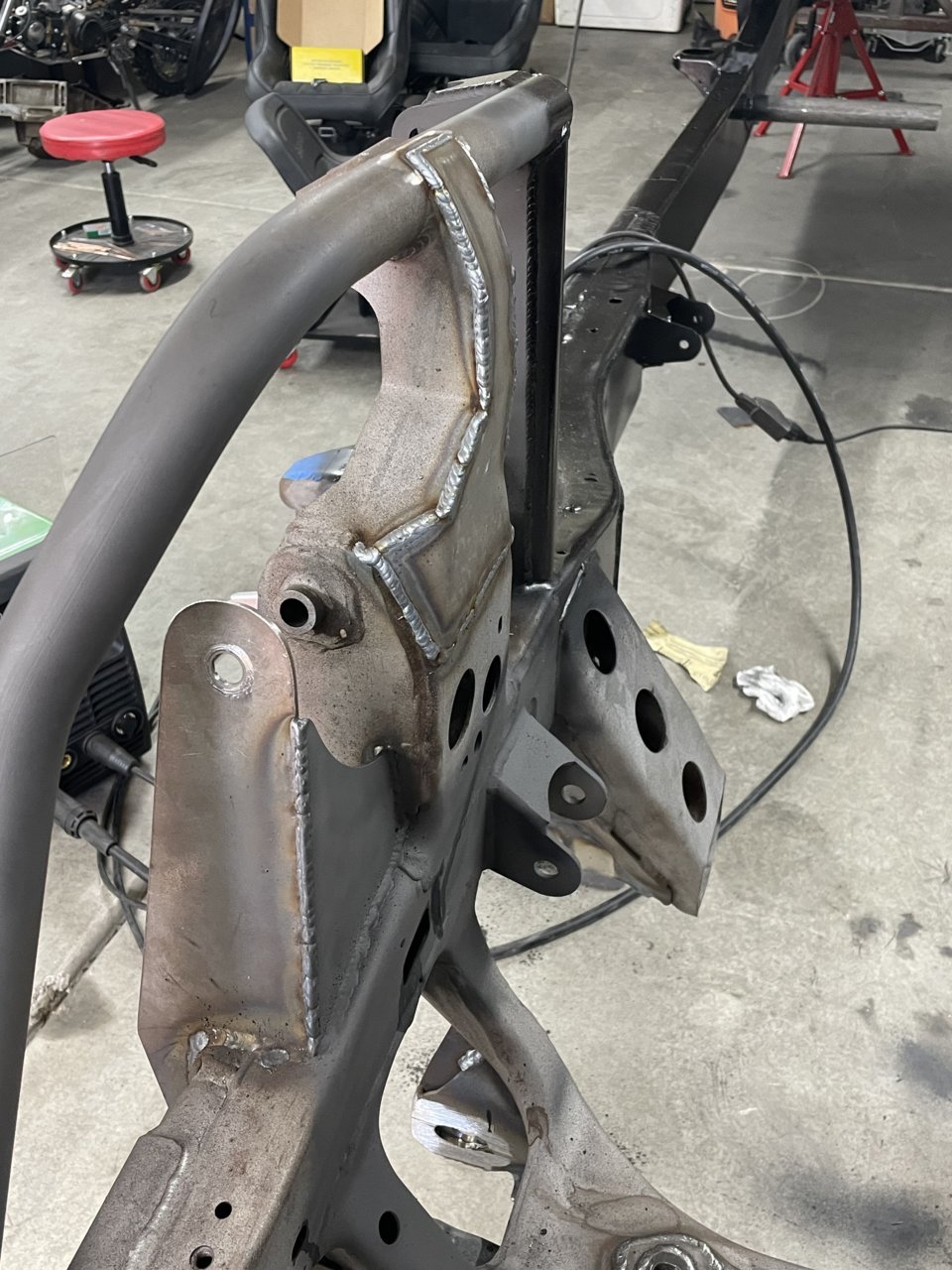

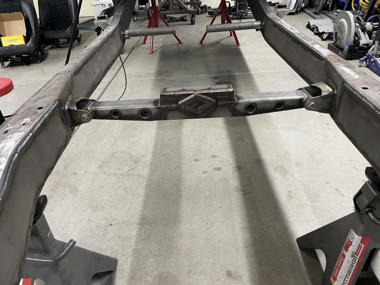

    Finished up new trans mount

    Those are very nice. The starter fits in there right? I did a set on a 3.4 and the starter didn't fit. Had to remake like an idiot.
    I should have made the LS mounts with a bolt but just didn't have the material at the time. They are actually off right now. Prob should change. lol. Your tigs look really good. I've official gave up on mig. Just looks like shit compared to tig.

    Same way I just have to use the small holes on the top of the frame instead

    Oh shit, didnt realize that was an ls..haha You goin 2wd prerunner with that frame?

    Yeah it fits, I had to redo the driver side already because it was in the way of my steering rack. TIG looks nicer but I gave up on it because it was taking to long and I only have an air cooled one. I had roughy 50’ of welding to do on the frame plates and I switched to mig halfway through and took about 1/8 of the time. I have my buddy do most of the tig stuff at his house with his water cooled torch.

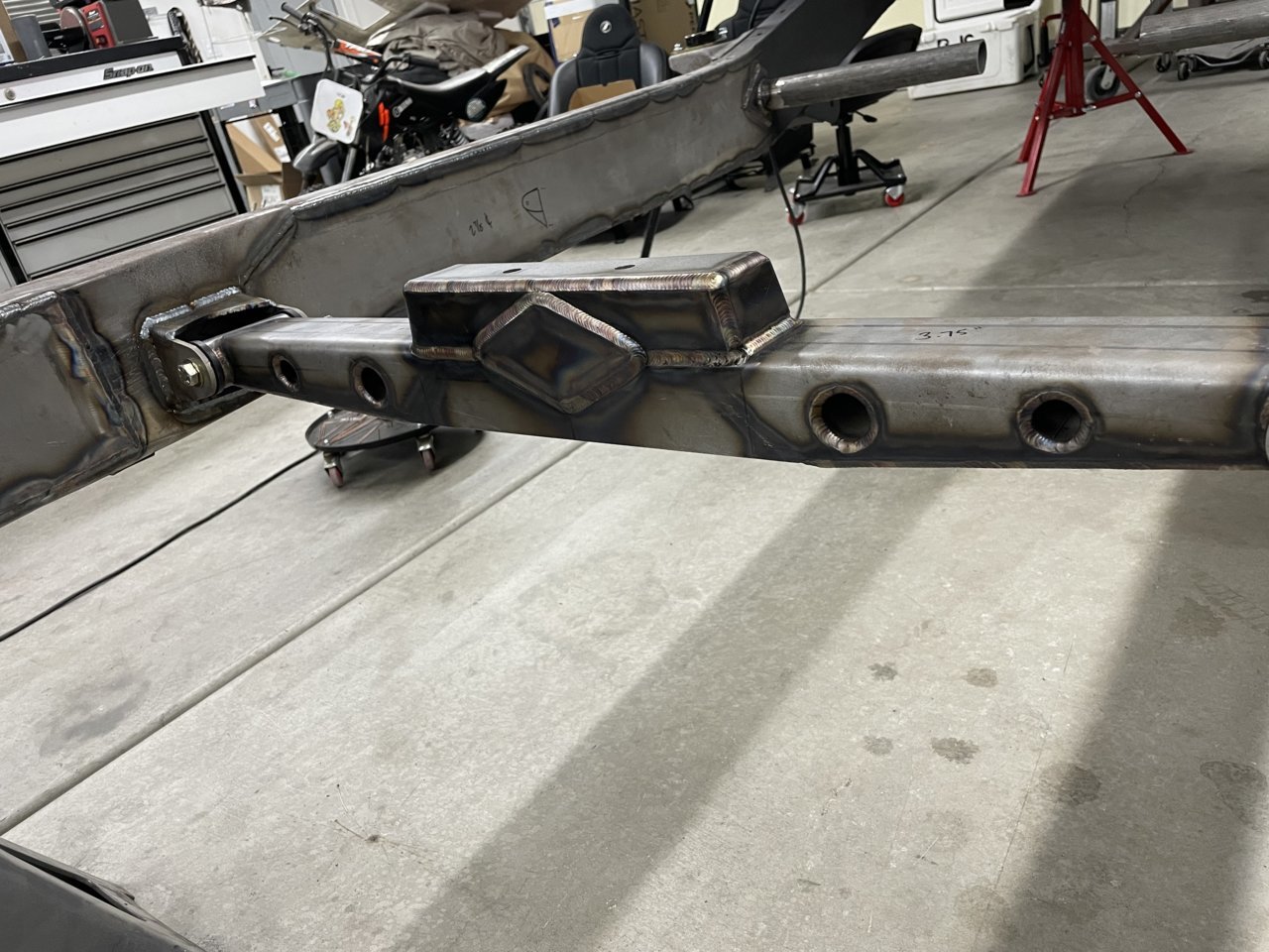

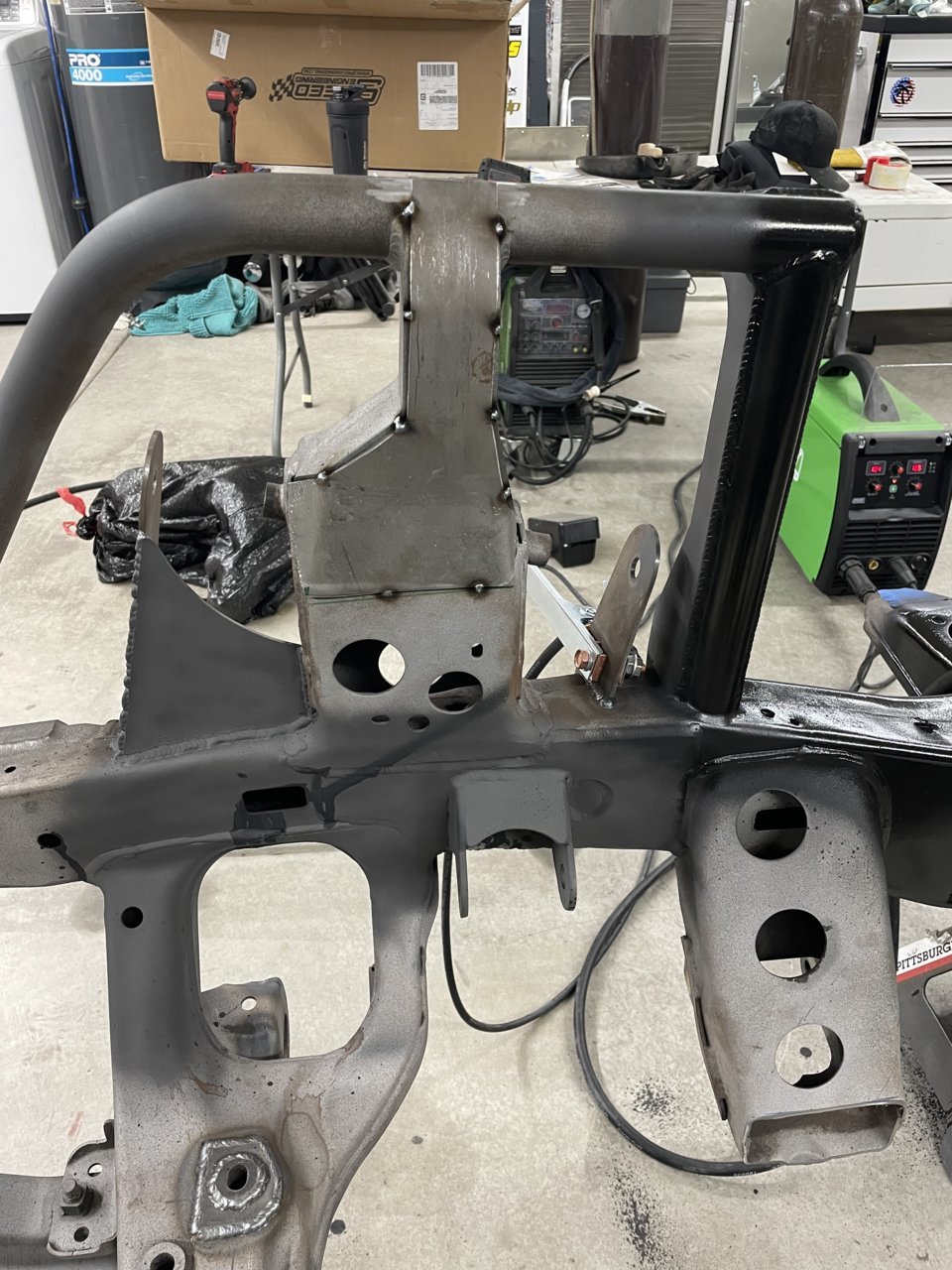

    Some caps to clean up the backside of the Solo shock hoop

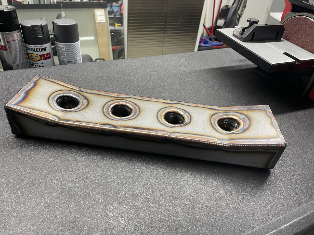

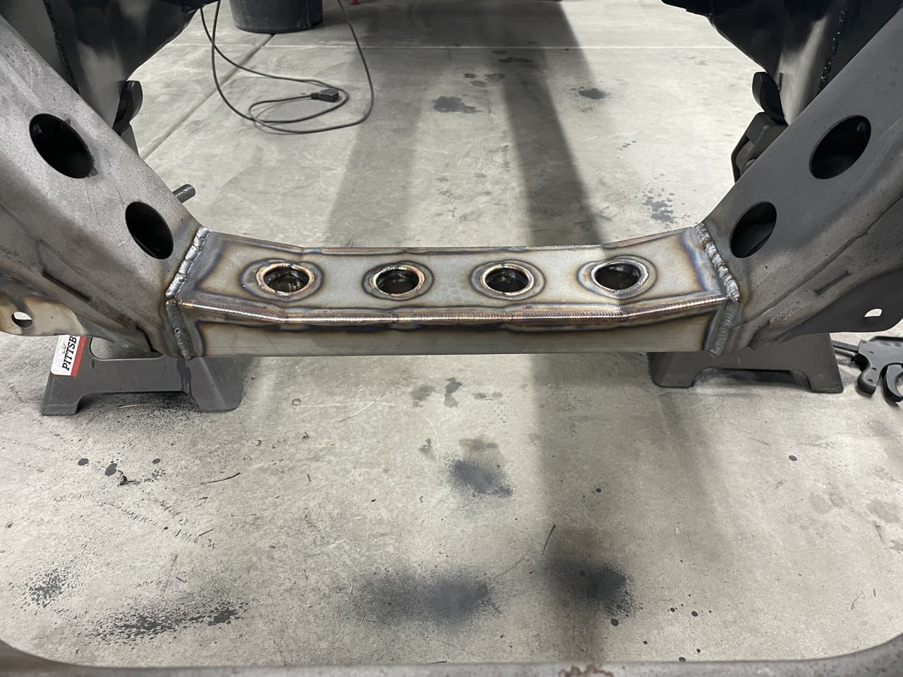

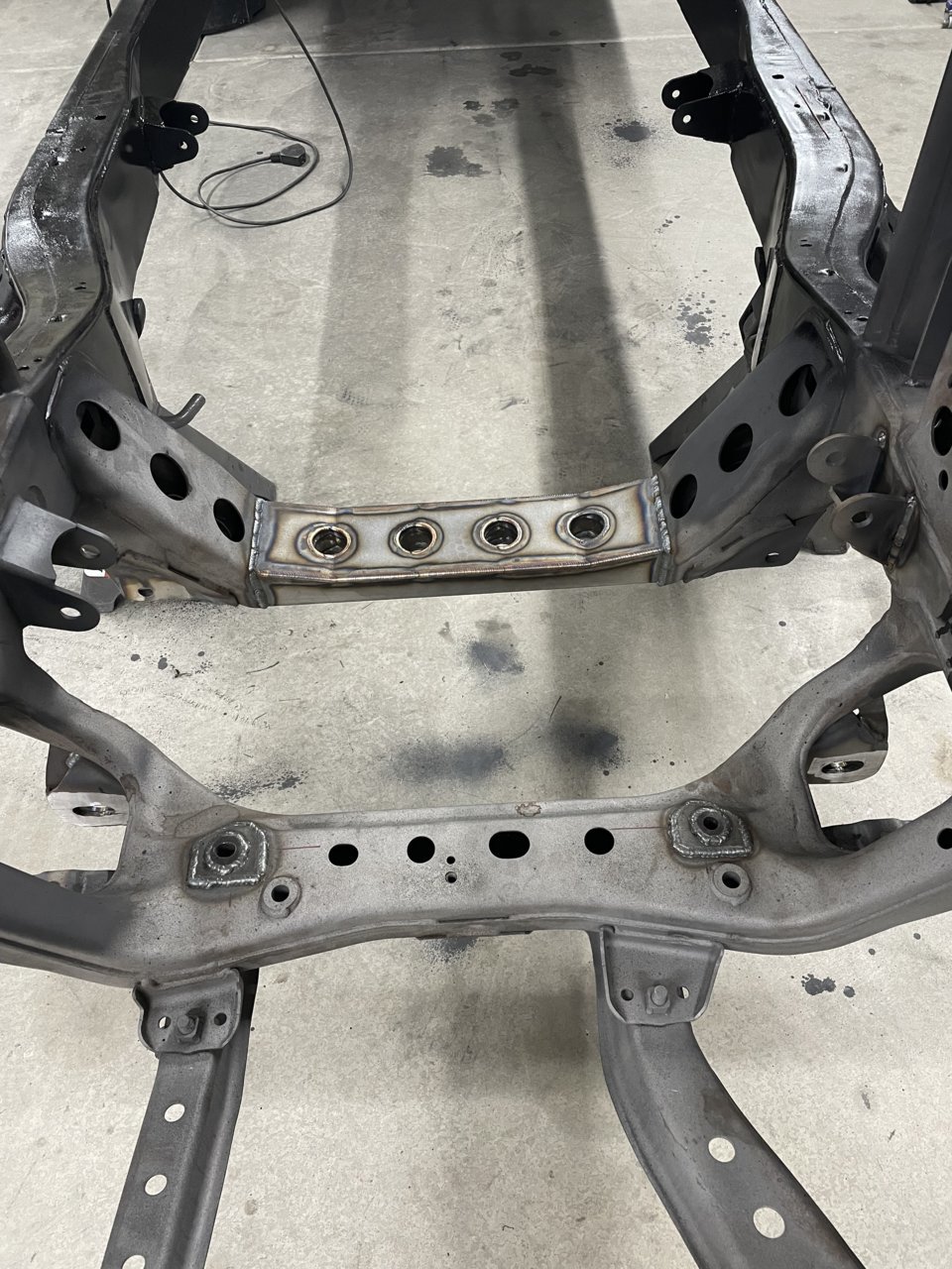

    New engine crossmember built

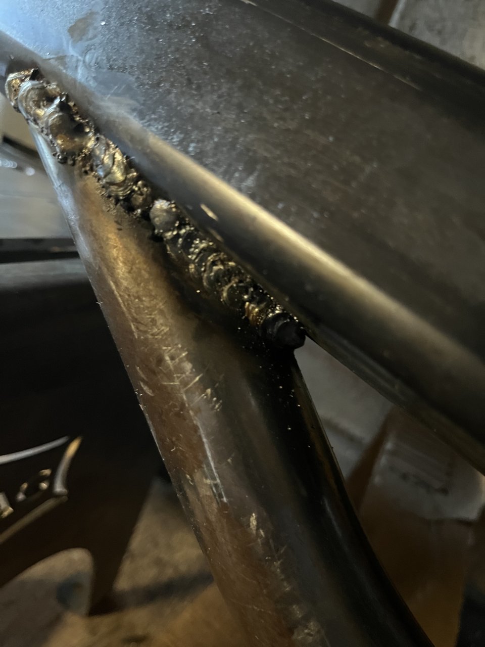

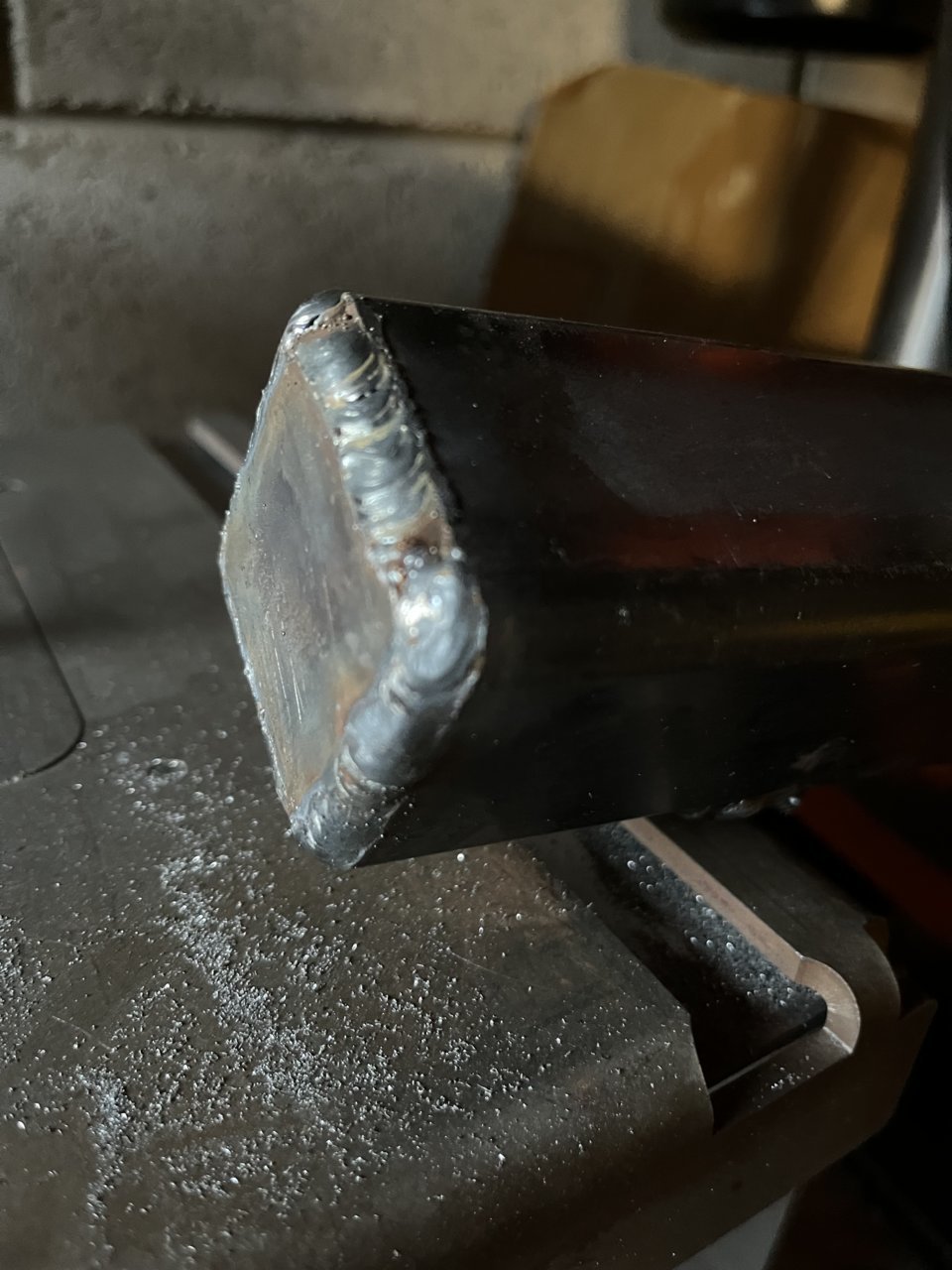

    How can i go from nice welds to shitty welds
    Hobart 180
    Smaller 10lb tank
    could it be low pressure on the tank?

    Turn the valve all the way open. No wind and make sure your at 25-30ish on the regulator. Lots of spatter so make sure your settings are right and the polarity is set for solid wire

    Welding on metal that isn't clean or no shielding gas are the first two things that come to mind. Were you inside or outside? A draft of wind could blow your shielding gas away and cause this issue.
