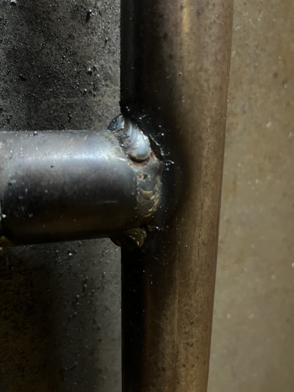

    @orbot those welds do not look at all like shielding gas is the issue, they look more heat related. I'd be willing to bet that if machine settings havent been touched from the 'good' to 'bad' then wire feeding issues is the culprit(therefore making things too hot). I bet you are seeing long wide arc cone and a lot of crackle/pop when trying to weld..... yes?
    Check to ensure the contact tip is good and wire feeds free (easiest to unscrew it plus feed out a few inches of wire and see if there's any resistance when sliding the tip up and down the wire by hand), if the tip is good then make sure the welding gun lead is as straight as possible. A kink/twist in the liner will lead to feed issues. And lastly ensure theres proper drive roll tension on the feeder. Too much tension on the rollers and too little can both cause issues. If all the aforementioned is in good working order, when was the last time the gun liner was replaced? If the machine sits around a lot the wire gets dirty/corroded while sitting and that will clog up the liner and add resistance in the feeding.
    Edit. I guess one more thing would be a loose power or ground connection either in the machine or at the ground clamp

    Good info! Thanks guys
    Learning on my own aint easy
    welds got better but have to get use to the gun angle only likes it at 90’

    @orbot do more prep, sand/ grind to bare metal, remove all rust and mill scale. Don’t necessarily need to wipe down with solvent for mig but can’t hurt

    Cleaned with wire brush but pic doesn't show it

    Clean the weld area and surrounding area with a wire wheel or lightly with a flap or sanding disc. You want clean shiny metal

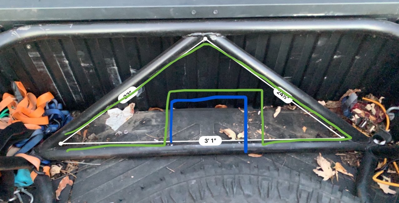

    Can you guys suggest a thickness and aluminum type for this. I’m going to send off to sendcutsend (thanks for this suggestion) but I’m not sure which type and thickness as I’ve never done anything with aluminum before.
    I have these two projects. First off these aren’t my “wheel wells” but I’m planning something similar. I’m going to cap off the open areas with aluminum plate and mount various items off of it. So it needs a little thickness. I’ll be mounting the fuse box (with a support) some bus bars, hood struts, etc.
    Then in the rear I am going to attach this aluminum to my bed cage and hang my electrical stuff off it it. So a couple bus bars, switch pro, master switch, fuse block, etc.
    Thing in the bed will be like this. Ignore the measurements. I tried to use my phone and it didn’t work. Blue is the battery and green is the plate thing. Which might change depending on how much real estate I need.
    Forrest30419 likes this.

    from what you describe I'd probably do 1/8". decent strength but not overkill and not strictly cosmetic.

    Thanks! Sounds about right. Not up to some of the stuff you guys are building but I’ll post it anyway once done.

    yeah i would say 1/8 is good, i made full removable panels for my wheel wells and did it out of 1/8 and then bent it to fit where i needed, than powder coated them....just cut it all out now to go with a full engine cage but oh well
