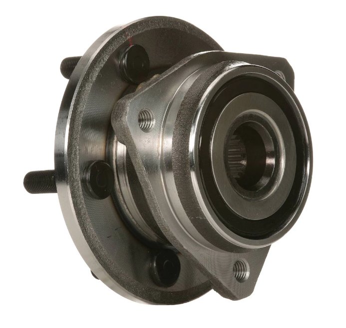

    I'm working on a design for a cantilever rear. I want to use some jeep bearing assemblies to pivot the lever around. My concern is water. The bearing looks sealed, should I do anything extra to protect it from the elements? I'm planning on leaving the splines exposed. I'm in Colorado so there isn't a ton of water here.

    Why not a dana hub? They're easy to find, service, are sealed from the back with a dust cap etc.

    I don't know a lot about dana other than they came on just about everything. The hubs I have were for a 2006 Rubicon which I though was a Dana 44. Either way, I already have these collecting dust in my garage.
