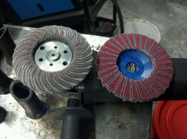

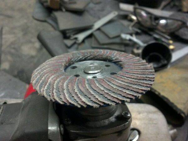

    I got the 60 grit yesterday and they work like a flap disk should. I wanted to put one to the test so I blended the welds on 3 skids. Took a little longer then my 7" but I wanted to see how well they lasted.
    The only thing I didn't like is they are not threaded so you need to use your arbor clamps that come with your grinder. And it sticks way out limiting how much you can use the disk.
    So is what I did was grind down the one from my flat sanding disk adapter and now it is perfect.
    Here is a side by side of a new one and the one I used on 3 skids as will as other things around the shop pretty good life if you ask me.
    In all they are a hell of a deal for 1.19 each and if they are that price again I will be buying 100's more but for now I've got 200 to use up :cool:

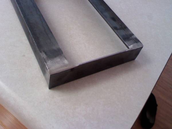

    Jlee, what do you mean when you say you blended the welds?

    it looks like this
