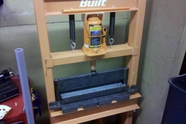

    I have the shop press and i love it it's well built for the price. But I've done some upgrades I bought some 1.5" rolled steel arbors to replace the cast widow makers. And I'm going to get the Air/Hydro 20 jack so i don't have to pump it so dam much. Also I picked up THIS to make bends in plate steel and it's well worth the money.

    I like that one
    looks much nicer than mine but it get the job done [​IMG]
    12 ton press bending 3/16th no problem

    nice, hf press it is. always nice when the less expensive stuff works.

    Yeah this is my setup.
