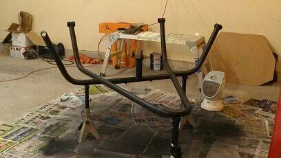

    So been working on this for the father in laws Jeep. What do you all think it will hold up to 40's?
    Bedliner paint drying.

    What kind of bender do you use John?

    Harbor Freight 12 ton you can see it against the wall in the 3rd pic.

    thanks for the pics man! thats a sweet set up, and nice welds! I think I'm ordering mine tomorrow finally

    Did you pack it with sand?

    Nope. It depends on the angle your going for. If it is a tight radius that you want and large tube. it would be better too. But if it is a larger radius then your good as long as you start at the farthest roller points and work in.
