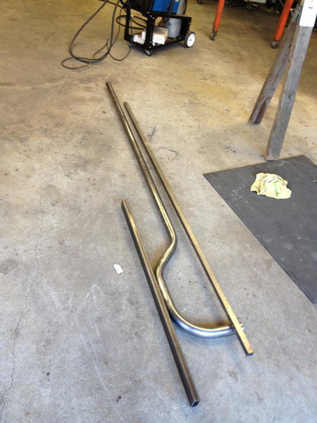

    done on the JD2, then modified a bunch on the bench grinder because we got the angle slightly off.

    Steve whatcha makin?

    School project. It's for Mini Baja SAE.

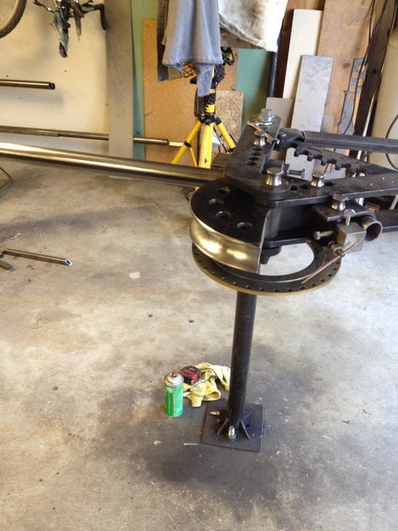

    Sliders getting bent
