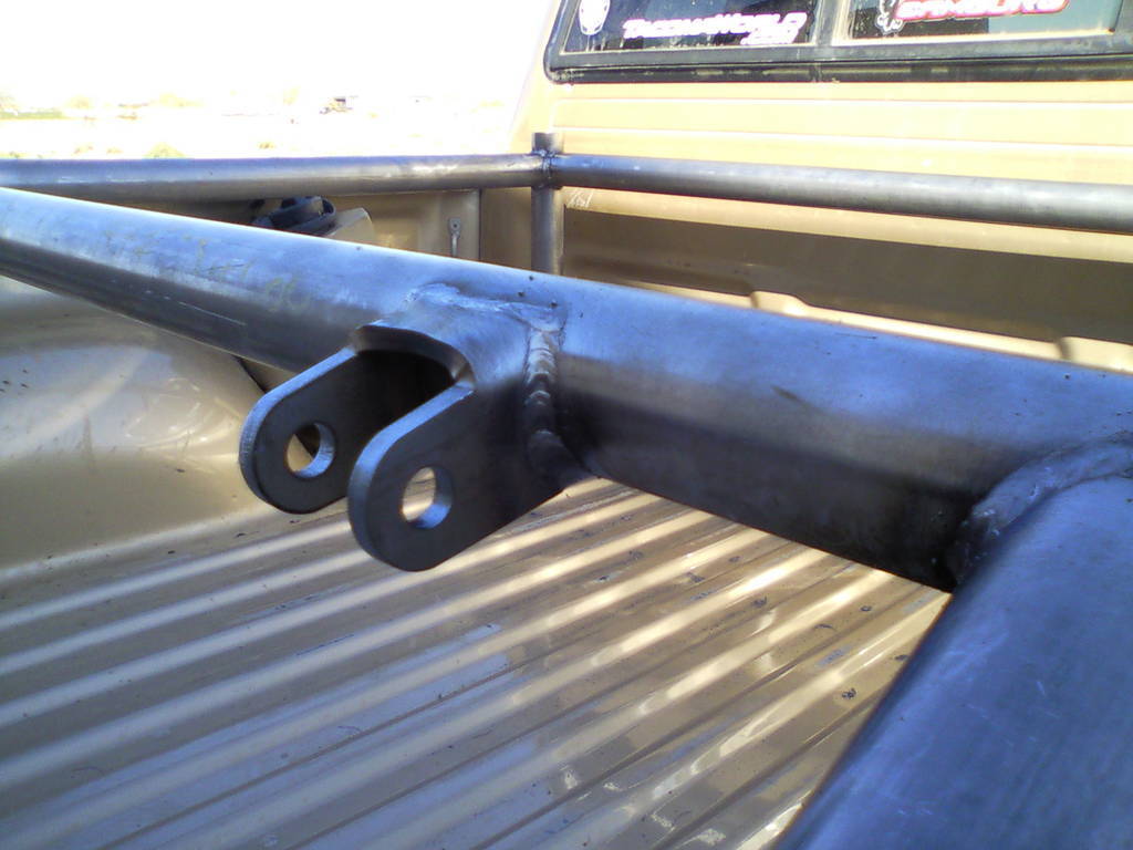

    my welds are getting better :)

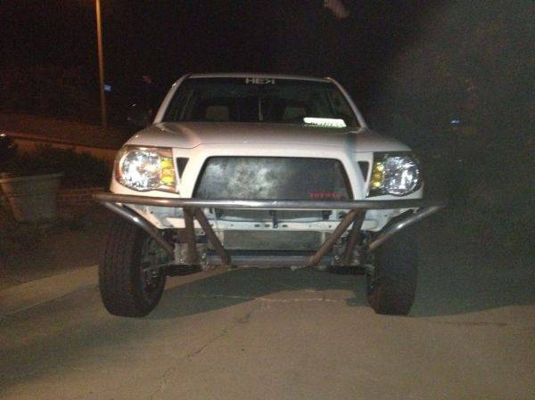

    and heres the bumper i did today(and last night)

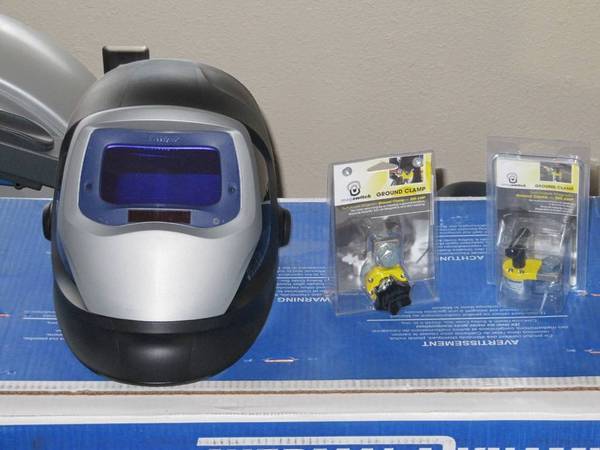

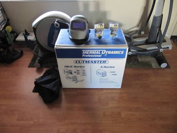

    Here is a couple things I just got today from CYBERWELD. Good prices and awesome equipment. Already used the Hood at work and LOVE IT! Will get the PLasma hooked up this wknd.

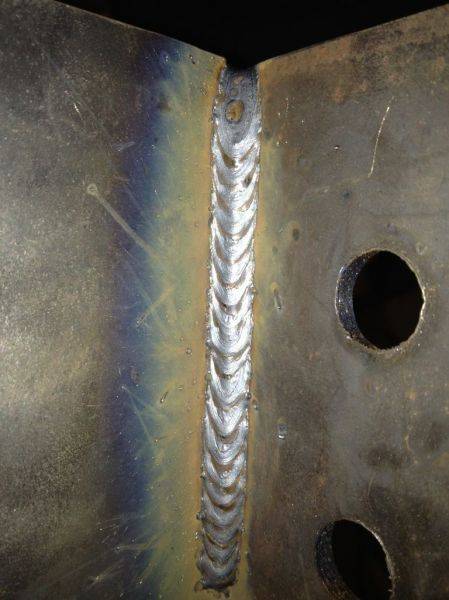

    what do you guys think? any advice for my welding, i think my welds look rather sloppy. what am i doing wrong?

    Kinda hard to tell in the picture since its kinda dark. Are you doing "C" or Circles?
    Here is how I set my machine up. I usually set my machine up with slightly lower setting then what is recommended for the thickness of material. I have found all factory setting to be too high for me. I'm not in a race when welding I like to take my time and go at my own pace. Try doing circles. How I do it depending on moving left to right or right to left. But if I'm moving right to left I like to do clockwise circles. My circles are not like true circles more like ovals. I go from the top plate to the bottom plate moving to the left some creating about an 1/8" pocket then swoop back into it that pocket filling it in with weld. I have found that gives me almost perfect dimes.

    Looks like a fair amount of splatter. Are you using flux core wire or shielding gas?
