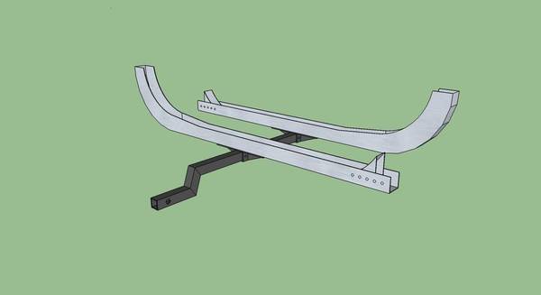

    And these are my next projects
    Mountain Bike Rack (Racks are adjustable, made of aluminum, hitch and frame is steel)
