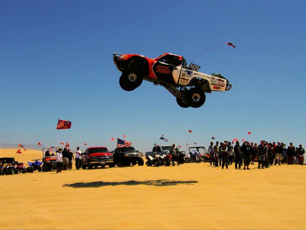

    2,589
    Landon
    Fallbrook
    For reference this truck was built 100% with a miller 175 and has seen more racing than most other 1400 trucks combined
