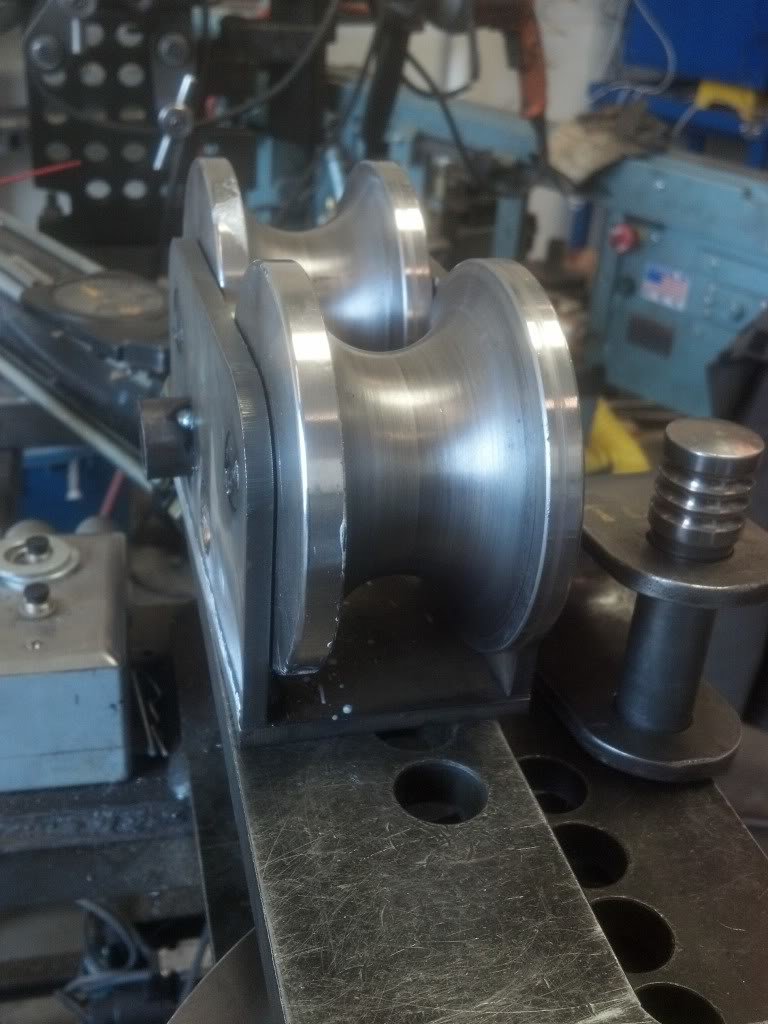

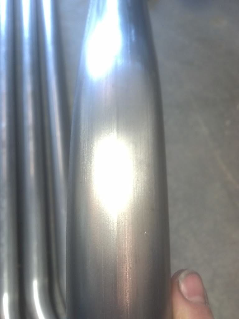

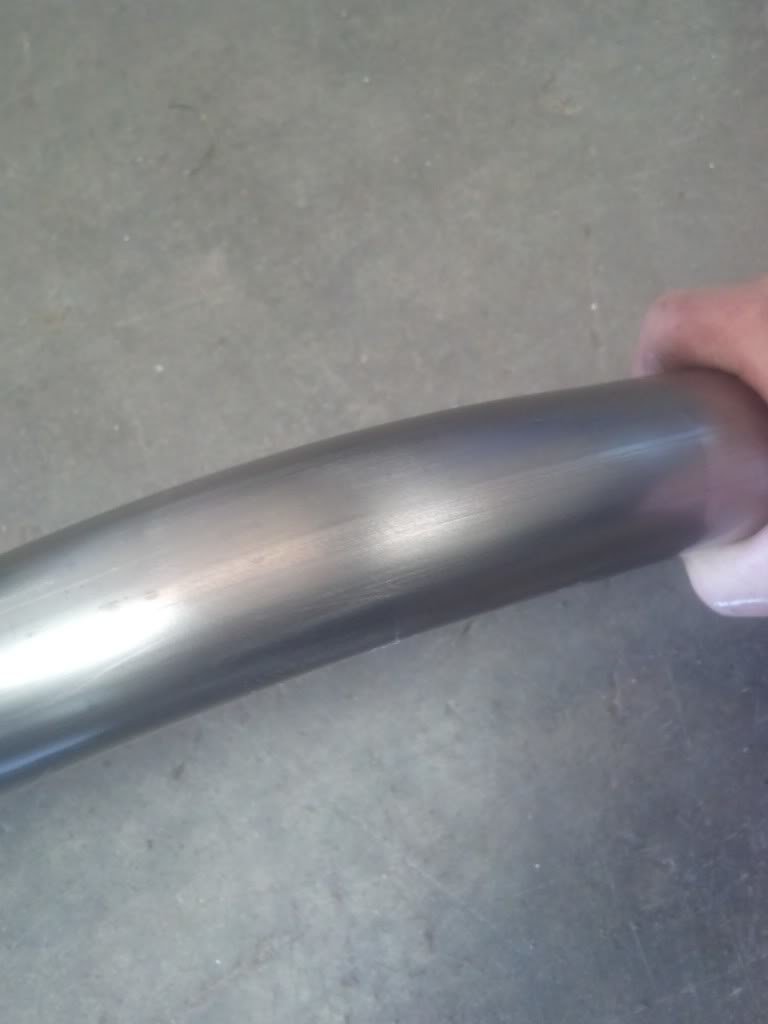

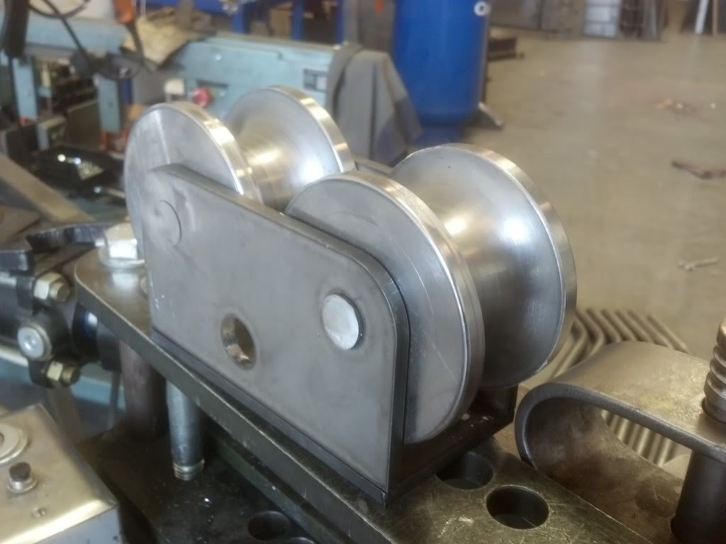

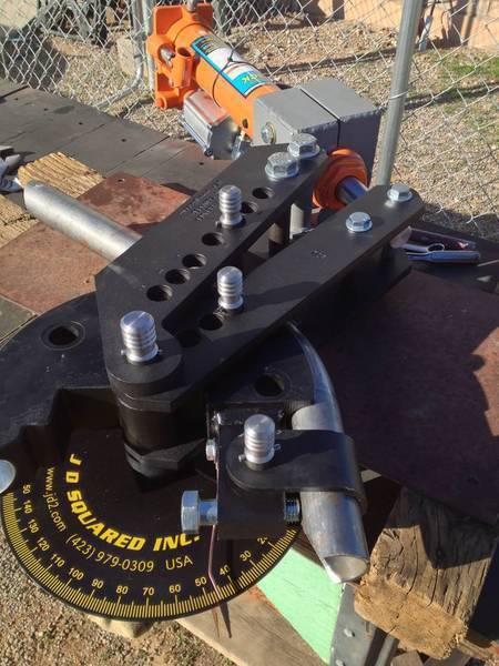

    Everyone that has a draw type tubing benders knows all about mild steel galling when it bends. I fucking hate it! we strive to produce clean bends and have done everything to try to prevent the tube galling up. Every type of lube out there and over time it starts to gall again. i have found a few lubes that work for a wile but not long enough for my taste. I polish the follow block about every 15 to 20 bends and i got sick of it.
    So I've been doing a little thinking and came up with this.
    It's 1/4" plate wrapped around the 1.75" SWAG roller dies. I've seen that some of the higher end benders have this type of follow so i thought I'd give it a try and I'm glad i did.
    Gall free bends with no lube

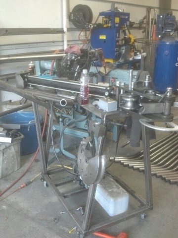

    I forgot to add that my bender is full Hydro you guys still bending manual or with a air over hydro might not have a galling issue "I didn't when it was manual" now I'm doing 90 degree bends in about 8 to 10 sec so the tube gets warm.

    It's not really a baller bender it's just a JMR manual converted to electric hydro it's looks like frankenstein but works like a champ!
