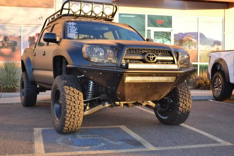

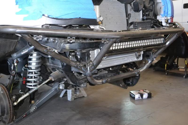

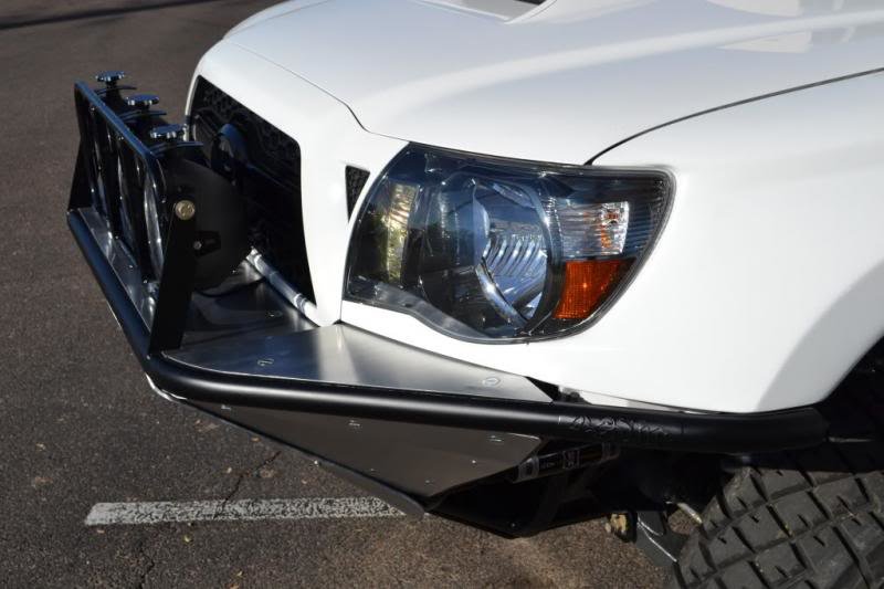

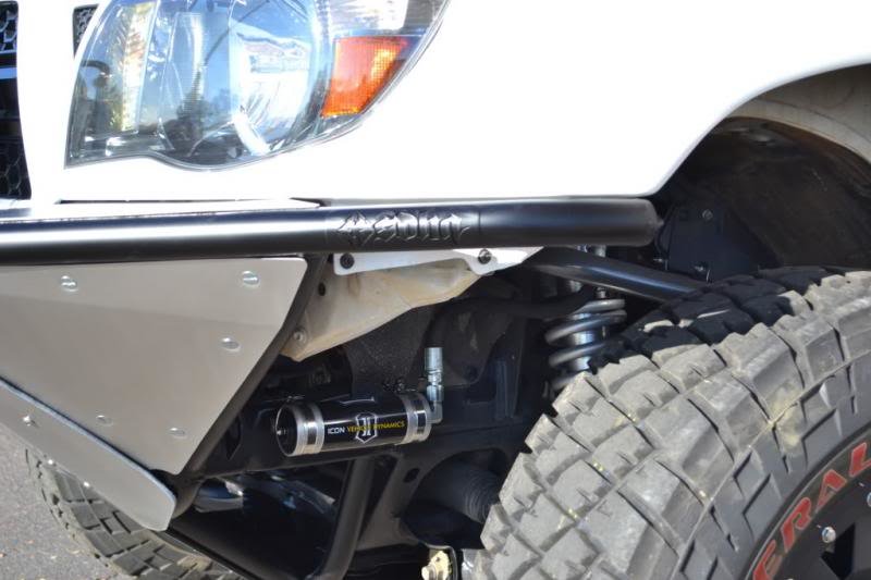

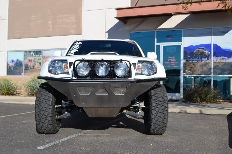

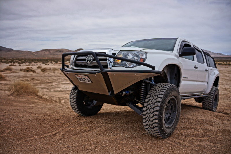

    So I finally pulled the trigger and saved up enough money to get a custom tube hybrid bumper made. I went to a local off-road fabricating shop with an idea of the bumper; here is what I took them:
    I asked for aluminum plating about as thick as the SDHQ bumpers. I also said that I wanted the tubing powder coated but since it would most likely be welded onto the frame, they would tack weld it on and once it was completed remove it so I could take it to B.A.M.F. to get powder coated and then have them weld it back on. Since one of the pictures didn't have the skid going all the way under into a belly skid I think they were quoting me without it. They quoted me $1600 for the whole thing done in 2 days. Does that sound decent? How much would the materials cost for something like that?

    1600 sounds like you went to sdhq lol not sure about alum but in tubing (dom) about 70 mabey 140 if they cant do it out of one stick

    Your not taking into account the fabricators time nor consumables etc etc. your going to a shop and getting a shop price. Garage rabbets have less overhead so it tends to be a bit cheaper. In most cases, shops pay their fabricators due to their talent. Most garage rabbets don't have that. However, now adays there is some crazy good garage fab work coming out so if your looking to save coin I would suggest that route.

    Paden's bumper is 4130 and 1/4" Alum. I'm not sure on 4130 but I know last time I looked into a sheet of 1/4 alum it was around 400 for a sheet if I remember correctly. Granted you don't need the whole thing for a bumper.

    This. Building custom bumpers is extremely time consuming. It took me about 60+ hours to build my tube bumpers. And most shops charge about $100/hr or more
