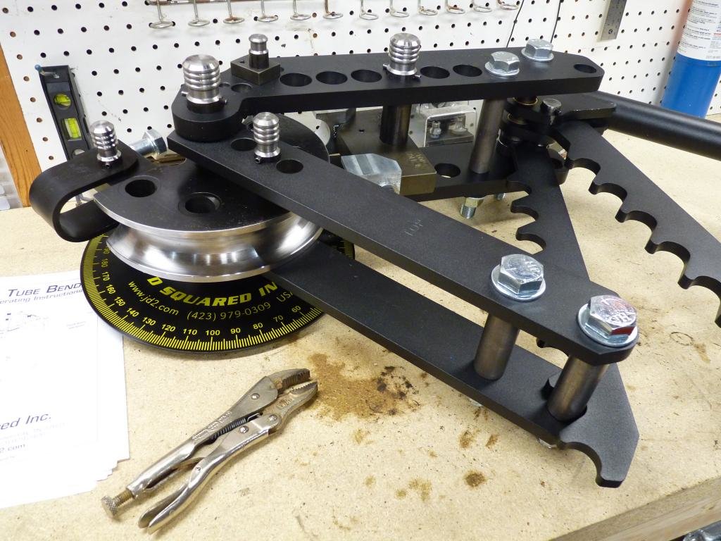

    Holy hell this thing is a beast:eek:
    Anyone have tips/suggestions on mounting this thing?

    we have a 3/8" thick steel work table in our shop that we have it bolted directly to. Works really nice. I would build some sort of stand for it if I were you.

    +1
    Wheeled stand with spots for the dies & whatnot.

    If you don't mind me asking, how much did that set you back ?

    LMK and I can bring it whenever I'm visiting
    Looks like I still have enough scrap 1/4" wall square tubing from building my bumper that I could use. Hoping I can make a stand that I can take down and store if I need to. I don't want to bolt it to the floor if I don't have to.:eek:
    $736 OTD including the 1.66" pipe die

    If you convert it to hydro, you won't have to. If you can't, you'll need to secure it to something and wheel locks probably don't count for much ;)
    You can always take the bolts out and move it around too.

    I converted my JD2 to hydraulic for about $180 from the stuff from Swag off road and a harbor freight jack. It is well worth it
    45acp, is yours a model 32?

    so you'll be here in a week right?? :p
    and just make the base wide enough. Should be able to make one that bolts together.
    fucker is expensive :eek:

    I lost track thousands of dollars ago.
    Did it just include the pipe die or did you order that :confused:

    X2 that's a weird size to get.

    I ordered it, as I was hoping to use 1.66"OD .14" wall A-500 ERW pipe as a substitute to DOM tube because of the price. If DOM is a must over the A-500 for a roll cage, I can get another die for that and the 1.66" should be more than enough for tubing the back end.
    It's a model 32. I may hydro it at some point, but I don't have a compressor yet.

    I would not use anything with the word pipe for a roll cage over your head. Almost all sanctioning bodies of racing require either DOM or Chromoly tubing for specific reasons. You may not be racing and maybe doing an exo (?) but I still wouldn't even use HREW tubing for a roll cage

    If you're not getting it tagged it can be designed just as strong with structural pipe as with dom. Period. Proper engineering sometimes requires designing around whats on hand and whats available. Codes are followed where applicable.
    Not getting tagged or racing=no governing body or "code" to follow.
