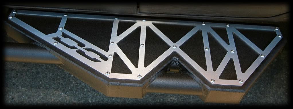

    Mine are 1.75" - 0.120" wall square.
    I think they look pretty good. :notsure: Haters gonna hate I guess.
    I have 4 attachment points welded to 1/4" scab plates and gussets on top.
