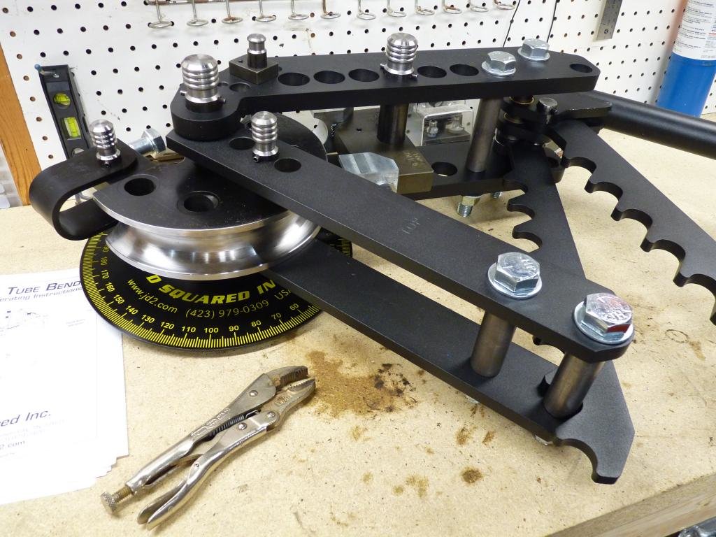

    My issues are
    -only have 1/34 tube die
    -can't get tube locally
    When i built it i did bend the heaviest tube i could find in the scrap pile 1.75x 1/4is wall and it was nice and smooth.
    it is one seriously nice hunk of steel. Beefy as hell and everything is smooth as butter

    Why on earth would you put a bend in a tie rod????
    I also use a JD2 model 3. converted it to air over hydro, not a single complaint.

    That's a die not used too much for most people. If you can't find one toss them in a flat rate box with a return label and I'll bend them real quick.

    I have just earlier noticed that. I thought when I first looked at it on the JD2 website that it was a complete kit at $395. So now if I am looking at bending 1.5" tubing I will be in it for about $650 to $700. That is a lot more than I planned to spend on a hobby tool. Grrr... DAMN YOU BLACKDAWG! :D So does anyone have a used Model 3 or model 32 with a a 1.5" die? Mater of fact, before I even look at dies, I should figure the steel I will be bending.
    I am looking at building my own sliders, and then a custom bed rack for a RTT and other things. Should I go with 1.5" or 1.25"? What wall thickness?
    DAMN IT.... I am SO gonna hate you after all this BlackDawg.....lmfao..

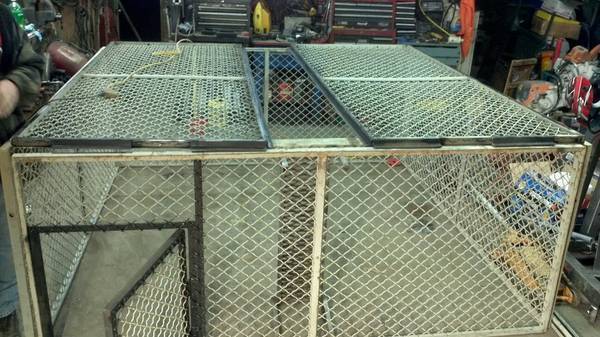

    how do you guys like the dog cage i built a few years ago, its just standing in this picture since i built it in iowa and transported it in 7 panels to kansas.
    the whole thing was welded together in hansas and the center in the top was a slide out panel to clean etc

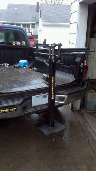

    here is my JD 32, i made a mount for my truck because at the time i was renting and could not bolt it to the floor
