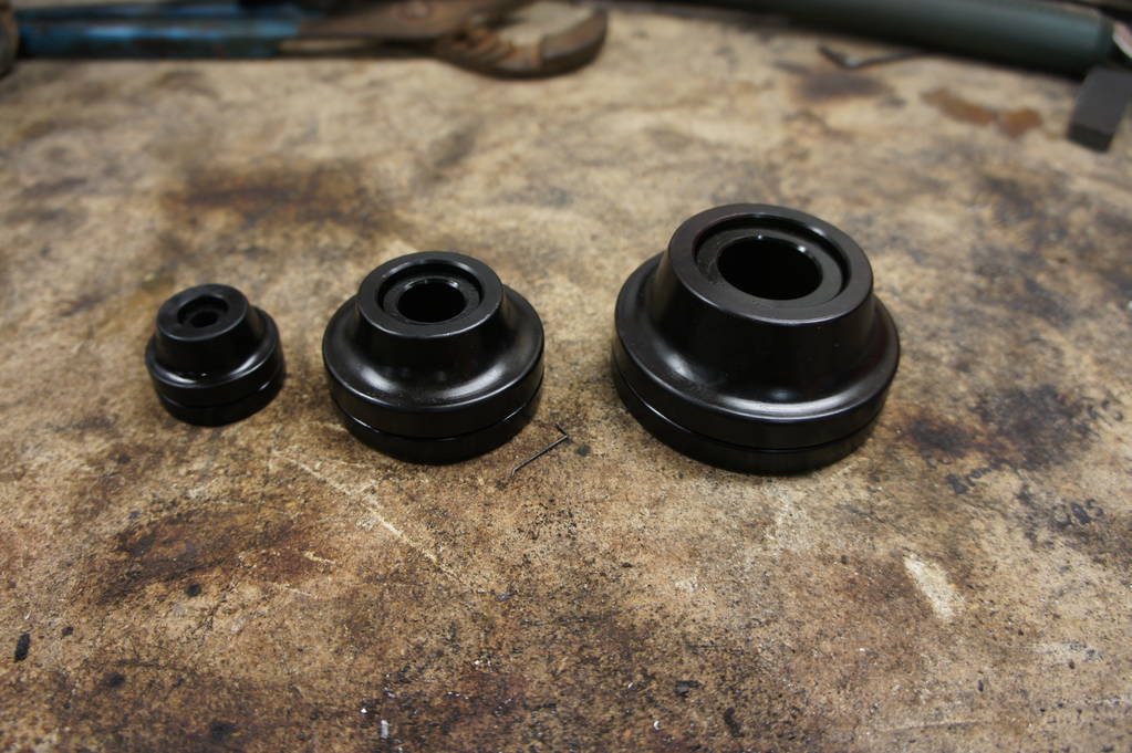

    Got my first dimple dies from TMR today. Probably gonna buy a couple more. 1/2", 1", and 1 1/2"

    Are they offering bolt-on dies now as well?

    I don't think they offer any kits or anything but throw a bolt in there and I guess you're good to go.

    I would add a thrust bearing to the mix as well. Mine are from Barbed wire offroad, but he is small time anymore. Awesome dies though!

    Should the bearings be used on both sides?

    Just the side you are turning. Typically and should usually be the nut side. The idea is to eliminate the friction between what you are turning and the face of the die it is riding against.
