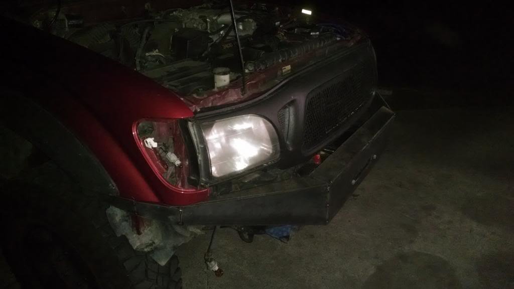

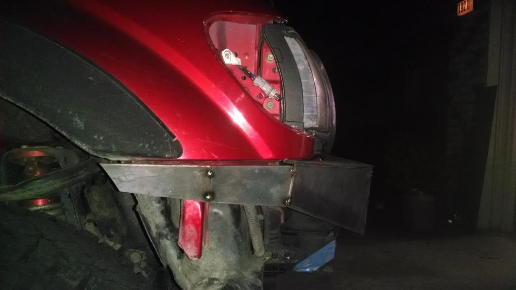

    Started cutting for my bumper.

    I'm gonna watch this Tacoma bumper build closely. I have to build one for my '04.
    Any pics of the backside? I would like to see how the bracing mates up with the frame horns.

    Right now I have nothing on the backside, I built up the front of the frame and mounted a winch plate, you can see the frame sticking out below the bumper. Some of it with be cut off to clear the bumper. once I figure out exactly where the bumper is going to sit I'll be bracing it directly to the new frame ends along with gussets/braces for the fender sides.
    I'll take a pic later of the winch mount, nothing pretty, but strong.

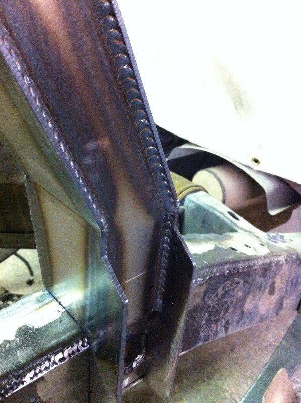

    4th set of sliders this week.. Getting a little redundant, here..
    Have to work on fine tuning a little bit - have some spatter going on in the first pic.
    This was vertical downhill..

    Hmm..
    I push most of the time..
    On a 90 joint, I'll start my arc in the apex of the two pieces, then do a cursive "I", keeping an eye on my puddle, making sure it's tying into both upper and lower pieces.. Then bring it back to the apex, pushing ahead a step, then repeating the cursive "I".
    A lot of it is sound, too.. Found that the space between the "crackle" will increase when I make the "I" back into the puddle.
    Sorry it that made no sense, it's just become a second nature tactile thing for me.

    Do you spray the piece then weld through it or clean the weld area first?
