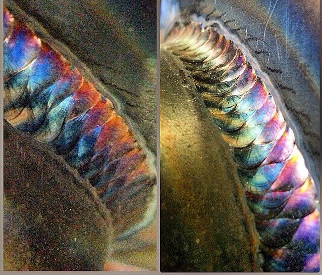

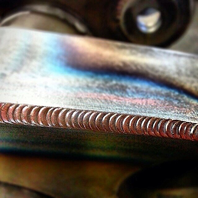

    Here is some pictures of some link mount welds.

    Hmmm .... Link welds .... I've never heard that term before ?
    Although there is different terminology used depending on what part of the country you come from !
    Those bottom pics are TIG welded I believe
    The top one looks like 6010 stick applied by an experienced hand : )
    Nice Welds !!!! Almost as good as mine ! Hahahahahaha !

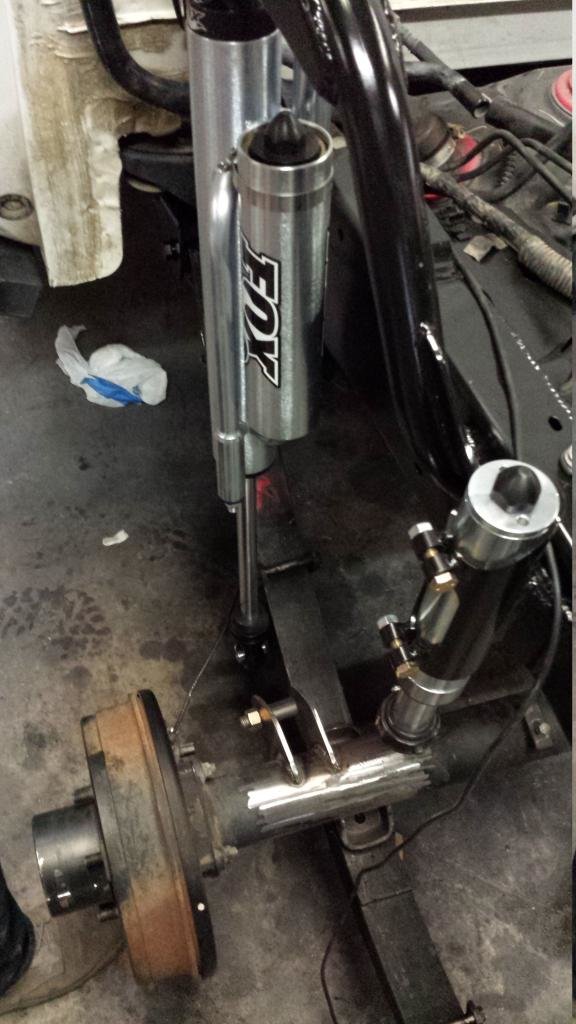

    Looking for some advice on making the strike plates for my bump stops. Orginaly We were going to use spring perches but they were to low and the shock would bottom out before the bump stop would. Would I just want to make the strike plate taller so it bottoms out the bump stop before the shock? The bump stop is about as far down as I would like to have it in the sleeve.
    Edit: The U-bolt goes between the lower shock tabs so whatever the strike plate ends up doing there still has to be room to get the U-bolt through.

    One good hit is going to push that bumpstop up in the can

    If your sliding the bump down an inch or two just sleeve a piece of tube over it.
