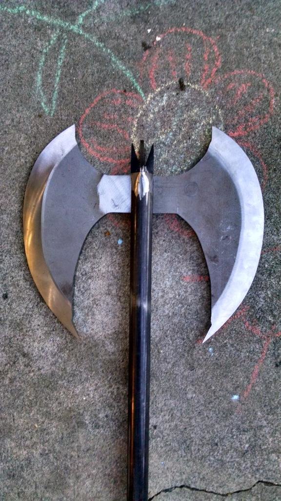

    For Halloween

    That looks pretty bad-ass!
