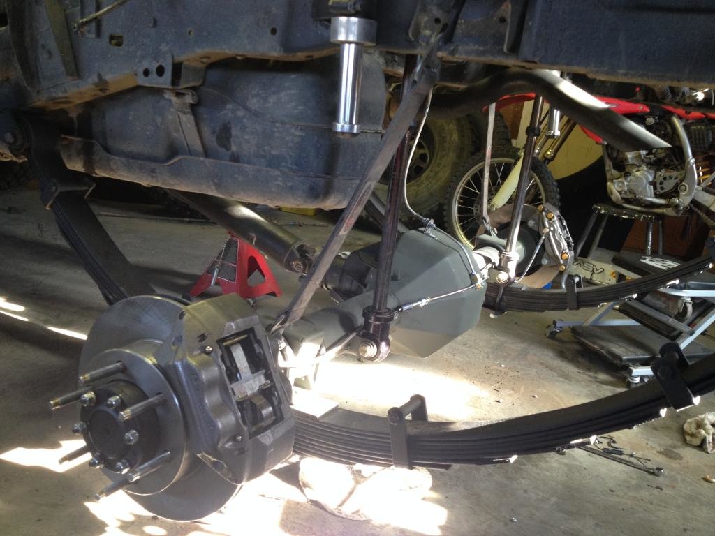

    i got a set of 14in foa because they were two for the price of one. i just today installed allpro expo leafs if i need to cut the cage a little shorter to fit the shocks thats fine. things i dont kno what i will need are what type of shock mounts and the angle at which i need to place the shocks as i see the stock ones are one forward one back. i see some people having the shocks come out between the wheel whales closest to the cab and im keeping the stock gas tank for now so have to keep that in mind im looking to keep it a 4x4 and use it as a slight prerunner.

    i dont want to chop my bed up alot either so im going to remove it then find the location of where the cage should mount. if i could find someone that needs a bed id sell it to them or trade for there damaged bed as i have bedsides im going to install and my bed is in good condition and im going to fill bad cutting it up

    Here is how I have mine set up. Off the rear of the axle to help protect them from rocks, and with the suspension stuffed at full bump they are perfectly vertical. You have to cycle the suspension to know exactly where things will end up. You are kind of doing it backward, but that's ok. Beds are cheap, you could always get one from a junkyard if you are worried about chopping up a nice one. Mounts- http://store.sdhqoffroad.com/synergysuspensionuniversalshockmount-parallelbolt.aspx

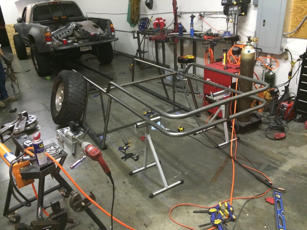

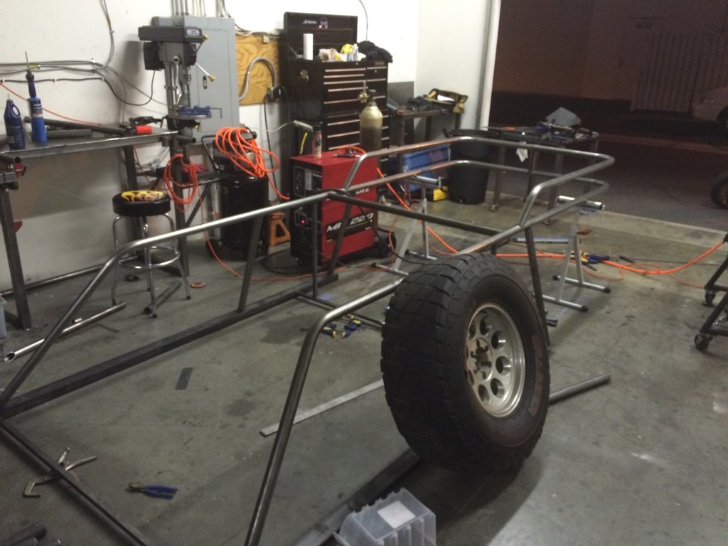

    Caging my tundra
    Took this weekend off from building the cage to build a chase rack for a friend's F350 for the 1000. Should have it done tomorrow

    If there cheap and easy to come by I dont mind cutting it. Ya thats what I heard from a friend after installing them. Is there a way to get it to full bump without the leafs removed. Maybe a tie down between the axle and frame
