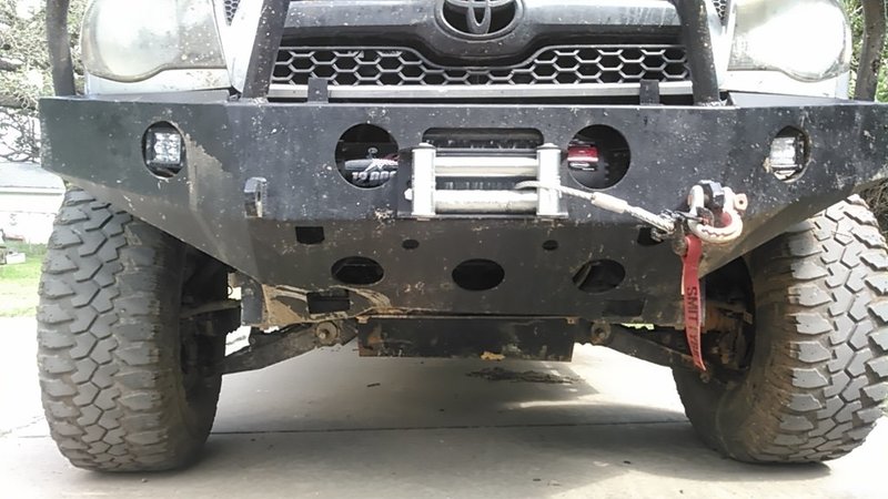

    Did you see I bent one of your bumpers? Lol uploadfromtaptalk1431126049760.jpg
  19. May 8, 2015 at 4:09 PM
    #1639
    RelentlessFab
    RelentlessFab Eric @Relentless Fab Vendor
    Feb 17, 2008
    #4772
    15,812
    Eric
    Sparks, NV
    07 AC 6mt>03 SR5 >08 Sport and 17 6MT TRD OR
    Relentless Armored! Too many others to list.
    Doesnt necessarily surprise me, that lower center area isnt invincible to hitting rocks/stumps/etc
  20. May 8, 2015 at 4:43 PM
    #1640
    weldertaco
    weldertaco Mr.13%bodyfat
    Dec 16, 2014
    #144371
    13,299
    texas
    TrailRunner
    4wd to 2wd conversion
    Lmao yea it took a beating. Had to use the bumper as a ramp to get up a ledge.
