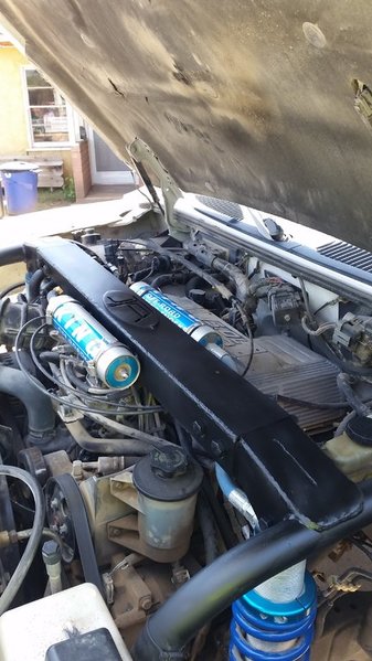

    I have a jd model 32. I built a mount for it that slides in my reciver hitch on the truck. It clears my bed rails and works decent if you are tall enough

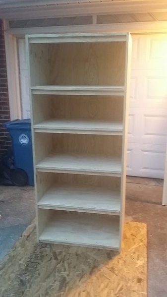

    20150516_201828.jpg Built some shelves for my wife today.

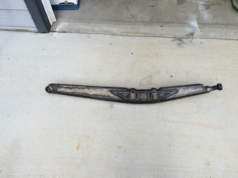

    New crossmember for a members trail rig.
