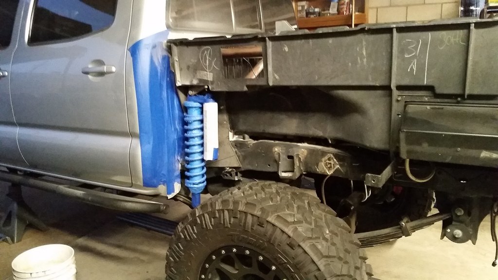

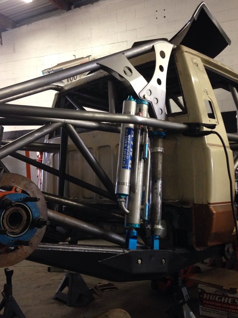

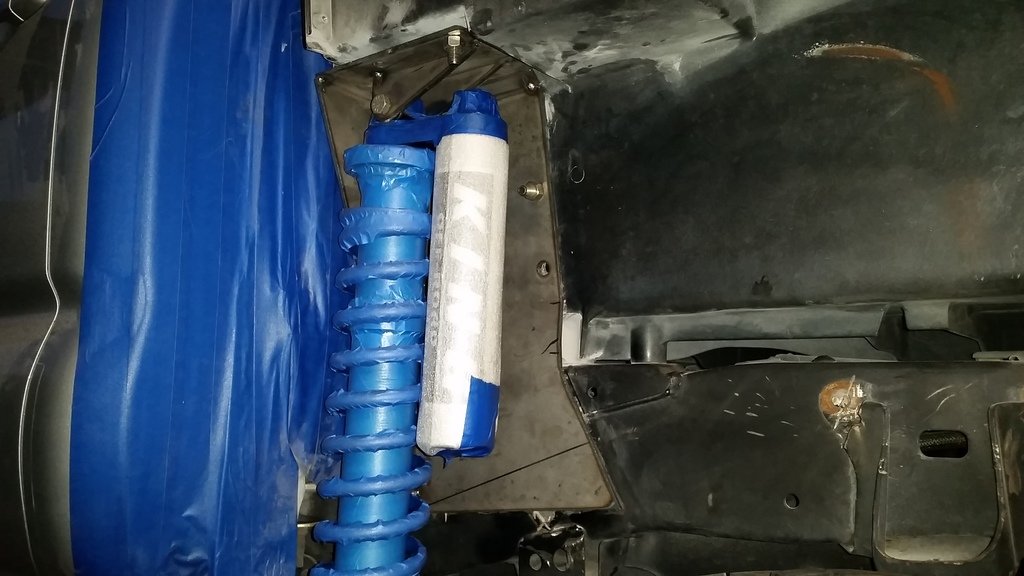

    How much travel? What length coil overs? Looks sick.

    3,958
    san diego
    1996 tacoma 4cyl, 5spd
    12" 2.5 kings. Strapped at 20"
    thekernel114 likes this.

    Just curious right now, but could you pm me a ballpark price for this in a "kit" for a long bed with frame boxing plates?

    20"s completely under the bed is pretty ridiculous. Definitely keep posting as many pictures as possible, Im very interested in how this turns out!

    Just curious what the motion ratio is on the shock to get 20" with a 12" travel shock? How close is the shock pivot to the rear axle? Love the way it looks all under the bed. Just curious because on the one I built with 16's and 18's could get 25" strapped. And I know the one DMCtacoma built uses 16's and 18's too and is strapped at 21" if I remember right.

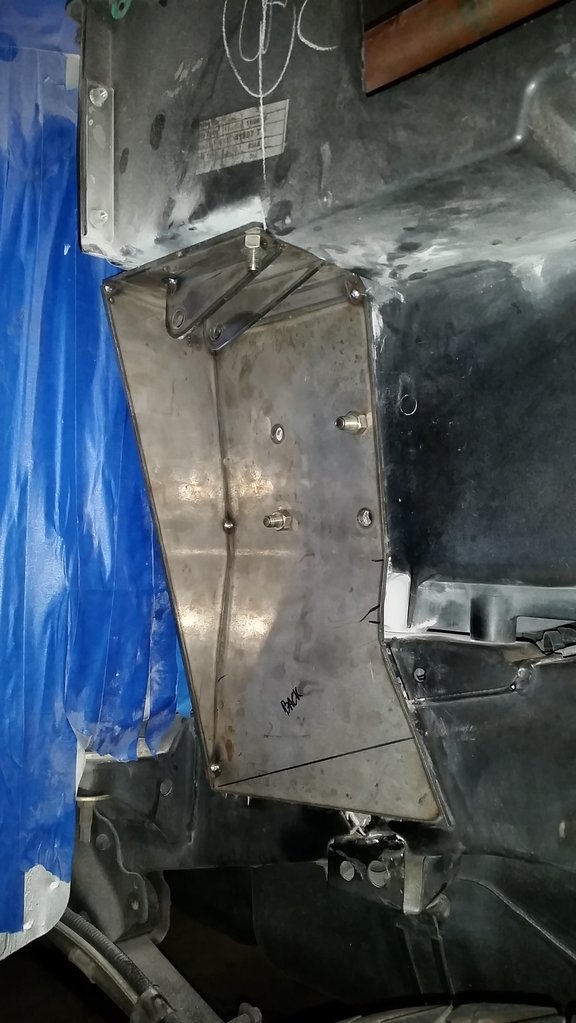

    Retaining stock tank and all that?

    Yes. Upper link goes on passenger side of the diff. Just some exhaust modifications but nothing major

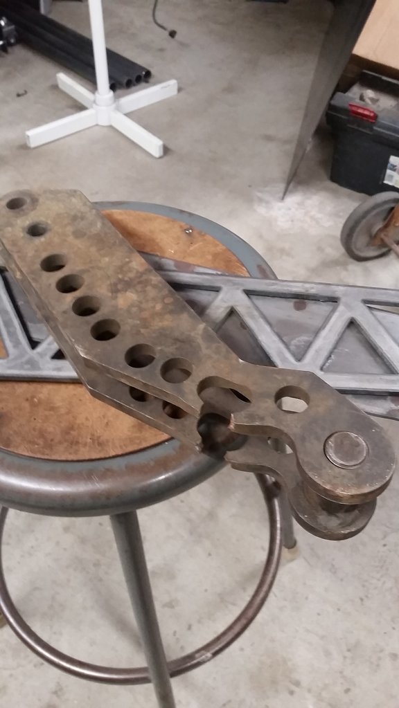

    Does anybody in here know of a used model 3 or model 32 bender for sale?
