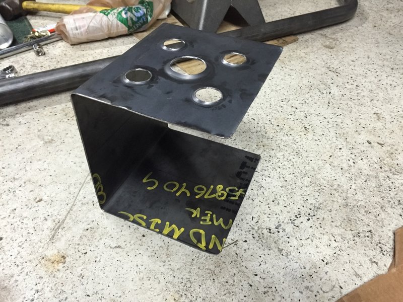

    Needed a cooling "shroud" for some equipment at work so I whipped this up in the garage this evening.
    Need to cut out the other side for a small fan once that gets delivered.

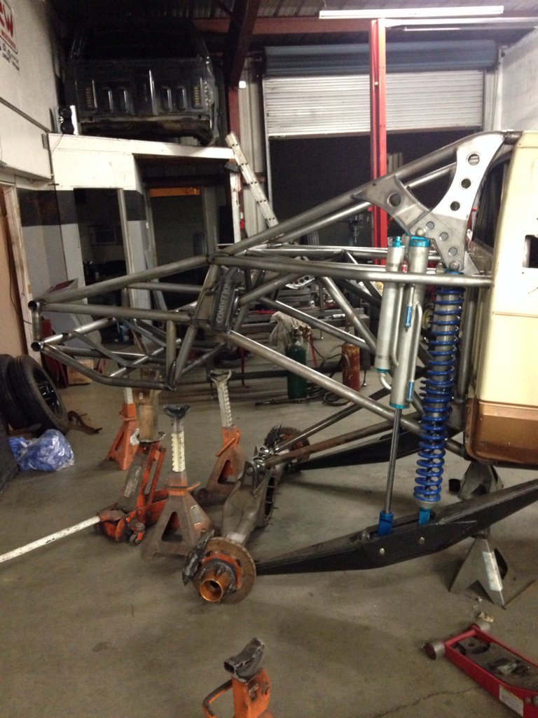

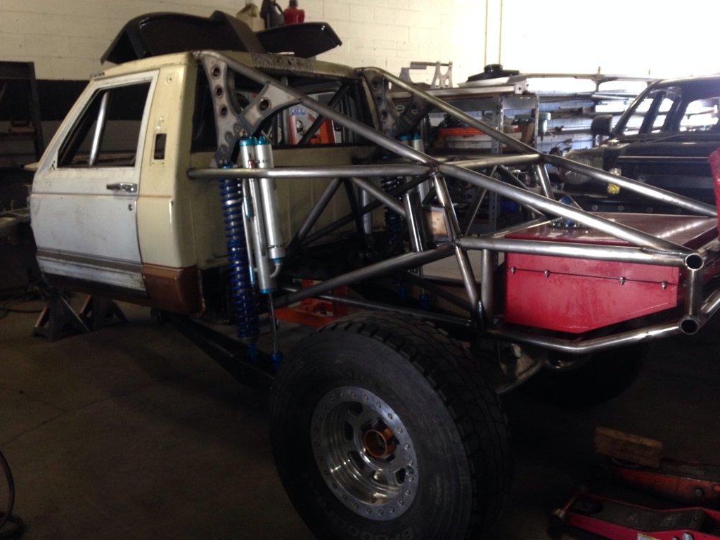

  20. Oct 4, 2015 at 6:20 PM
    #1720
    dirt addiction
    dirt addiction Well-Known Member
    Aug 11, 2014
    #135936
    1,136
    Flagstaff
    Solo motorsports XLT LT, foxshox
    image.jpg image.jpg Weekend project, still need to do lower mount, skid plates and valance tabs. All dom
    Mobtown Offroad and thekernel114 like this.
