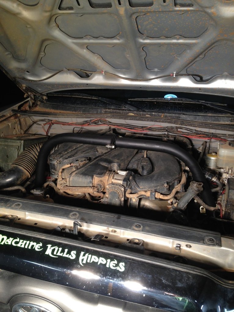

    the easiest way to make a crossbrace....
    since im still waitin for parts n springs to show up, ive had some time to revise my crossbrace( the other one flexed and rubbed my airfilter box) soo, I made this one and it is Solid,...1.75 DOM, made the delrin bushings for it too.

    What did you use or how did you bent the tubing so cleanly?

    wait, is it solid or DOM?

    It's 1.75" .120 wall DOM, not solid stock.

    lol ok, so just normal tube. got it :D and to that other guy, you just bend it in a bender. super simple

    To his defense, bending 1.75" solid stock would require a tank...or superman.

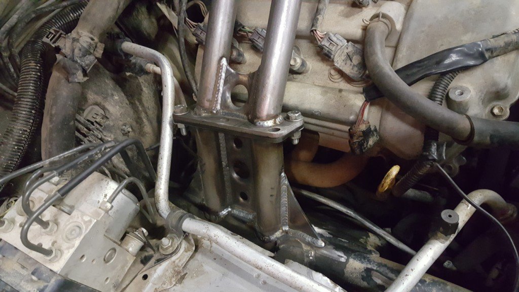

    You might end up sheering that center section. I replaced one for a customer last month that completely tore off. This one should hold up fine now lol

    I see what your sayin, I think when I put my secondary hoops in I'll run another crossover and tie the two together, I just want to keep it easy enough to remove when I got to change an engine

    if you replace your current connection with one of theses, you can keep what you have, and not have to worry about shearing bolts

    Yea I have a few of those actually lol, might have to change it if I start seeing the bolts take a shit
